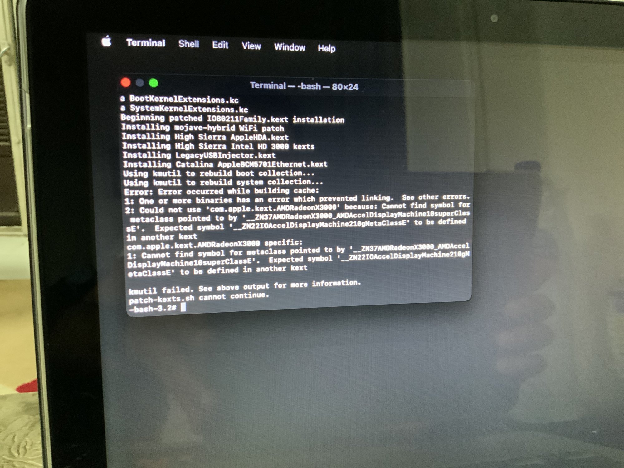

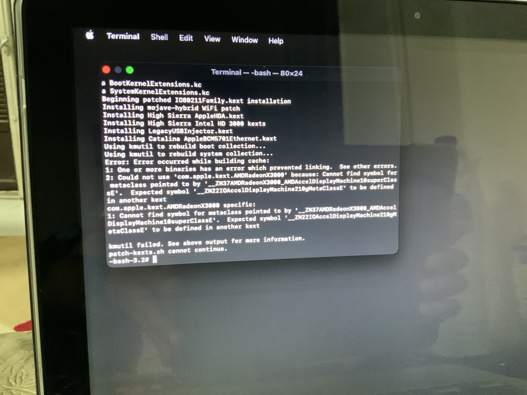

Look at @eminemmm's previous posts. It's a 13" 2011 MacBook Pro. It's HD 3000 only. It's not a dual GPU machine.
Somehow it's having trouble removing the kexts that are left over from the dosdude Catalina patcher's Legacy GPU Patch, and that's why kmutil is failing.
@eminemmm I have another set of instructions to try. I'm having trouble figuring out how my previous instructions would not have worked, but try this before I suggest anything more drastic.
First, make sure you've done a Time Machine backup, as I've mentioned in a few previous posts.
Next, try doing the following:
Boot from the patched installer USB. Open Terminal. Then run the following commands:
Code:
cd /Volumes
mount -uw "Volume Name" (such as "MY KINGSTON SSD" or "Macintosh HD" or whatever your Big Sur volume is)
cd "Volume Name"
cd System/Library
rm -rf Extensions
rm -rf Extensions.old
Then quit Terminal, start the Installer, and reinstall Big Sur. See if you're able to make WiFi and Ethernet work afterward.
After doing those commands and installing Big Sur , will I try again to apply patch.kexts from USB ?

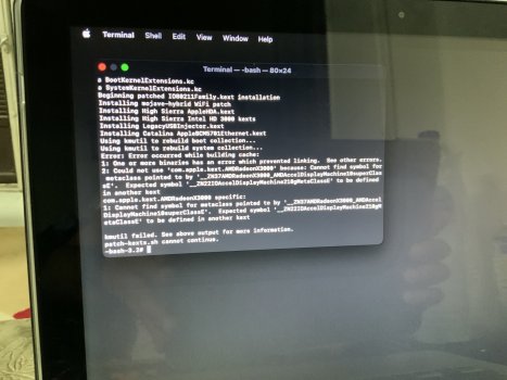

I tried your commands but ended with same error I guess.

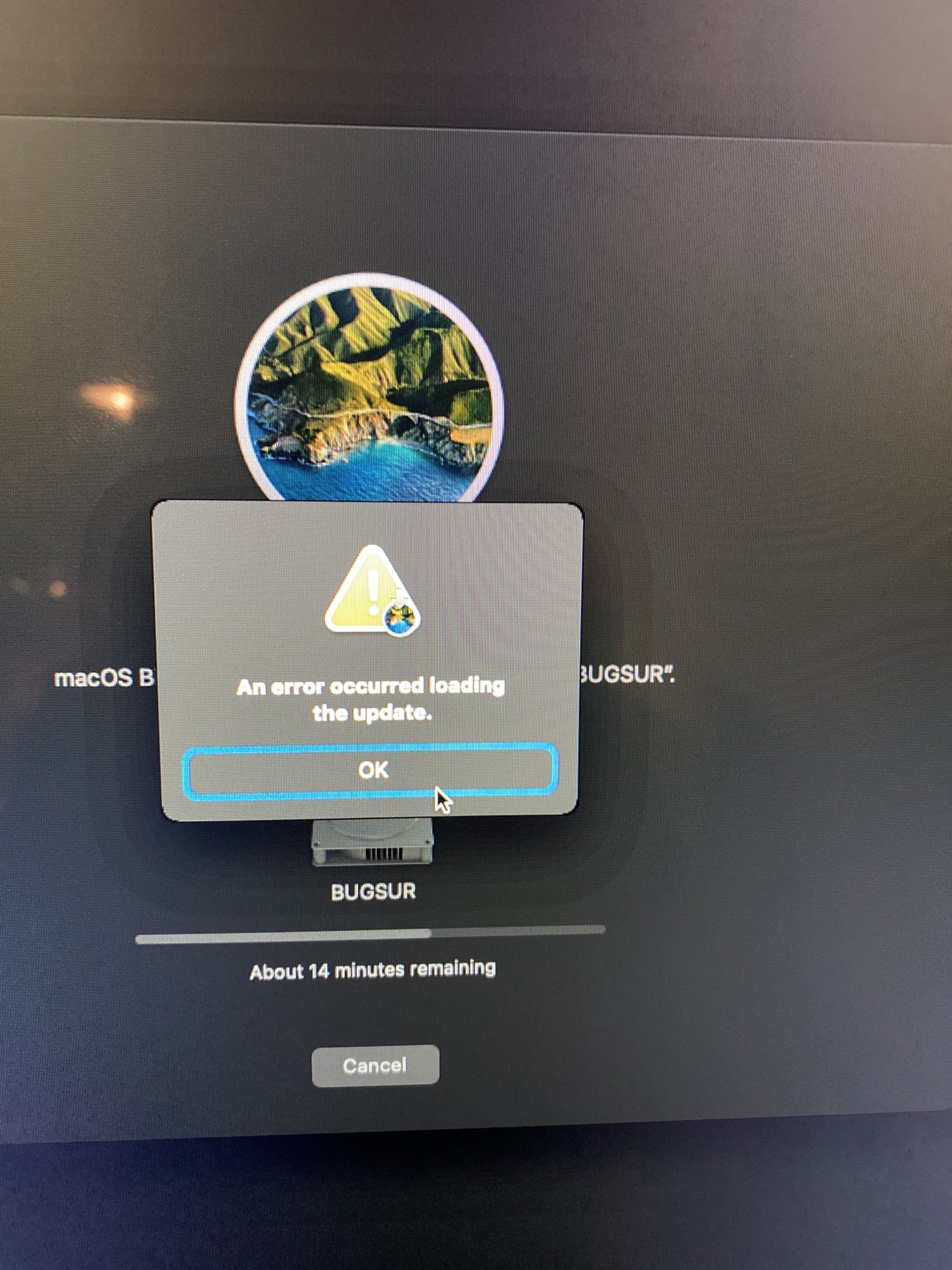

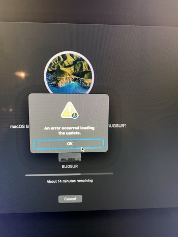

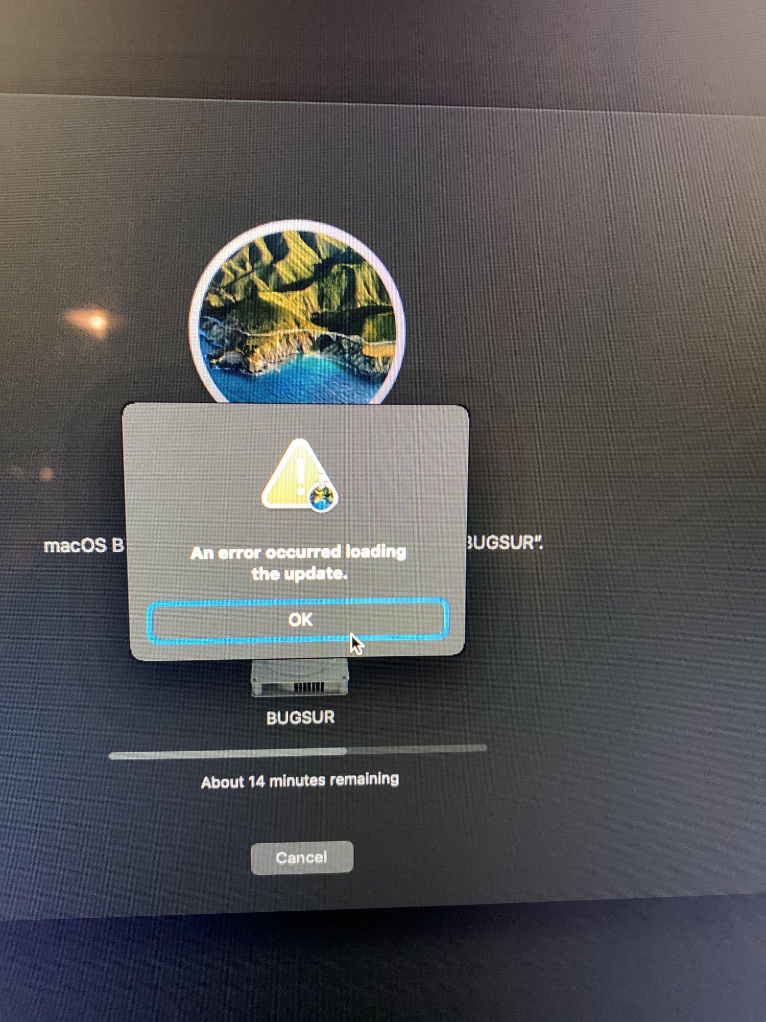

Hello, what is that? Can't install Big Sur with the micropatcher 0.4.4. iMac at the end of 2012.
To properly troubleshoot it, I will need to see the installer log. (I guess I should add instructions to the README about how to save the installer log.)
The quick-and-dirty approach is to just try again with a different USB stick. If a different stick works, then your first stick is broken.
Reactions: iMac-iPad
This is the same usb stick with which I already patched the iMac 9.1 of 2009. The mistake is new to me.

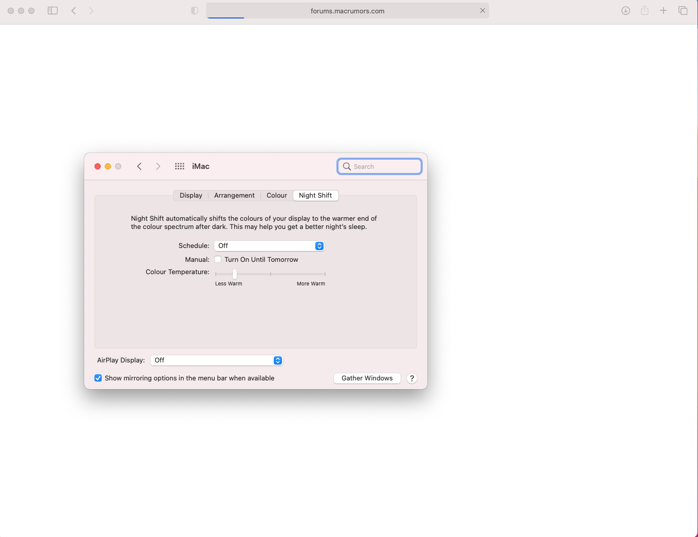

At the very end I had to reinstall the Big Sur Beta 10 over this existing installation - this solved this particular Safari problem.
Bright side of all this: I could check the latest micro patcher 0.4.4 with some enhancements I made for the iMac12,x family (but still no H.264 HD3000 iGPU).
EDIT:

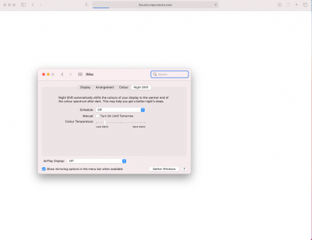

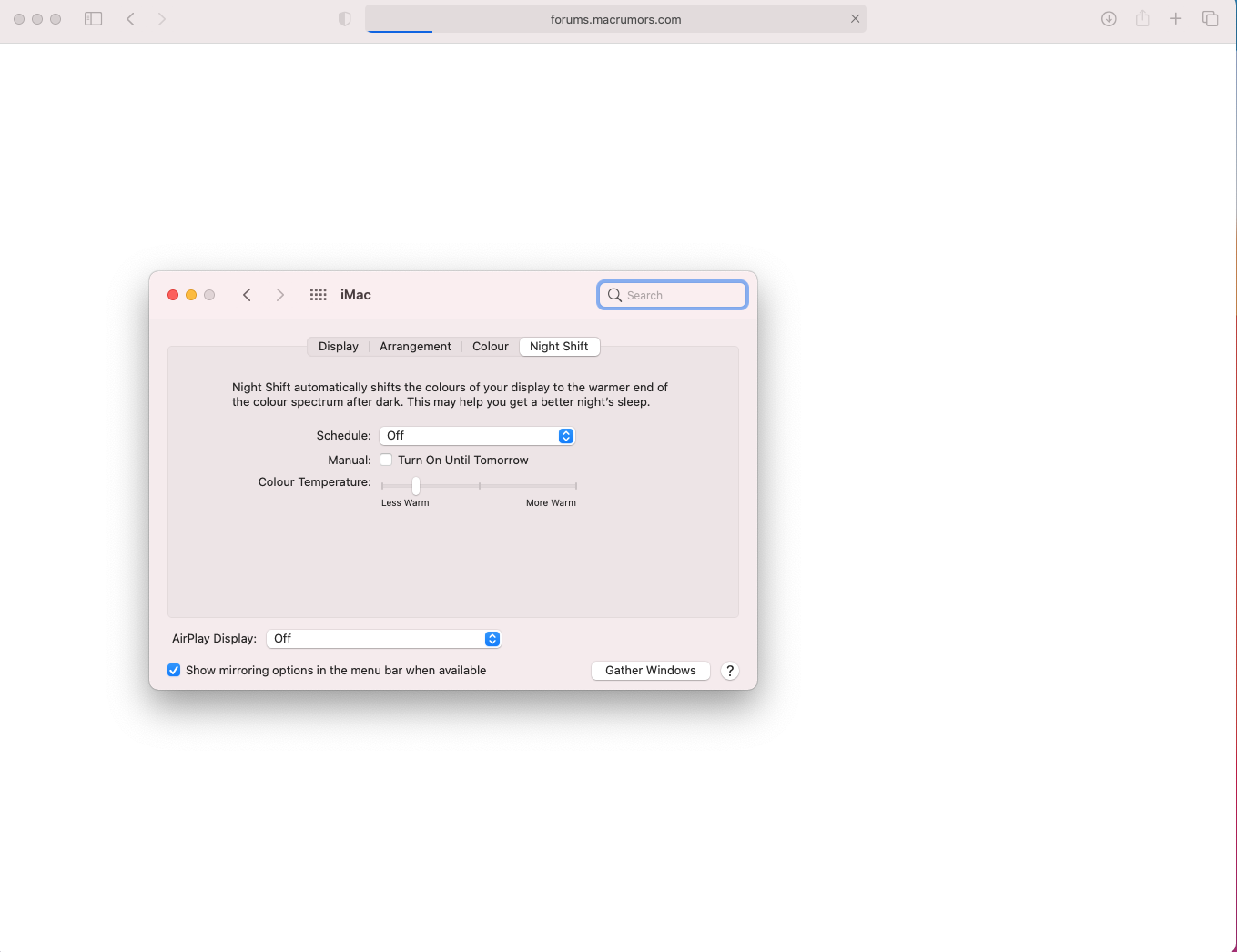

Installing the 19H2 patched CoreBrightness.framework breaks Safari on my iMac. While the NightShift is working nicely with the Framework installed I cannot use the Safari to browse any longer :) This is a really nice one.
This machine is using the iMacPro1,1 ID....
