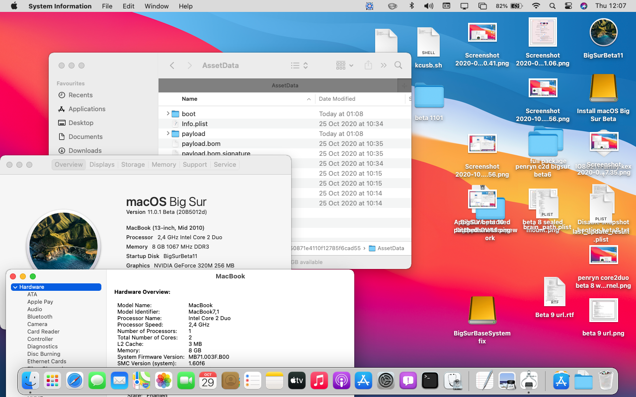

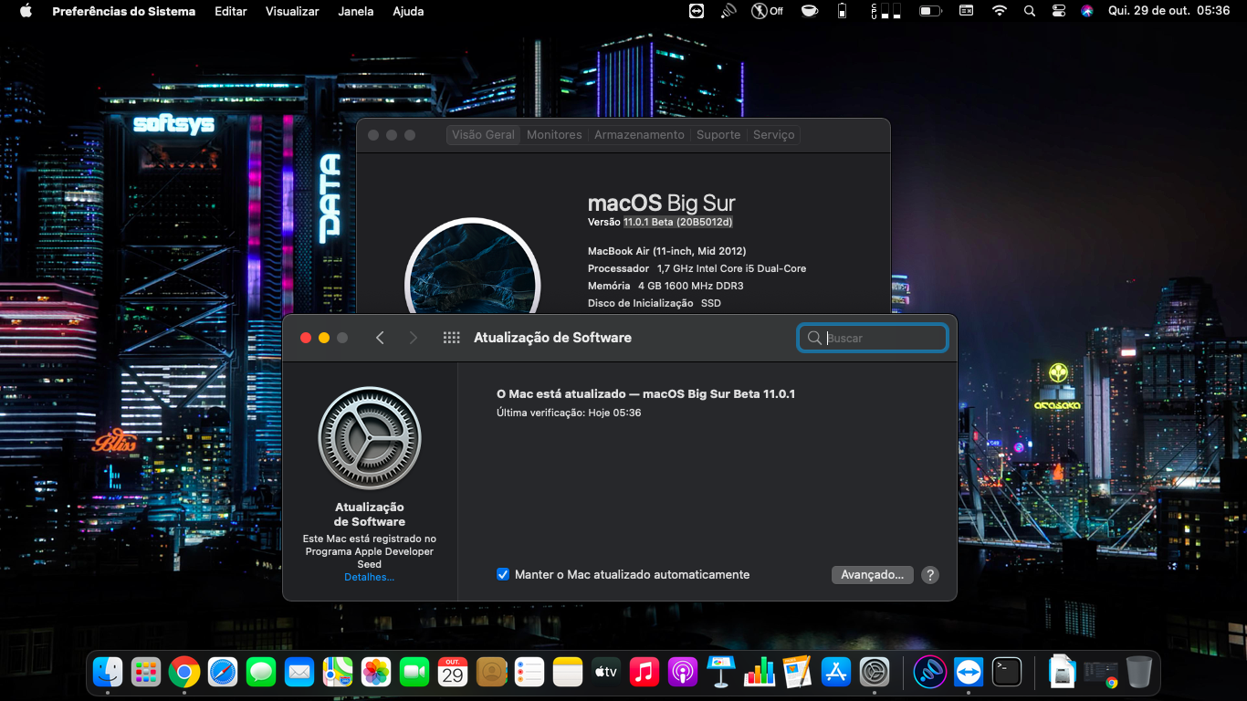

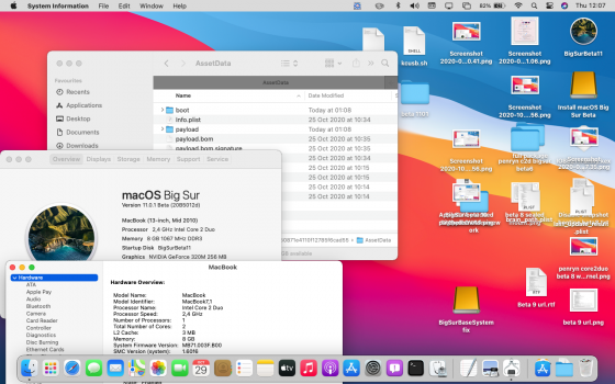

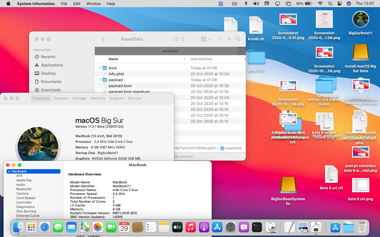

11.0.1 Beta (20B5012d) . This is a GM candidate for non-Silicon macs, how do I deduce this? Well, they fixed the bug in the Recovery languages and also if you change the wallpaper and have a password to start, you will see that now it keeps the wallpaper on the welcome screen at login.

About BigSur 11.0.1 all newer core binaries have been compiled by apple on 25 October , Penryn Core2Duo can still boot the updated kernel 20.1.0 , but I noticed that apple changed the boot.efi stock size now is 724 KB (maybe they added some additional ARM64 code) while previous one was 642 KB (even if @ASentientBot often rightly wrote that a previous patched Catalina 0xfff boot.efi can still boot a BigSur environment).

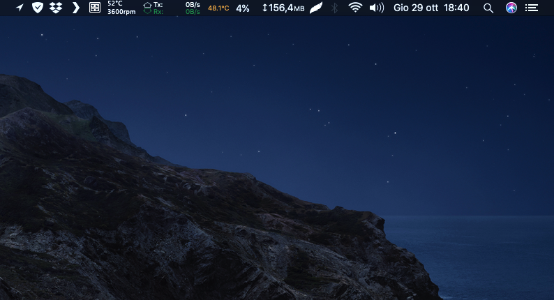

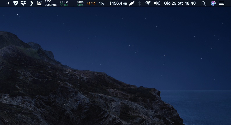

Big Sur is only an exercise on Core 2 Duo Pernyn. Catalina 10.15.7 does surprising well on my Mac mini 2010, I have only to use some tricks to lower my "default" CPU usage from 30% at boot to 4%, to get all the power 🙂
