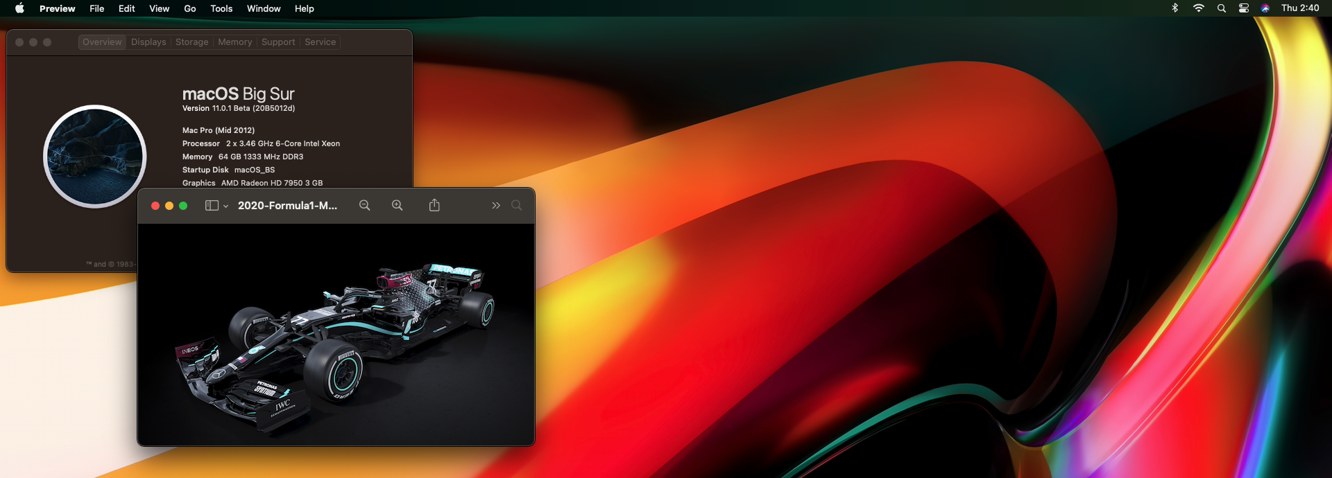

cMP Mid 2012 Big Sur 11.0.1 Beta1 updated with Barry's micropatcher-dev-v0.5.0 without any issue.
As usual as Recovery terminal command:
/Volumes/Image\ Volume/set-vars.sh
Big thanks to Barry and others created the micropatcher.

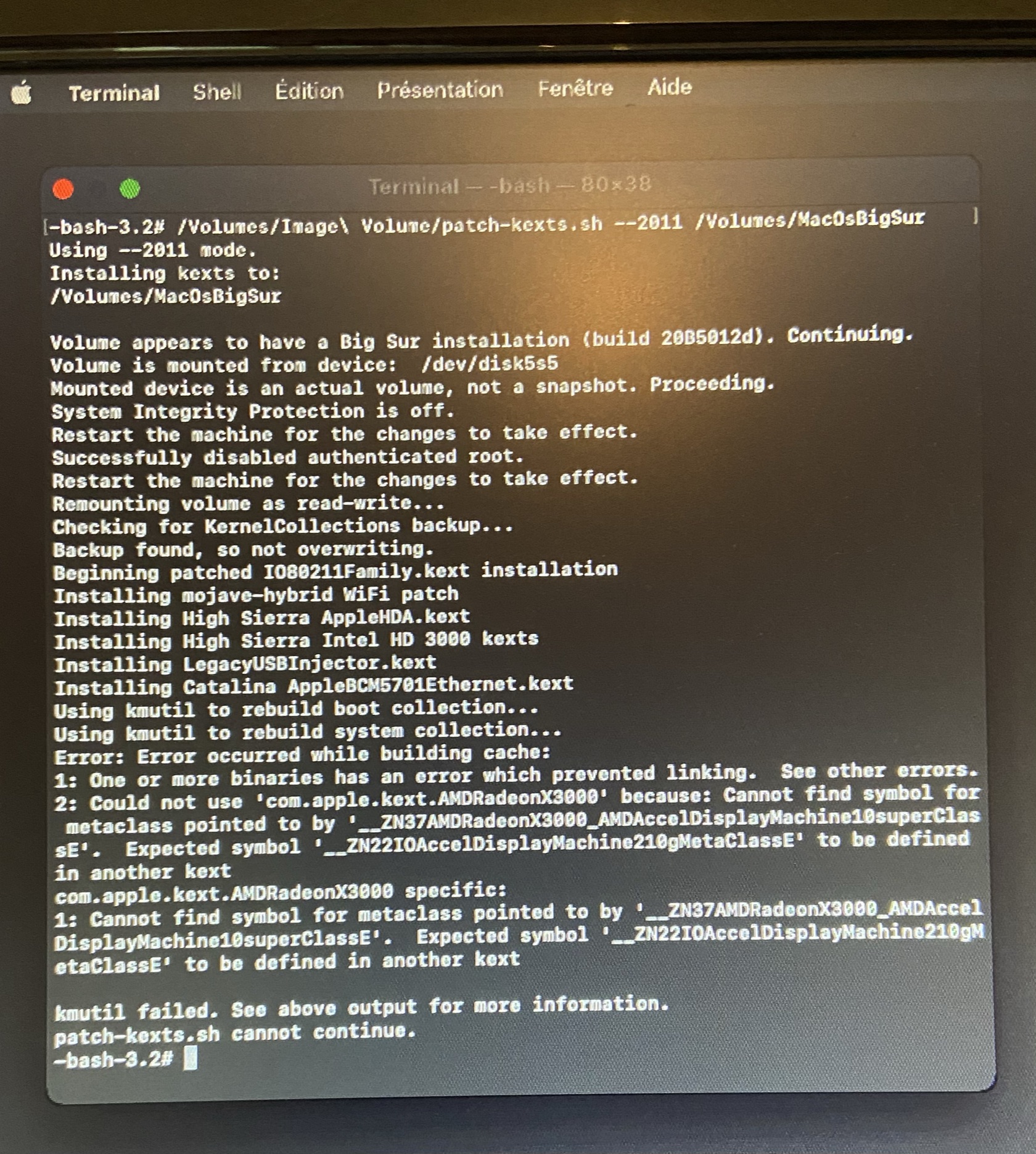

Hi

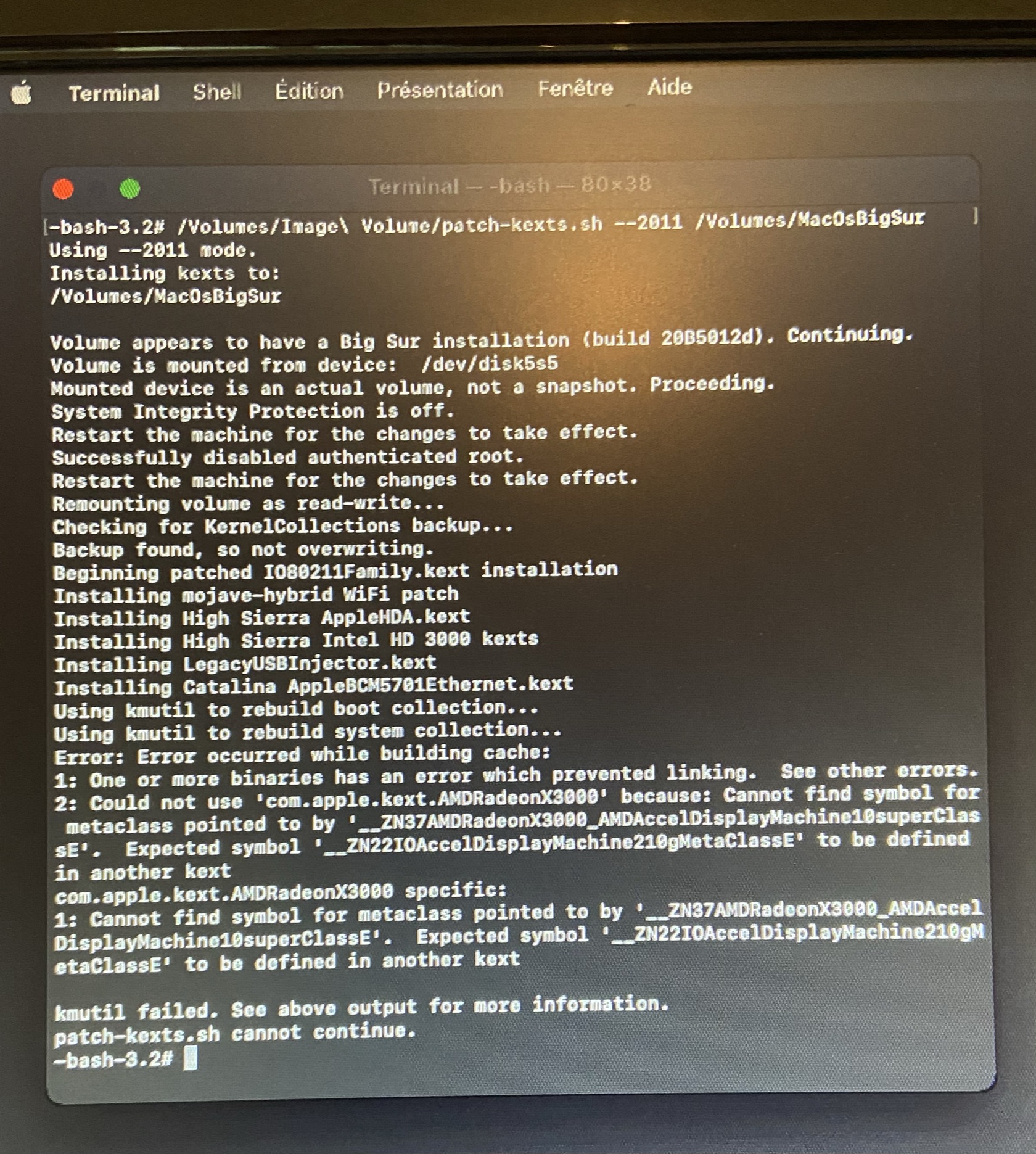

Trying to update to last beta on my Mac mini 2011 using micropatcher 0.4.4
When applying patch-kexts.sh —2011 got these errors. Both from the booted installation or from the Usb stick. What should I do?
Hi
Try this from a BigSur terminal environment:
diskutil list
(locate your "BigSur Data Volume" label)
cd /Volumes/YourBigSurLabel*Data/Library/Extensions
rm -r AMD* ATI*
then retry micropatcher patch kext .

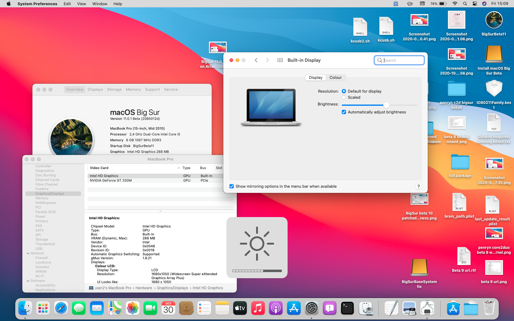

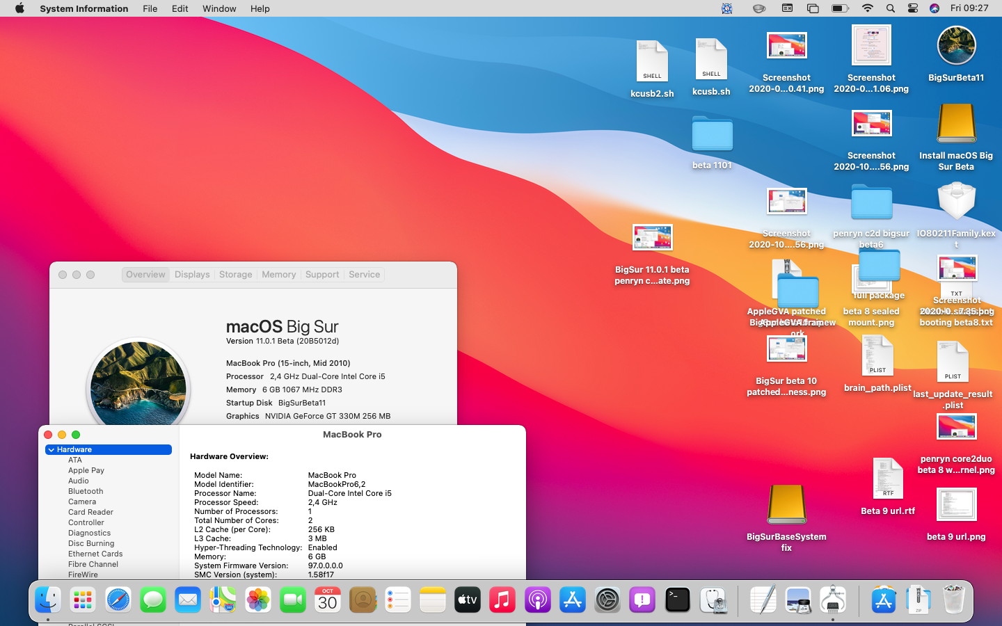

tested and working (it's a dual GPUs with installed IntelHD Arrandale kext), thanks to @khronokernel ACPI patch and OpenCore, BigSur 11.0.1 beta can now boot with Arrandale MacBookPro, @fabioroberto, @Badruzeus and others who own similar machines, this attached picture is from an already installed external USB BigSur booting through USBopencore, but I provide a way to install BigSur on those Arrandale machines directly with createinstallmedia : BaseSystem Legacy USB fix
edit:
I attached my customised external USBopencore setup (simply unzip it to any USB device FAT32 formatted) for Arrandale Mac (and similar Intel architectures) and it can be used at apple startup manager with alt-option key to boot BigSur kernel on those machines.
You need to boot through this OpenCore4b1 any BigSur installer stages, if you encounter some issues try the previous OpenCore3b1 version .
