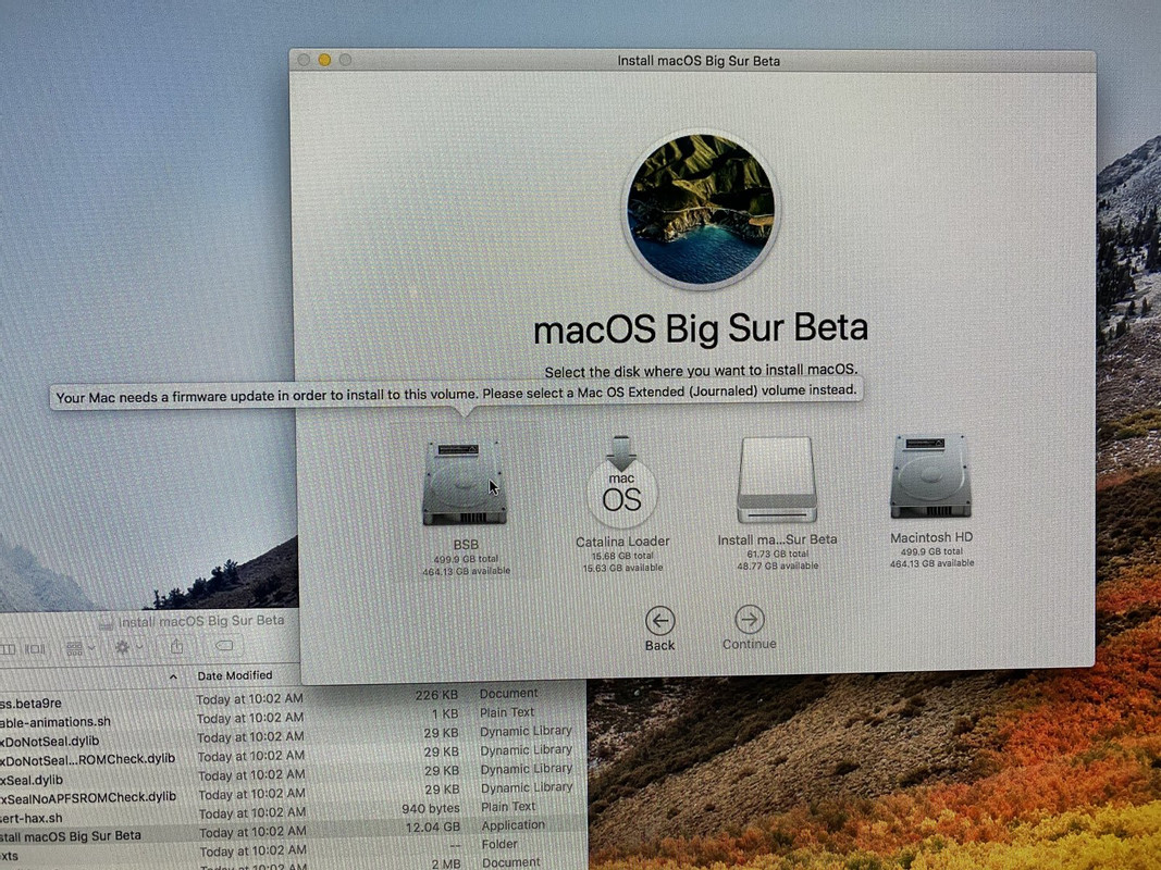

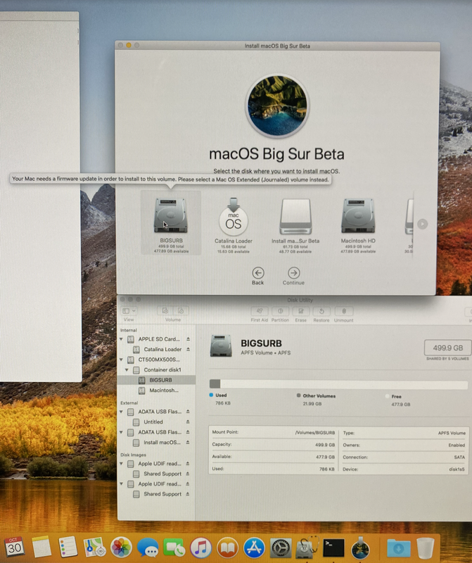

I seem to making progress on my 11,1. However, upon launching the BS installer, when I choose a newly-created Volume as my installation destination, I get the following error. I'm running APFS volumes, already.
Your Mac needs a firmware update in order to install to this volume Please select a Mac OS Extended (Journaled) volume instead.
I would try booting it from a USB flash drive rather then launching the installer from your desktop. What version of MacOS are you upgrading from? I hope this helps.

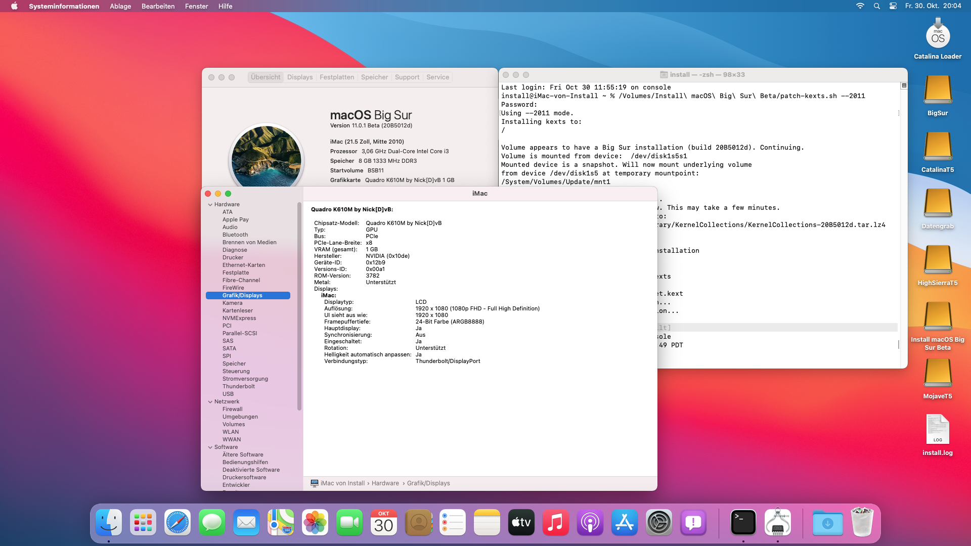

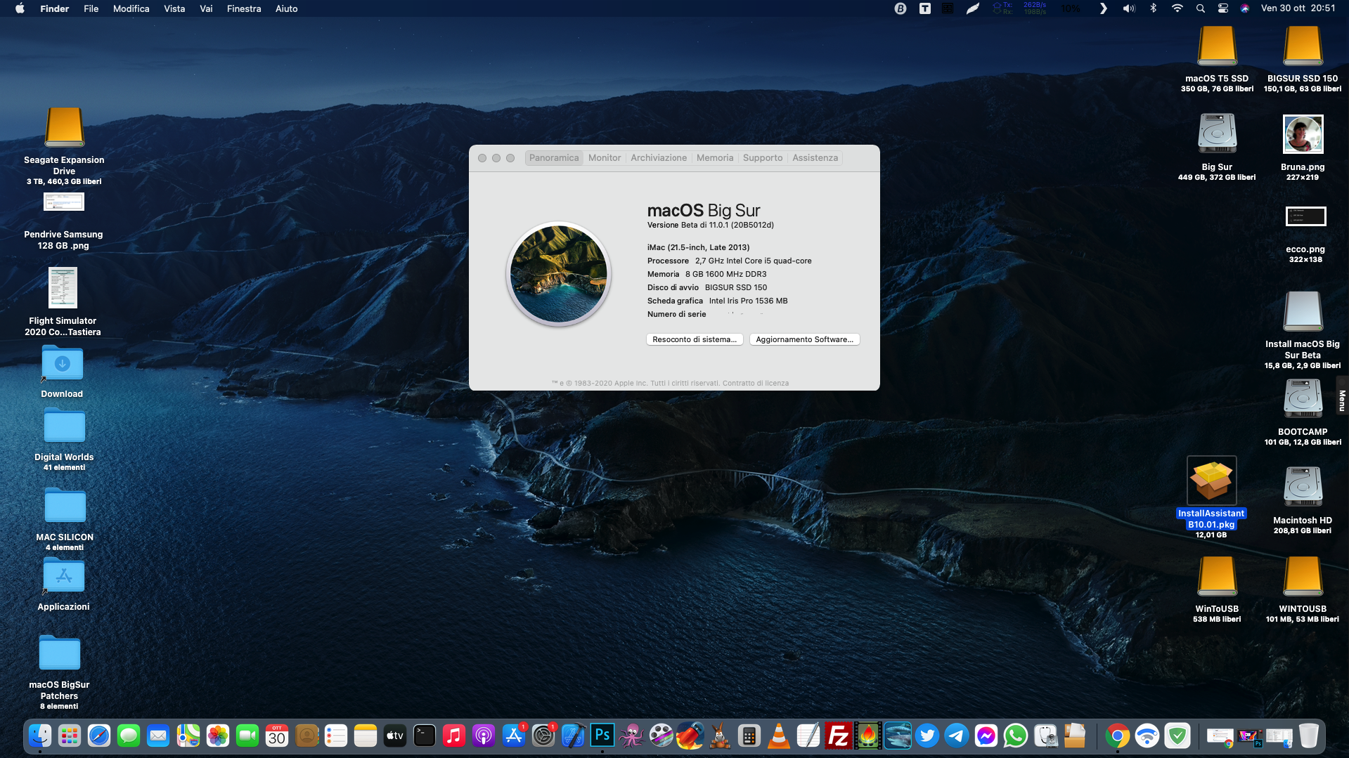

iMac 11,2 - this is another new one
Using the OpenCore as suggested here I could install Beta 11 on this iMac 21.5 2010 with an Nvidia Metal card. I forced the patcher using patch-kext.sh --2011 and got a smoothly working system. Okay you saw this before. The --2011 flag does the job. Even then the HD3000 extension are not really needed :)
We can streamline this patching process and patch selection during the next days.
Thanks a lot @khronokernel and @Barry K. Nathan and @jackluke !

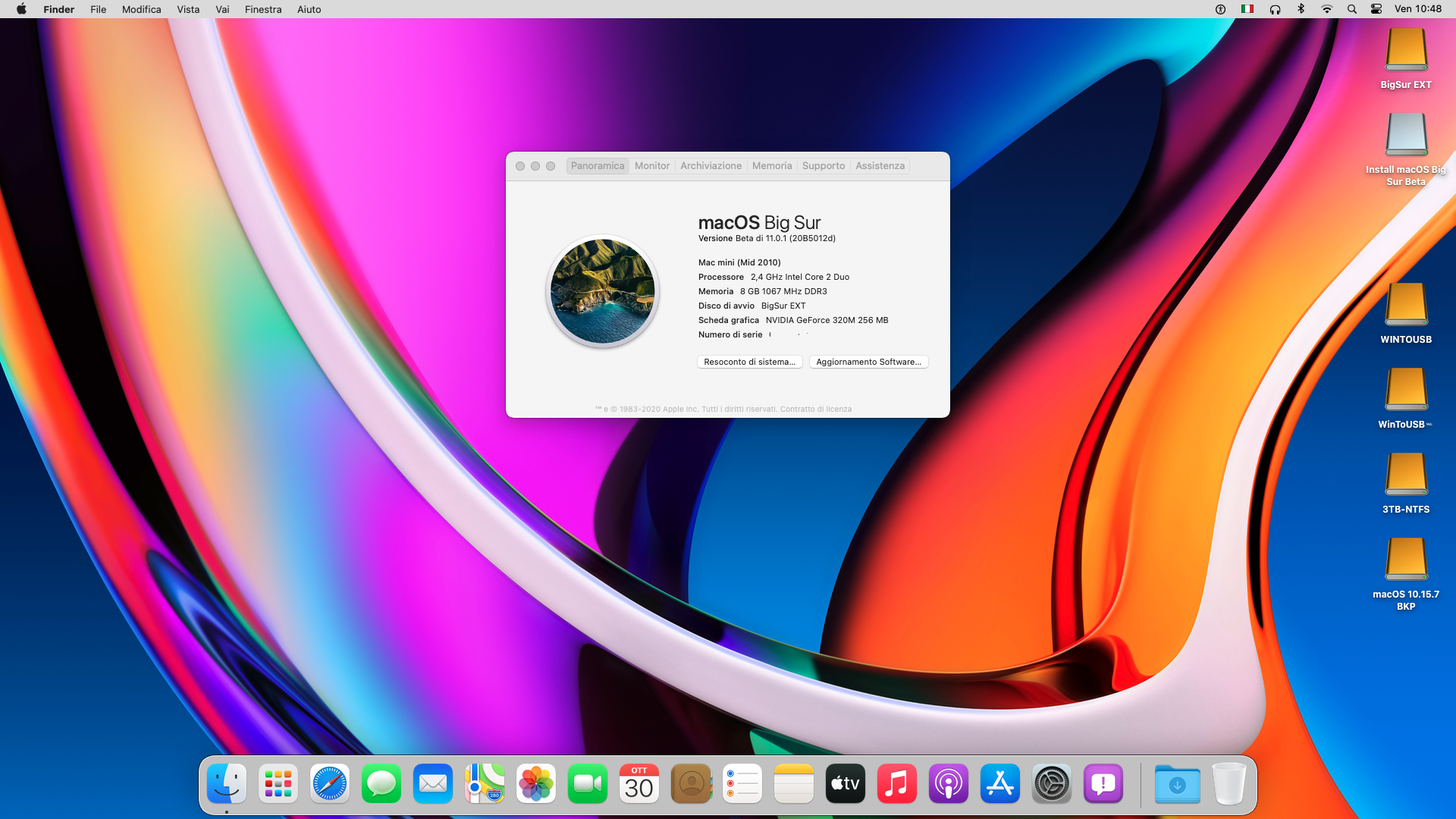

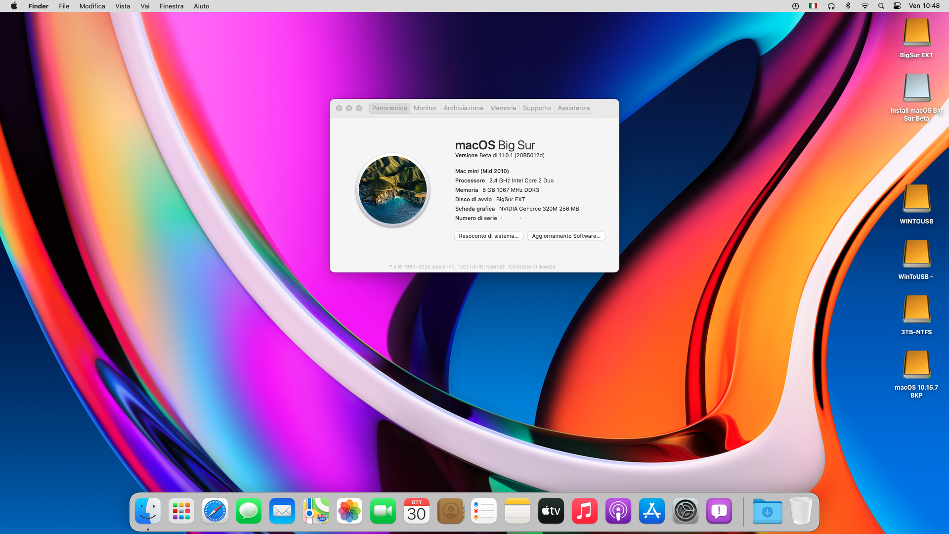

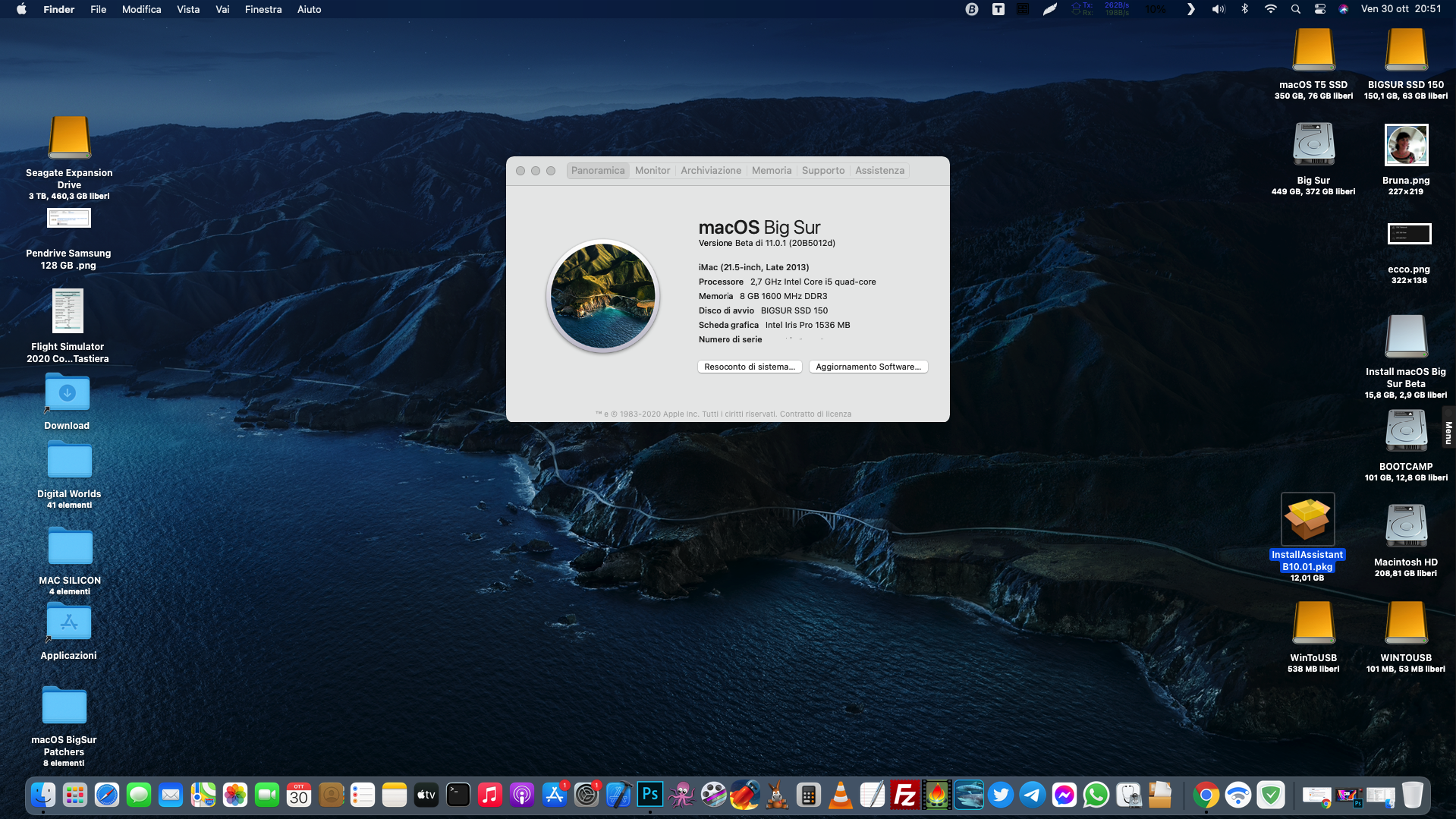

Success updating BS beta 11.0.1 using USB Installer with micropatcher 0.5.0-C
-Mac mini 2010 patched --2010 (errors on boot and system kmutil rebuilding collection) , All OK with micropatcher 0.5.0-C + OpenCoreLoader4S on stage 3, USB keyboard and mouse still work only using CMD + S, Apple booter.
-iMac micropatcher used only to boot with the installer, since I cannot select BS directly from Catalina + @ASentientBot
hax3 as until beta 10. No patch-kexts applied, but a lot of reboots (crashes?) until complete system loading.
Would someone mind taking a look at my issue below and see if I'm making a fundamental error in installation?
Despite my attempts to reformat my main SSD from APFS to JHFS+, I ended up screwing up the drive so bad that not only was my original High Sierra installation wiped, but I was unable to format the SSD for another re-install. I literally had to crack open my iMac 11,1, pull out the drive, and format the SSD on another computer.
Once back in, I did a fresh High Sierra installation on the wiped SSD. The installation of High Sierra to a "new" SSD will of course format it as APFS.
I am using (what I believe to be) a properly patched version of OpenCore loader that will allow the Big Sur installation. And I've created the Big Sur USB installer, and patched that as well per instructions from this thread.
However, I'm still unable to install on the new APFS Volume I created for this purpose (BIGSURB). I even tried to install it on an external USB, but get the error that the installation cannot occur on this (USB) disk.

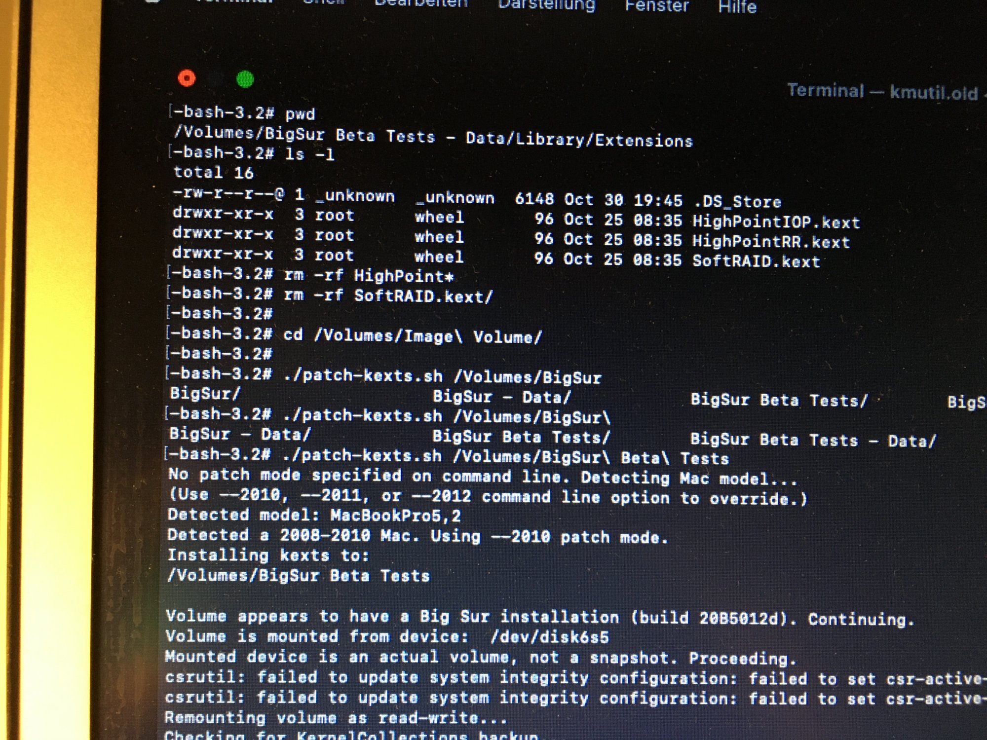

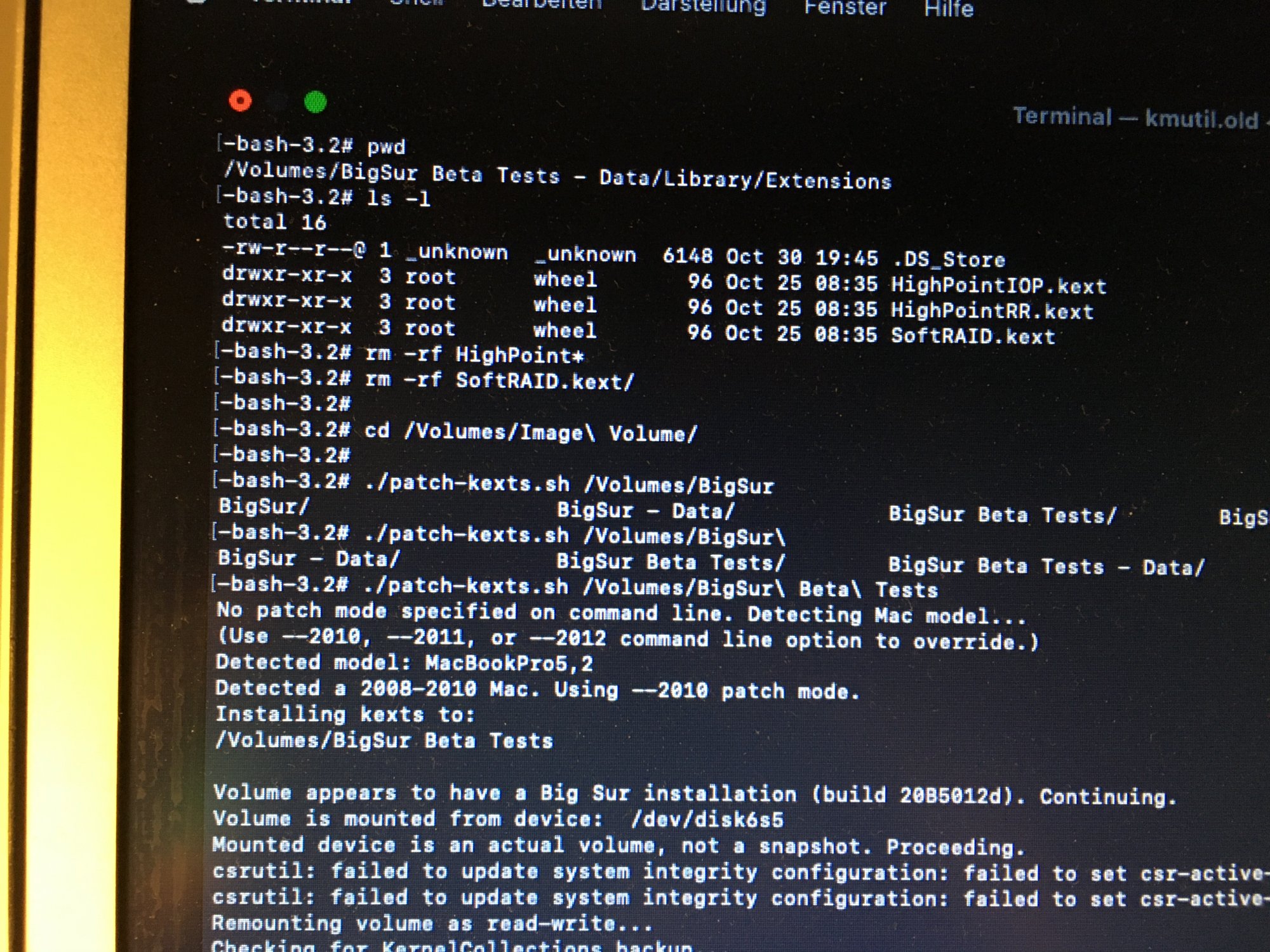

Hi Barry
removing the *Tesla* files worked.
Thanks for your help

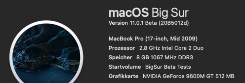

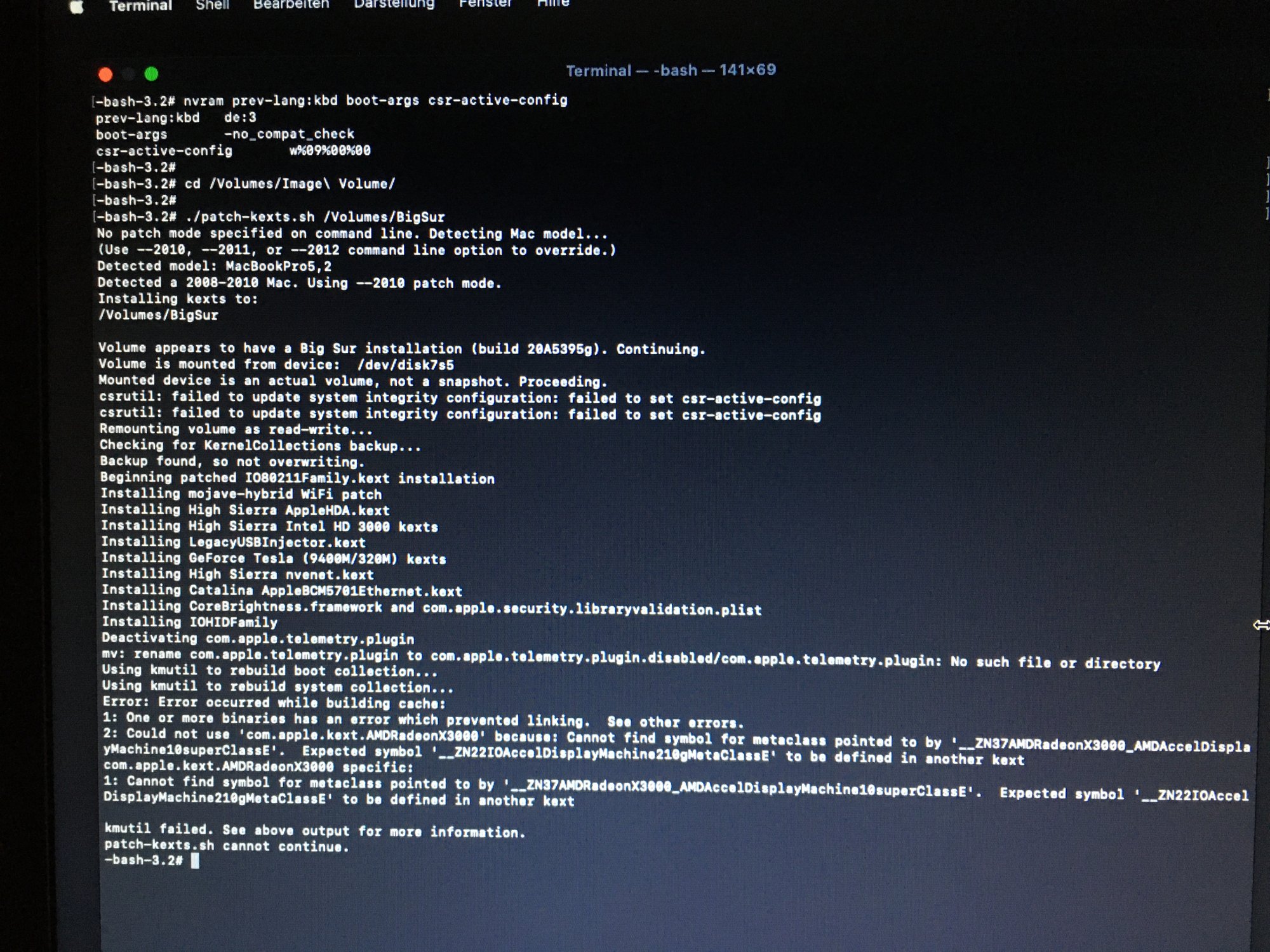

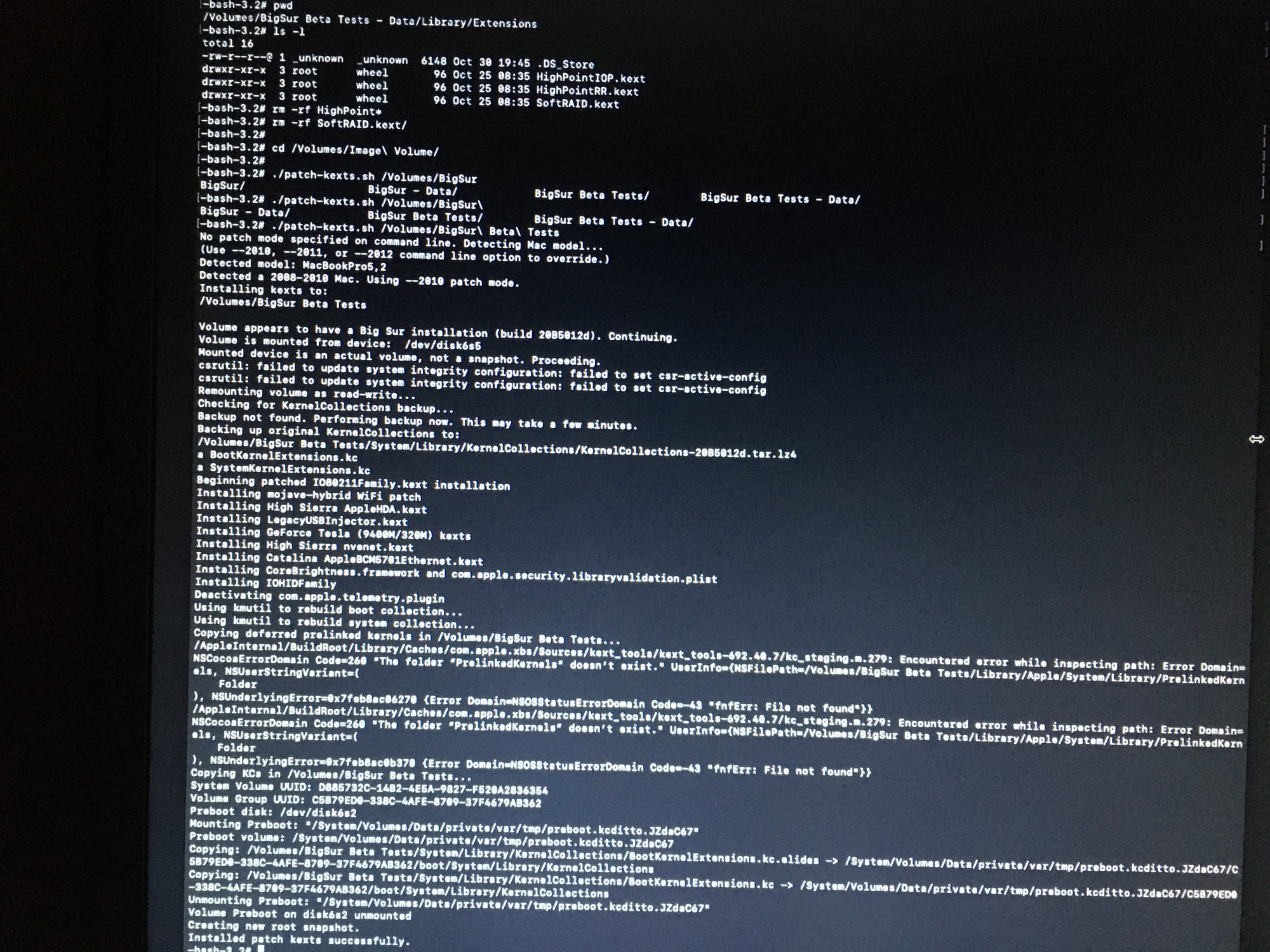

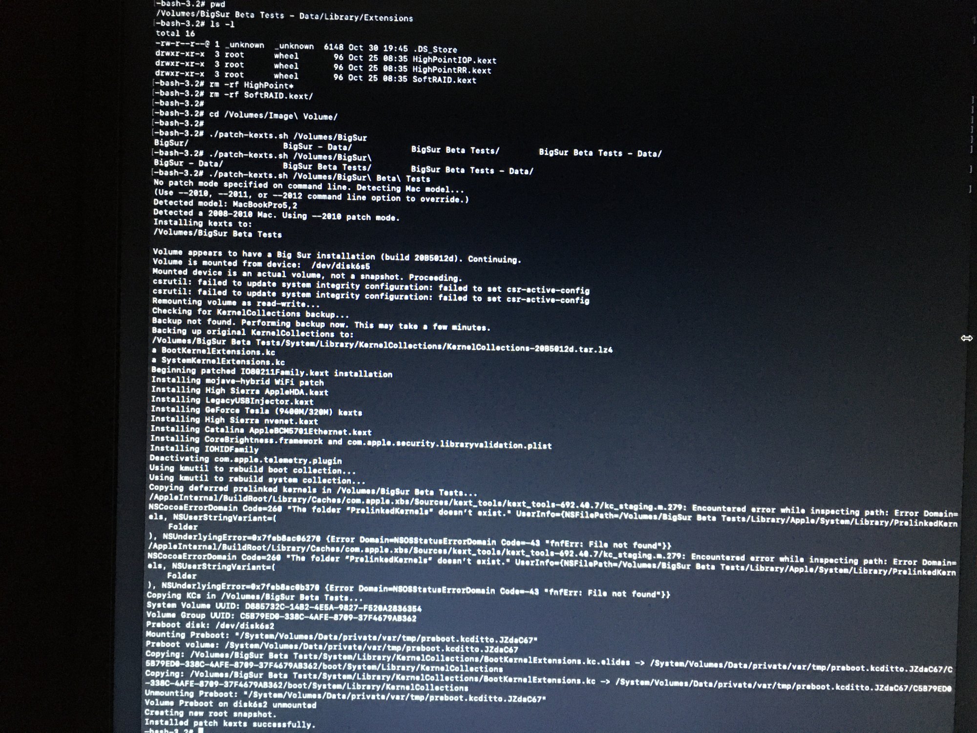

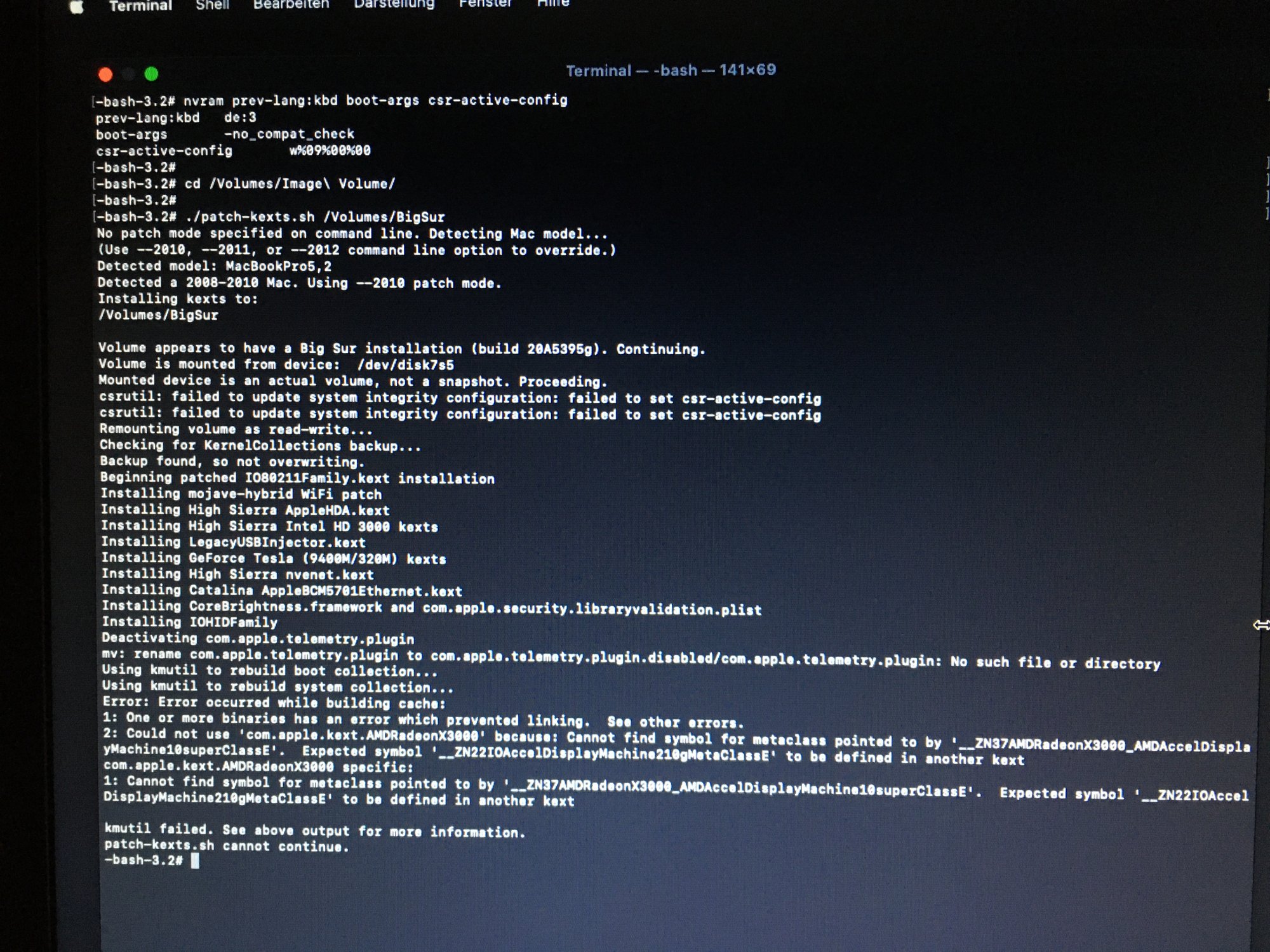

On MBP5,2, successfully installed 11.0.1 beta1 over 11.0 beta10.
The latter was a clean install, without using migration assistant, with createinstallmedia / BigSur BaseSystem legacy usb fix b9 / patch-kexts of micropatcher 0.4.3 (slightly modified to include patched CoreBrightness and patched IOHIDFamily).
11.0.1 beta1 installed over this with again its createinstallmedia / BigSur BaseSystem legacy usb fix b9 / patch-kexts of micropatcher 0.4.4 (modified the same way).
Importantly, I encountered the same problem as Jeanphil - thanks for your finding and for testing the fix!
I looked at the Library/Extensions of the data volume from the USB installer's terminal before successful execution of patch-kexts (BS not bootable on MBP5,2 at that point). There were three kexts, which looked as unrelated to the problem, as they looked useless. After deleting them, patch-kexts worked well.
NightShift, internal audio, Ethernet and WIFI all work well.
EDIT: just tried with FaceTime - iSight camera works as well.
EDIT2: and USB keyboard, USB mouse work (no CMD+S / exit booting needed).
Edit - forgot to say that I use USB2/USB3 hotswap during installation to overcome the legacy USB power problem, as mentioned in earlier posts.
Not using OpenCore at present.
Easy to fix. Because you’re using opencore you need to toggle the below on for the install to avoid this error. Search for the below in the opencore config file and update.
I would also recommend using the usb installer instead of installing from within your current os.
Toggle the VMM flag
I did a little research and found this, can't install using OpenCore because "Your Mac needs a firmware update" I know it's for MacOS Catalina but it could help you.
Hope this helps.

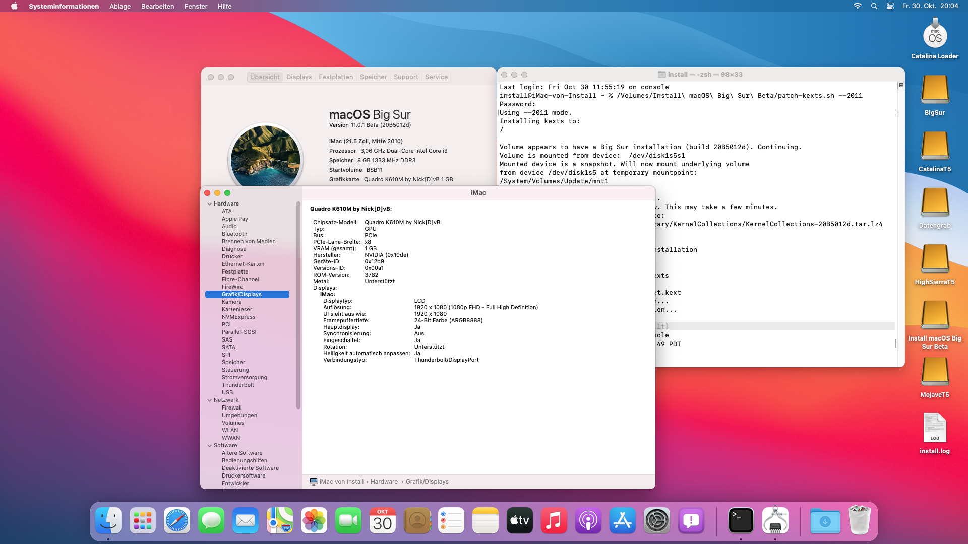

For those of you that installed Big Sur on an iMac 11,1 with Metal-GPU like K2100M (or similar), do you still have Target Display Mode available?
Reactions: TimothyR734
