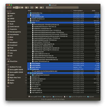

I used a rather special hybrid installation scheme:
USB BS installer made with createinstallmedia of 11.0.1beta1, then applied jackluke's BigSur BaseSystem legacy usb fix b9 to it, then copied the payloads of Barry K. Nathan's big-sur-micropatcher-0.4.4 to the root of the USB installer (necessary parts only *).
- USB installer boots fine. In installer's terminal executed jackluke's + ASentientBot’s Hax3.sh.
- Then started installation with target SSD on one of the on-board USB connectors. Phase1 finishes.
- Phase2 can't proceed very far: the legacy USB (power) problem.
- Hot swap the SSD to one of the USB3 ports of a nanoTECH ExpressCard34 which I had bought after Larsvonhier's hint earlier in this thread. Phase2 continues to the end of the long white-on-black phase.
- Swap back to on-board USB for booting of the volume now called MacOS Installer (can't boot from the express card ports), then after legacy USB problem (after some 15sec) hot swap to USB3 for continuation.
- Same for the next booting. Afterwards installation to the target SSD is finished, but can't boot BS yet due to missing/wrong kexts.
- Boot USB BS installer again and run Barry's patch-kexts.sh. That works successfully.
Then BS beta1 boots fine from an on-board USB port, no further use of USB3 or swapping needed.
* the necessary parts are highlighted in the attached screenshot. Note that preferences and PrivateFrameworks have been added temporarily to v0.4.4, and that IOHIDFamily.kext and CoreBrightness.framework are patched versions. Maybe good to wait for a newer version of micropatcher.

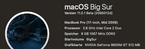

On MBP5,2, successfully installed 11.0.1 beta1 over 11.0 beta10.
The latter was a clean install, without using migration assistant, with createinstallmedia / BigSur BaseSystem legacy usb fix b9 / patch-kexts of micropatcher 0.4.3 (slightly modified to include patched CoreBrightness and patched IOHIDFamily).
11.0.1 beta1 installed over this with again its createinstallmedia / BigSur BaseSystem legacy usb fix b9 / patch-kexts of micropatcher 0.4.4 (modified the same way).

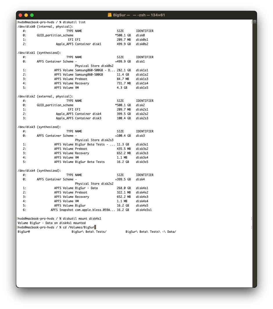

Importantly, I encountered the same problem as Jeanphil - thanks for your finding and for testing the fix!
I looked at the Library/Extensions of the data volume from the USB installer's terminal before successful execution of patch-kexts (BS not bootable on MBP5,2 at that point). There were three kexts, which looked as unrelated to the problem, as they looked useless. After deleting them, patch-kexts worked well.
NightShift, internal audio, Ethernet and WIFI all work well. Yet to try iSight (EDIT: just tried with FaceTime - iSight camera works as well).

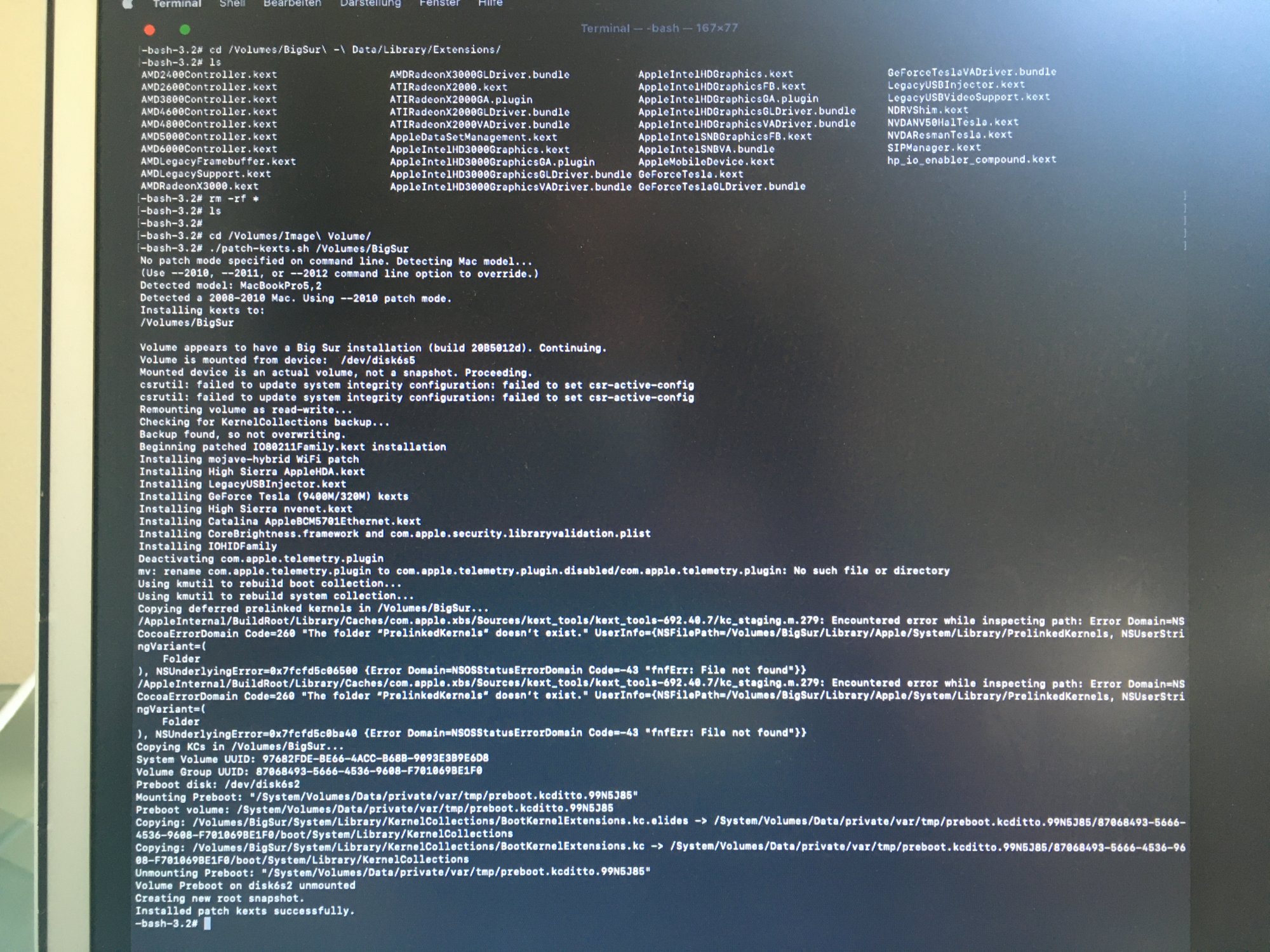

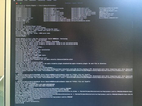

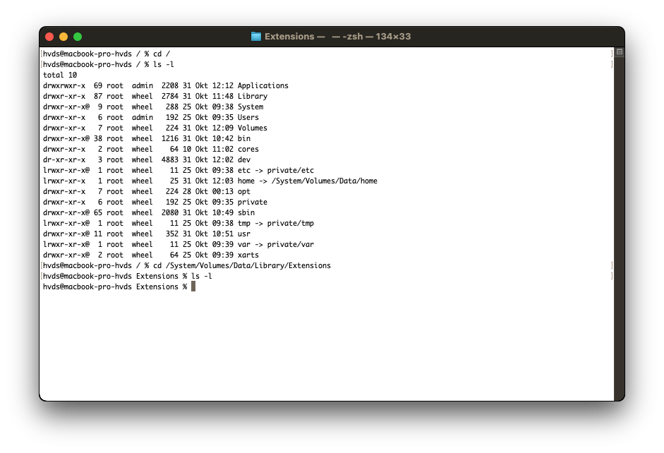

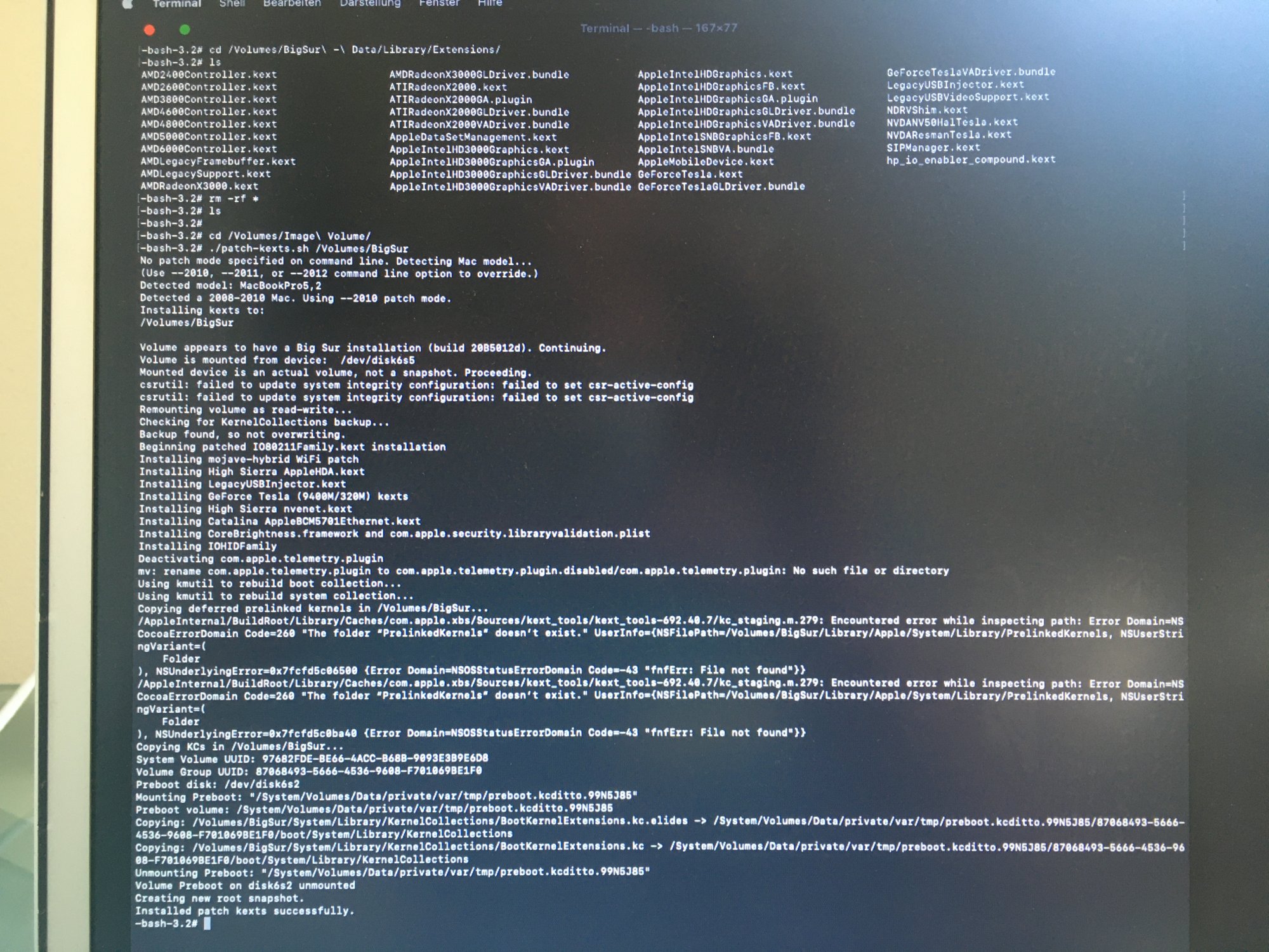

Today, installed 11.0.1 beta1 over my other 11.0 beta10, which has "everything" from my Catalina 10.15.7 workhorse disk via migration assistant.
Also successful, with similar problem encountered. Observations:
- quite a lot of kexts etc in Library/Extensions of the data volume. I deleted first the three kexts I also did yesterday (HighPointIOP.kext, HighPointRR.kext, SoftRAID.kext), but patch-kexts can't complete with error like yesterday. The others must have come in by migration, as they were not there in yesterday's beta10 setup made without migration.
- then after making a backup copy I was more courageous and deleted all these files. patch-kexts runs well, system boots and runs well.
- strange: the three kexts I deleted before running the installation, were there again after installation. Deleted them again and all others (of Library/Extensions of the data volume), for running patch.kext.
I can't cd to the data volume in the booted BS, only e.g. from USB installer. I'm using instead /System/Volumes/Data in booted BS, which seems to be the same.

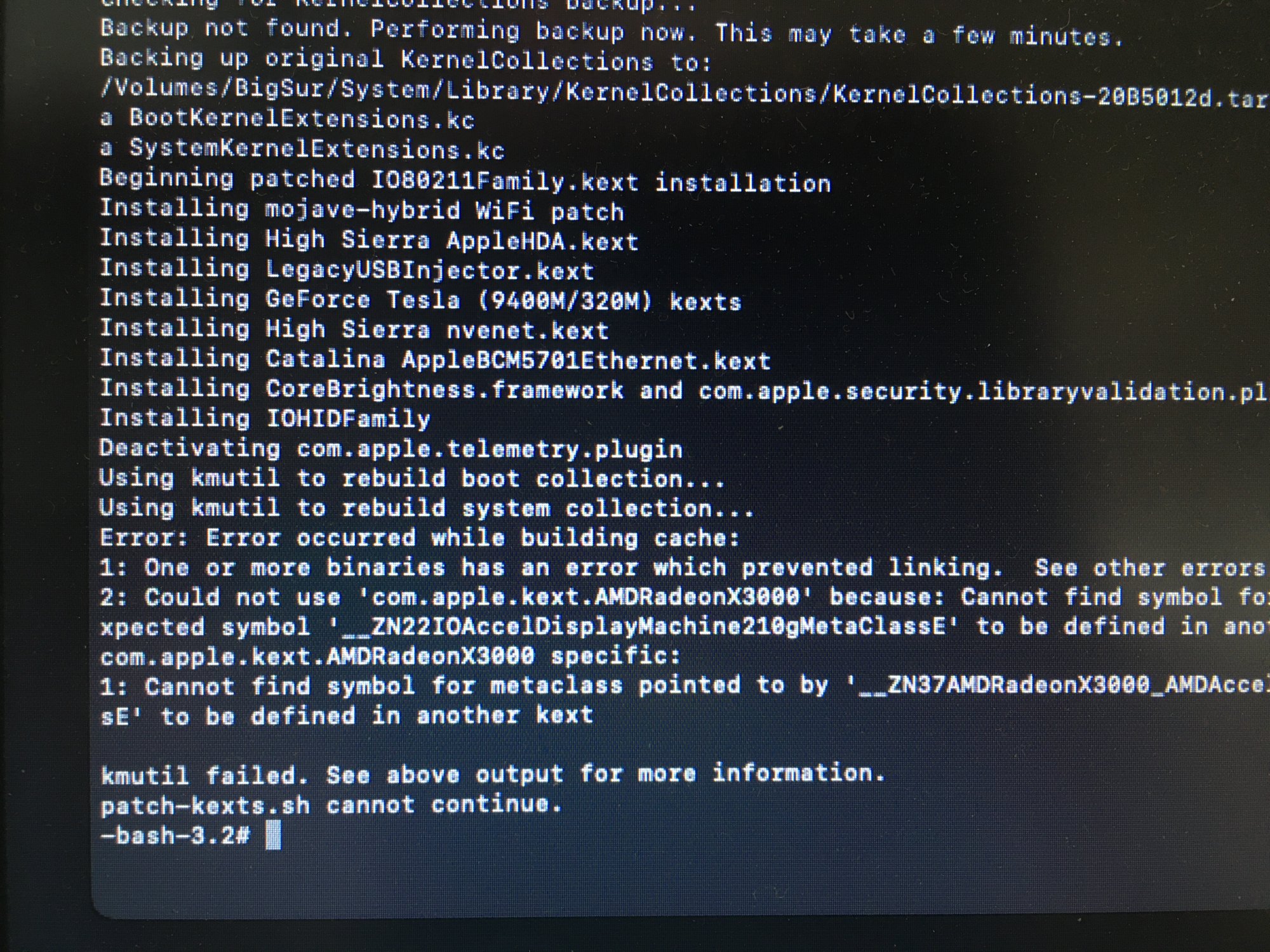

Install 11.0.1b1 over 11.0b9 in Mac mini 2012, the process was ok up to the step 15 when I need to patch Wifi again
- Instalation process end directly running 11.0.1 so Wifi is turn off and no chance to turn on . grey color
- Restart USB installation, run terminal to patch-kext.sh but get this error. Anyway I boot for try and Wifi card still was grey. I've try run terminal from the installed partition (Big Sur session, I guess tutorial talk about) but got the same error.
- With beta 9 I get Wifi card work. Any way I have a USB T4U wifi ac compatible and I have internet access but Hand Off or Airdrop doesn't work
No WiFi option specified on command line, so checking for 802.11ac...
Found 802.11ac WiFi card, so not installing a WiFi patch.
No patch mode specified on command line. Detecting Mac model...
(Use --2010, --2011, or --2012 command line option to override.)
Detected model: Macmini6,1
Detected a 2012-2013 Mac. Using --2012 patch mode.
Installing kexts to:
/Volume appears to have a Big Sur installation (build 20B5012d). Continuing.
Volume is mounted from device: /dev/disk2s5s1
Mounted device is a snapshot. Will now mount underlying volume
from device /dev/disk2s5 at temporary mountpoint:
/System/Volumes/Update/mnt1
Checking for KernelCollections backup...
Backup not found. Performing backup now. This may take a few minutes.
Backing up original KernelCollections to:
/System/Volumes/Update/mnt1/System/Library/KernelCollections/KernelCollections-20B5012d.tar.lz4
a BootKernelExtensions.kc
a SystemKernelExtensions.kc
Beginning patched IO80211Family.kext installation
patch-kexts.sh encountered an internal error while installing the WiFi patch.
This is a patcher bug. patch-kexts.sh cannot continue.
I have one issues in Big Sur, I don't know if they could be for new macOS version or because my is an "unsupported Mac"
- TP_link adapter T4U installation. the driver is not updated for Big Sur however when I install it works, however the problem is the installation process. Just in the end show a message that doesn't complete the installation process. Anyway it works, load the manager and connect to wifi
The problem is that every time I reboot I need to re-install the driver and configure the wifi connection
Can I force the installation process in any way?

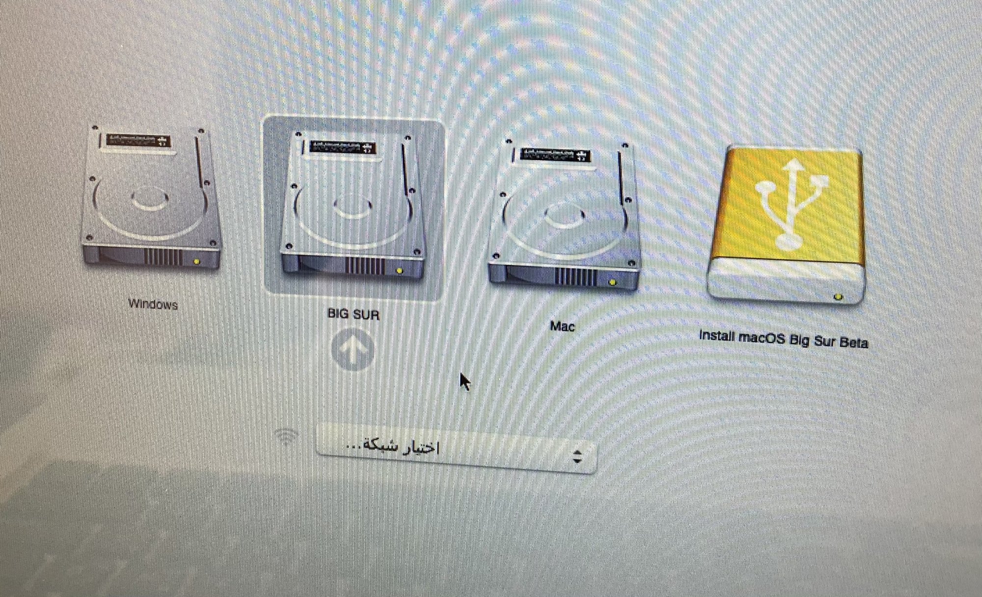

I have a MBP(5,3) 2009. I installed to an external USB3 drive on my MBA(5,2) 2012 and then run the patch-kexts.sh --2010 (Thanks Barry!). In the MBP I swapped the DVD for a SSD caddy and made a RAID0 HFS+. Inside the RAID array I created an APFS container and restored from USB3 drive with superduper, CCC, etc. It runs pretty well for a notebook over 10 years old. The RAID drive really improves the performance a lot. around 500MB/s read and 400MB/s write. Before that I was running Dosdude Catalina patcher. Very slick program with nice Nvidia video support. I also patched my firmware to natively boot APFS even though Nvidia chipset was risky. It worked well and gave me a backup ROM that I can flashback if I need to. Hopefully my experiences will help some of the other users soup up their old hardware. Thanks everyone for the good posts. Happy Holloween!

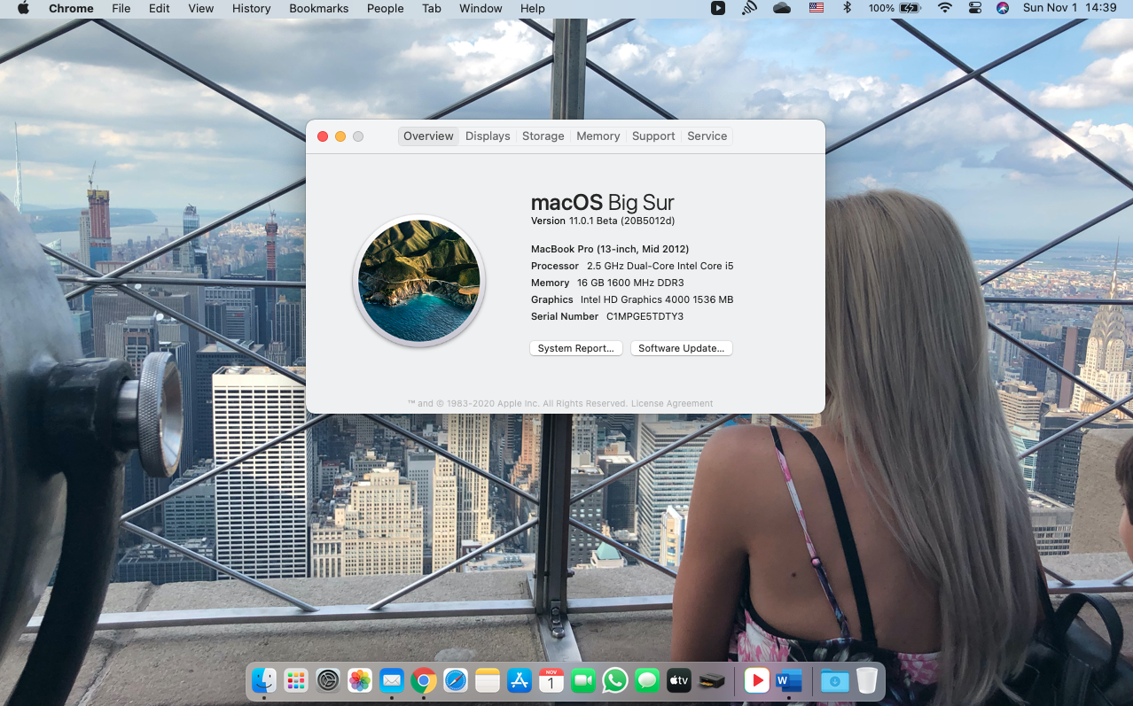

Tanks to @Barry K. Nathan's patch 0.4.4. I have managed to install without any hitch the new Big Sur 11.0.1! No need to bless like the previous version. All working perfect (wifi, airdrop, handoff). Thank you for all your time and effort! MBP 13" mid 2012 with metal. Have a great one!

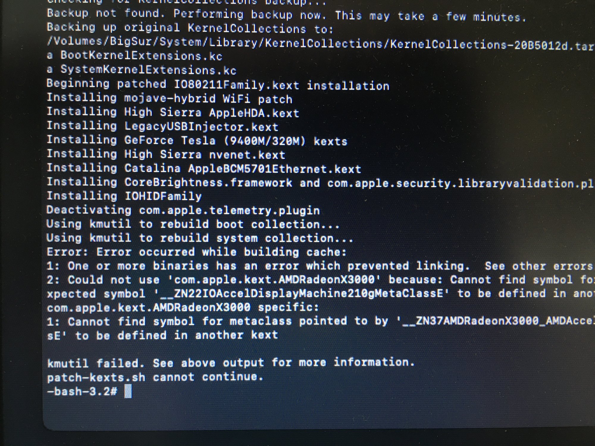

Hi all,
I need your help because my iMac (2012) doesn’t boot anymore. I was using BS beta 10 without any problem and I tried to upgrade to the last beta by booting with my USB key OpenCoreAPFSloader4s1. The update was detected and after the download my iMac tried to do a restart but the display was black and now it is always black (not white). I tried to reset the SMC, vram and pram but nothing changes and I’m not sure the reset was done as I saw nothing or no change. Do you know what I can do?
Thank you.
Reactions: Jordillav22
Hi all,
Thank you.
You should reboot from your backup, because you have a backup, don't you?
