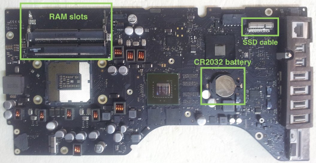

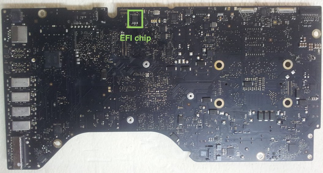

Hi all,
I need your help because my iMac (2012) doesn’t boot anymore. I was using BS beta 10 without any problem and I tried to upgrade to the last beta by booting with my USB key OpenCoreAPFSloader4s1. The update was detected and after the download my iMac tried to do a restart but the display was black and now it is always black (not white). I tried to reset the SMC, vram and pram but nothing changes and I’m not sure the reset was done as I saw nothing or no change. Do you know what I can do?
Thank you.
You used my USBOpenCore4s1 that is a spoofing setup to iMac15,1 (supported BigSur Mac)
First before send flashing again the EFI EEPROM chip (that surely will fix your unbootable iMac) check this:
https://forums.macrumors.com/thread...unsupported-macs-thread.2242172/post-29142202

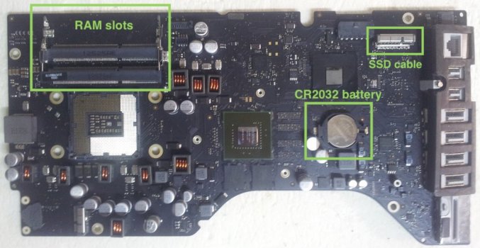

Mainly try to remove the RAM from slot and CMOS CR2032 battery (iMac logic board picture example attached) unplug power cable and let unplugged for an hour, then try use an apple wired original genuine keyboard (because I guess after the EFI update the bluetooth one is unpaired) to make PRAM reset, not sure if your iMac has also a CMOS battery that could be removed on the logic board to reset the stored nvram configuration.
Otherwise you could even remove your internal hard disk, then copy to external USB my earlier opencore version that had a feature to reset PRAM even without an undetected keyboard from apple startup manager:
https://forums.macrumors.com/threads/macos-10-15-catalina-on-unsupported-macs.2183772/post-28354120
Searching on internet you can find already programmed EFI BIOS chip in your case a 21.5 inch A1418 EMC 2544 or 27 inch A1419 EMC 2546 , then with proper tools you can fix it (in some machines soldering skills are required).

From my earlier Mojave EFI brick and reflashing I used a WinBond EEPROM Chip 64 MB (the binary size of many non Metal apple firmware is less than 4 MB), while for Metal Mac I guess at least 8 or 16 MB is required, you could use even a different vendor chip example Macronix MX , Micron or Amtel with higher size, if the firmware is correctly flashed on chip it will boot the Mac anyway, to flash the firmware with tools you might require a Windows PC that has more user friendly software and USB drivers , otherwise recently there are advanced external tools to fix EFI solderless plugging some adapters to an apple service port.

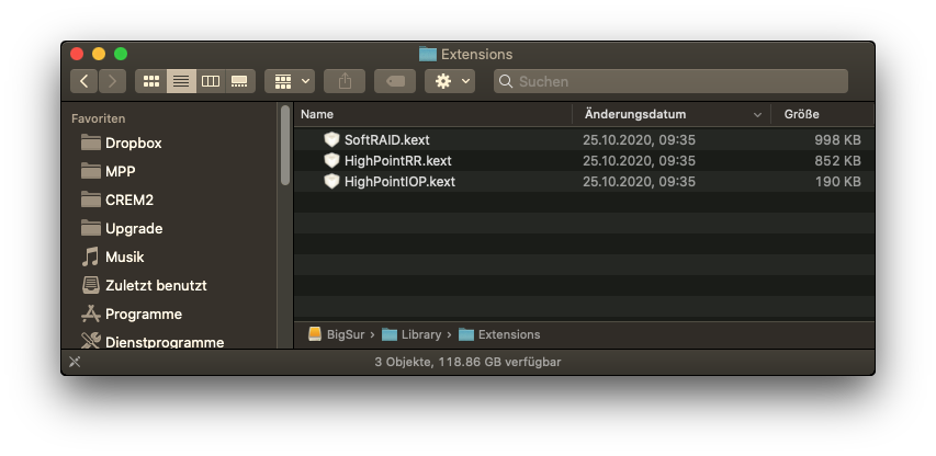

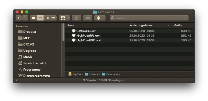

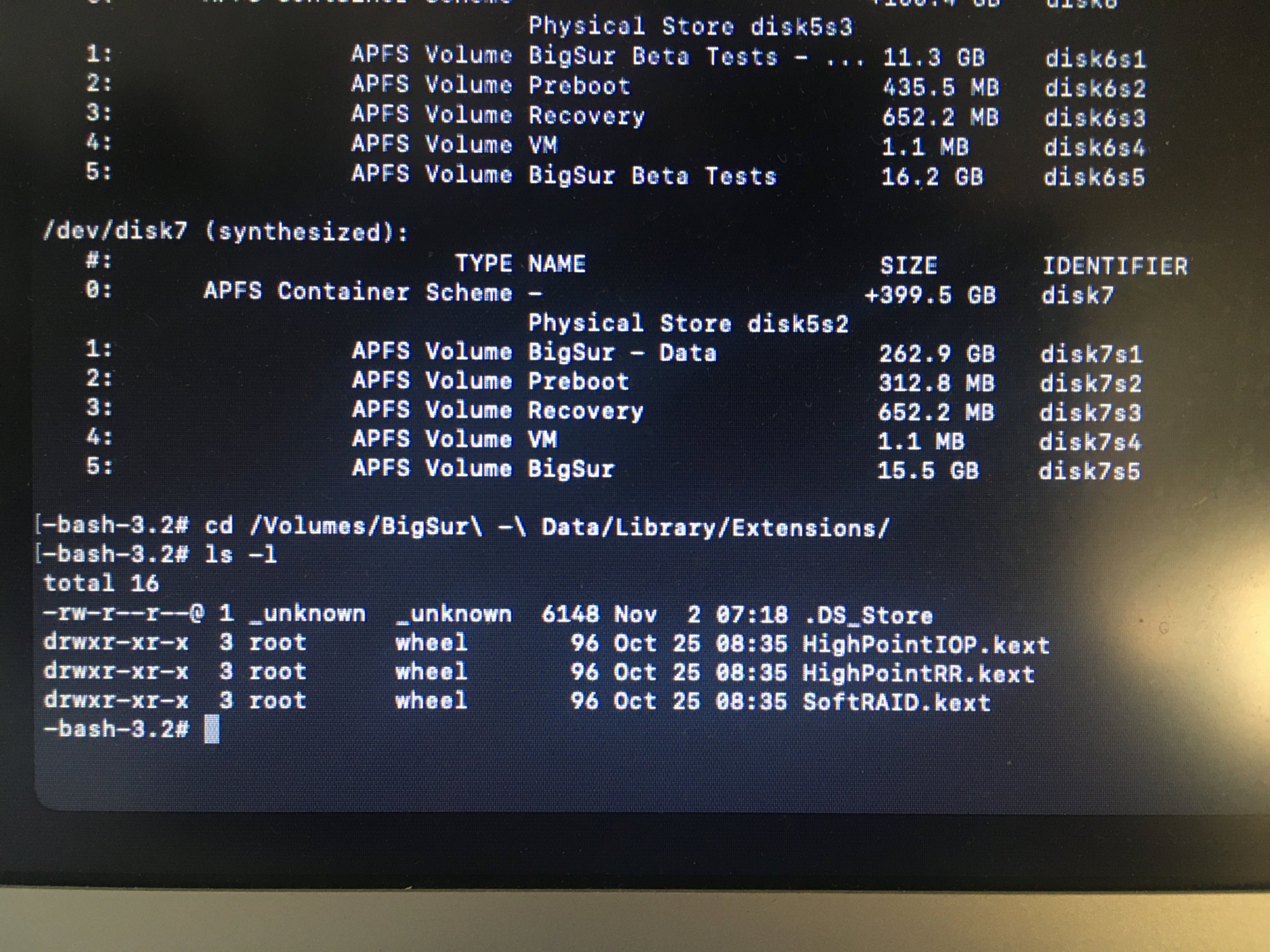

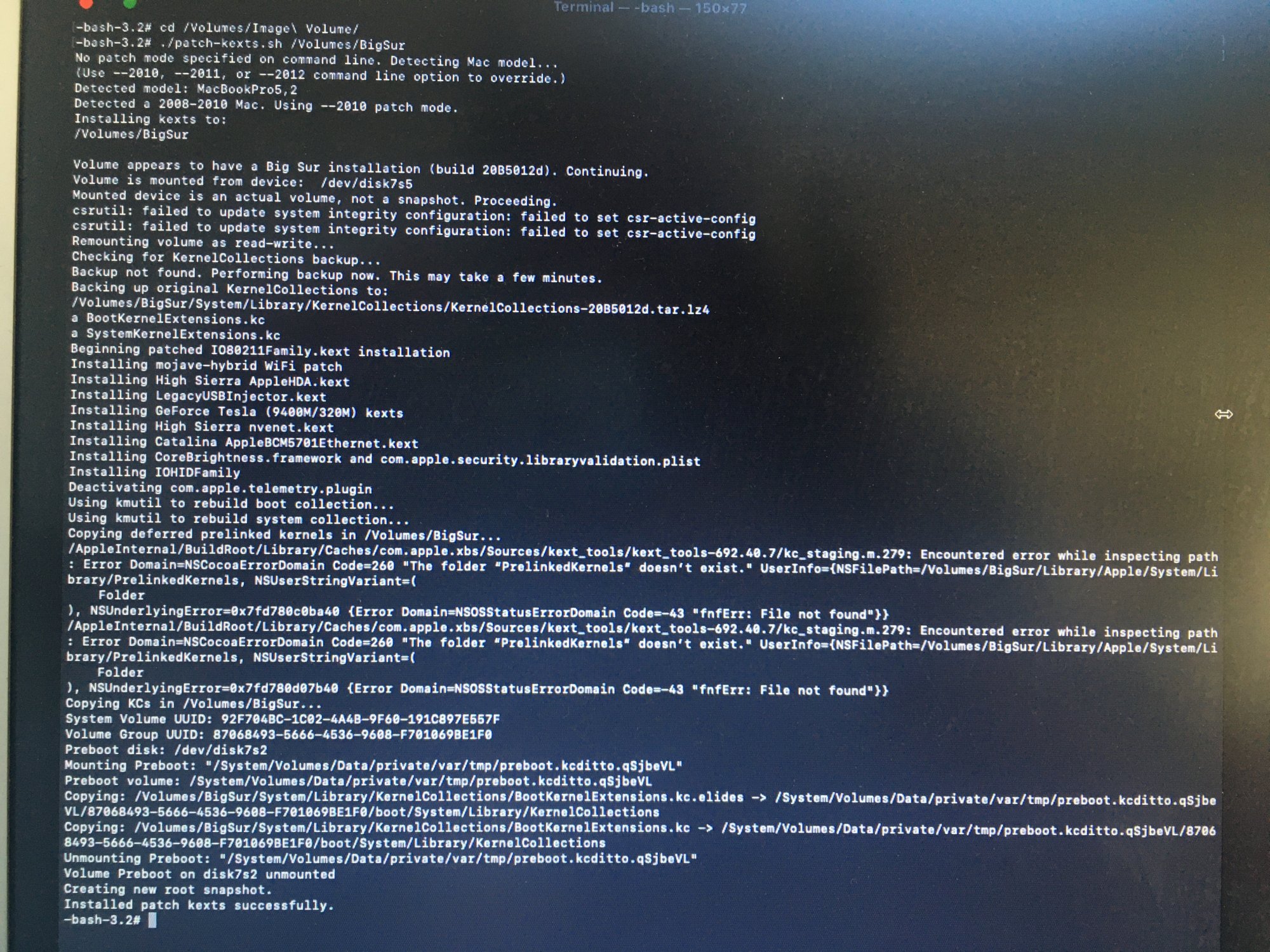

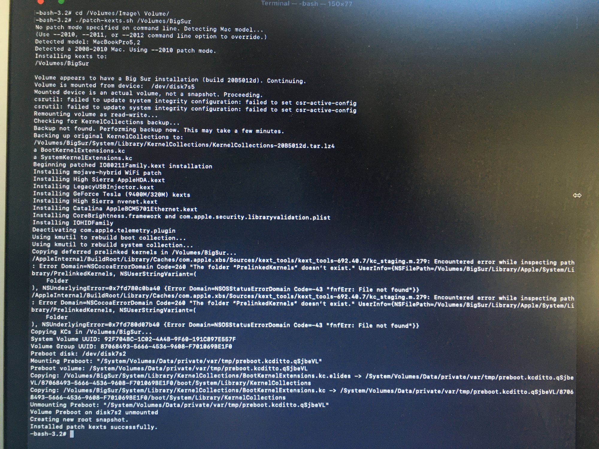

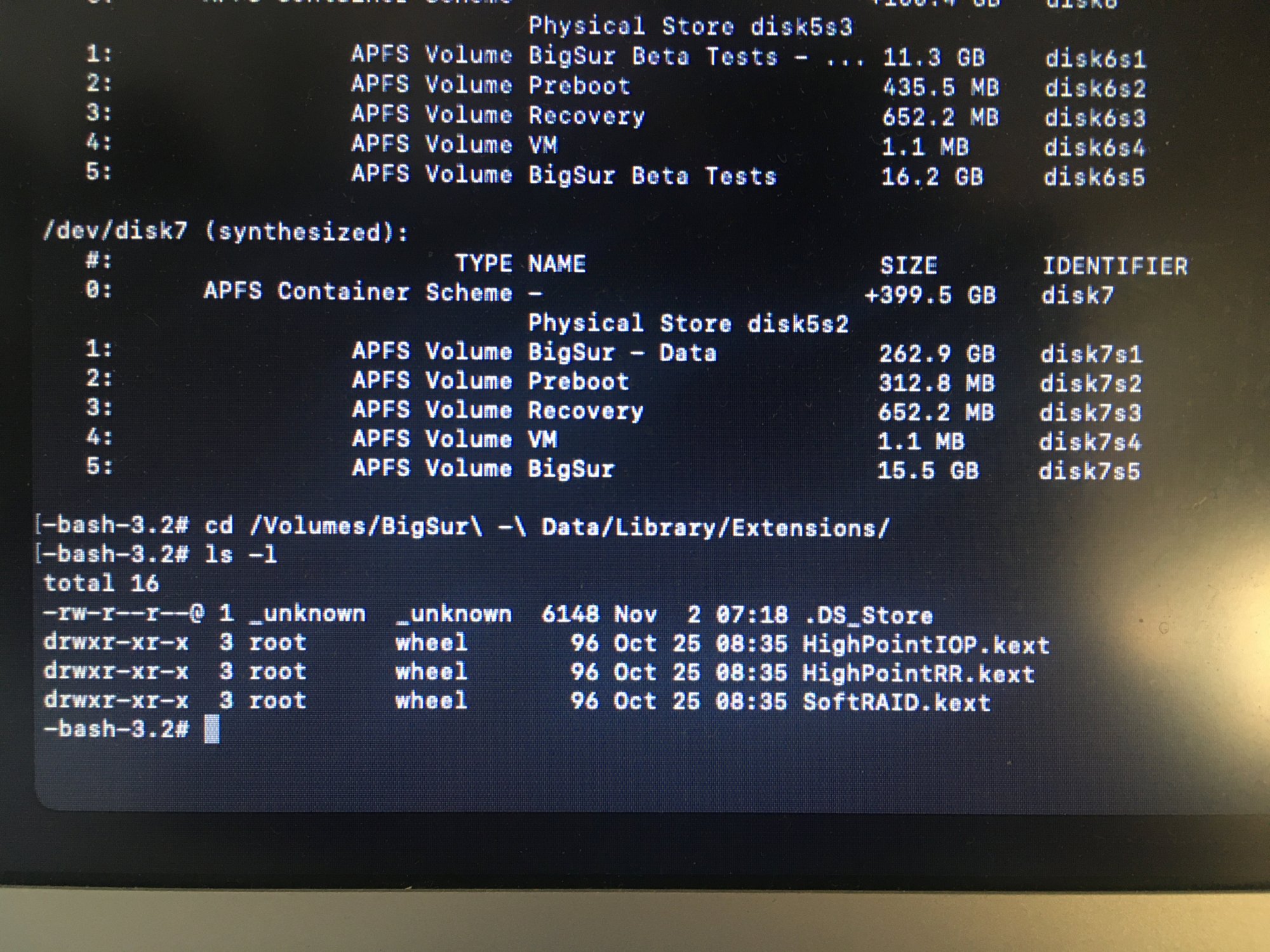

Made one more exercise with kexts in Library/Extensions.
As said earlier, I had deleted all files from Library/Extensions of my BS installation, to let patch-kexts proceed after installing 11.0.1beta over 11.0beta10. The resulting system booted and worked fine. Most files in Library/Extensions were obviously put there by migration assistent, taken from Catalina 10.15.7.
Then repeated the install-over to see what happens. The Library/Extensions, empty before installation, now contained the three files (screenshot). But this time they did NOT hinder patch-kexts from working correctly. The files are newer than the ones I had deleted from Library/Extensions before.
As said earlier, on my legacy-USB MBP5,2, I use jackluke's BigSur BaseSystem legacy usb fix b9 instead of BarryKN's micropatcher.sh to patch the result of createinstallmedia. The files used by jackluke method for patching Basesystem.dmg don't contain the three found after installation in Library/Extensions. The three must come from Apple's installation process and are OK.
Next time I run a migration to BS, and before subsequent installation of a newer BS over it, I'll just delete all files from Library/Extensions. Doesn't hurt at least in my case.

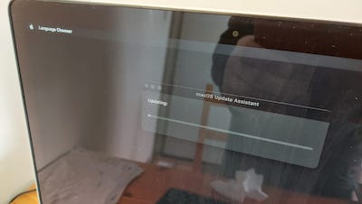

The mystery of the 'no entry' screens continues. (I know what the 'no entry' screen is and I know how to get past it. This is not about that.)
After a normal, everyday partitioning disaster 😬😱 I needed to re-install Big Sur.
1. I got Catalina using internet recovery and then used OpenCoreAPFSloader4s1 to try to get the 11.0.1 beta full upgrade as a developer seed software update. However (Mystery #1) after downloading (still 100% within an OpenCore boot), this failed with "InstallAssistant.pkg does not meet the gatekeeper policy" (not the exact wording). I tried this twice, same result.
2. So instead I got Big Sur 11.0 beta 10 from a direct download link and used createinstallmedia.
At second stage install I saw this screen, which I have never seen before:
(What exactly is this, anyone?)
It hung at the stage shown for about half an hour. I did a reboot, PRAM reset, NVRAM reset and ... Mystery #2 ... I had my old 'no entry' screen back (thicker lines on the no entry symbol itself, and no link). Was this a firmware downgrade?
I passed the no entry symbol as normal (using boot-args) and the beta 10 install continued fine.
3. Since I had already previously installed 11.0.1 beta as an OTA upgrade using the side loader and it hadn't permanently killed my machine, I did it again. (NB this is NOT advised.)
This time ... Mystery #3 ... there were no hangs and no black screens, but all the same I had my 'no entry' screen changed again, back to the new one as shown in my last post.
What's going on? As a minor issue (since it's easy to get round it) I was surprised that I couldn't run 11.0.1 beta from Catalina using the side loader. I thought it might be worth mentioning. As the main point of this post: I'm definitely surprised that my firmware (if changing that 'no entry' image definitely is the firmware) went back again, temporarily, when temporarily downgrading from 11.0.1 beta to 11.0 beta 10!
i got to that screen and let it finish at 45 minutes. then it rebooted and continued the installation. i progress bar on my installed didn't update but i trusted it would continue to the next step like it did. do give it enough time to make sure it completes.
