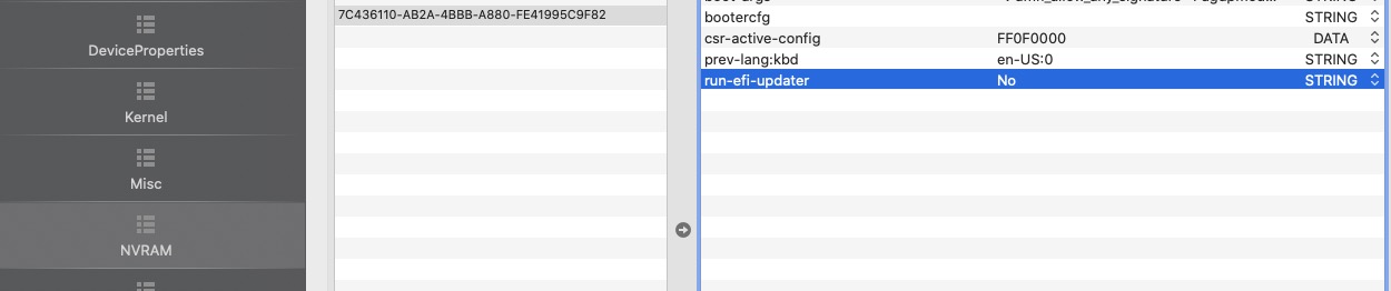

Did you put this option in your Opencore config.plist?
I was able to check this on the config.plist of my USB key with my MacBook Air and the "run-off-update" is set to no

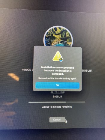

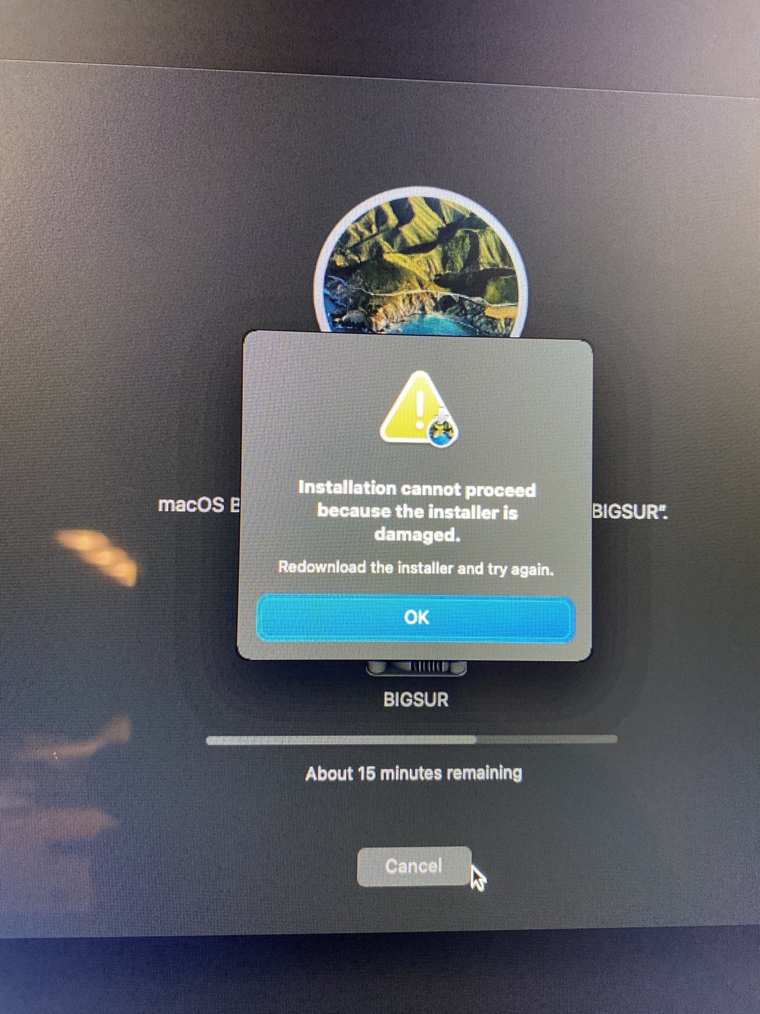

Hello, can someone help me? Third download, third USB stick, Big Sur 11.0.1, IMac late 2012. What's wrong with that? Thank you
Until the real help gets here, tell us what version of micropatcher you are using. Also since it looks like you got at least past the first phase of the install sequence, tell us what step the install shows the failure. Lastly, can you write out the exact terminal commands you used in preparing and patching the installer? Thanks.
Hello. Just the fourth time. So, download Big Sur from the forum. Then created the usb stick with createinstallmedia. Run Micropatcher 0.4.4. Install Big Sur. No error messages until then. Then comes this error message.
