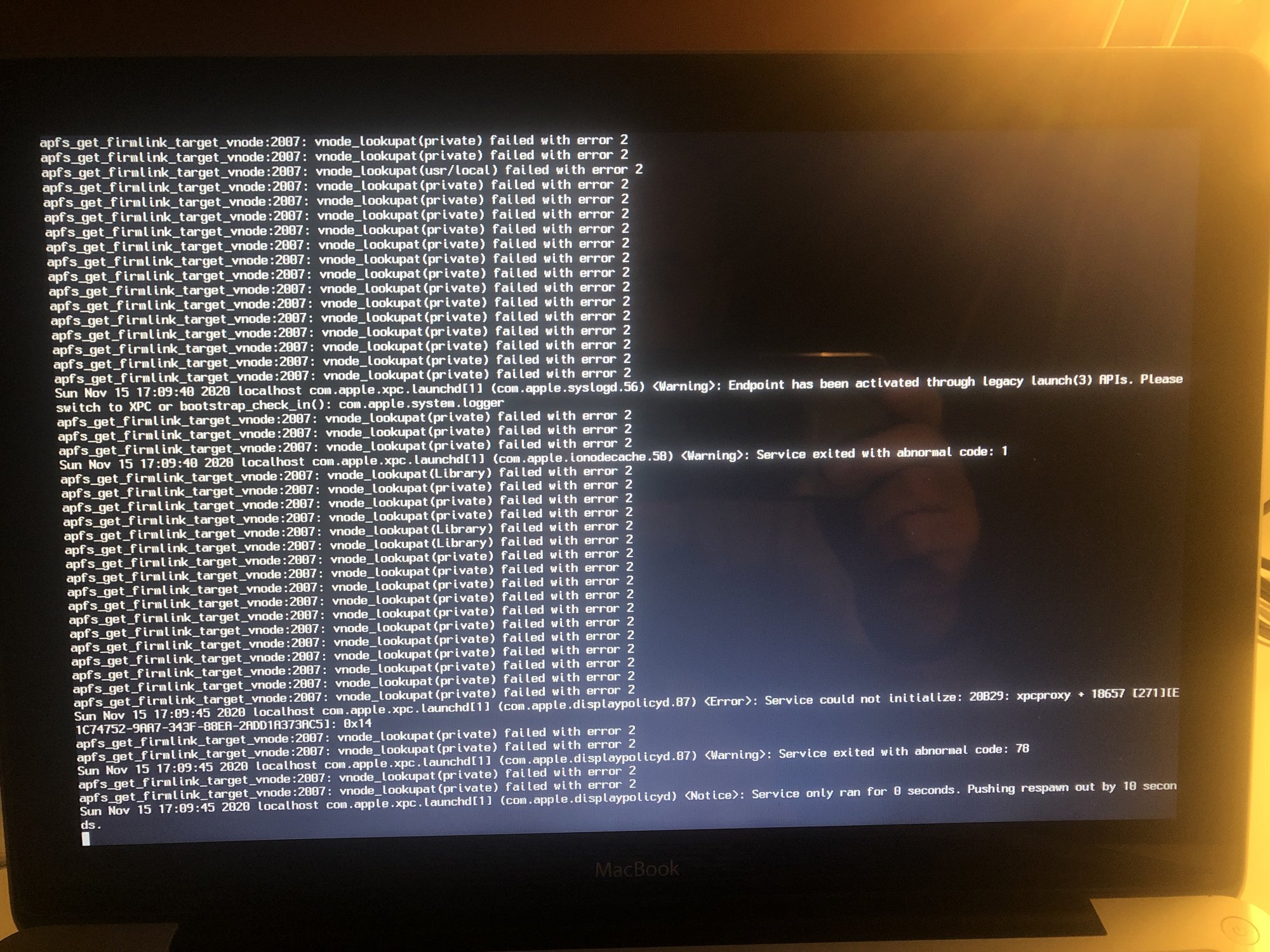

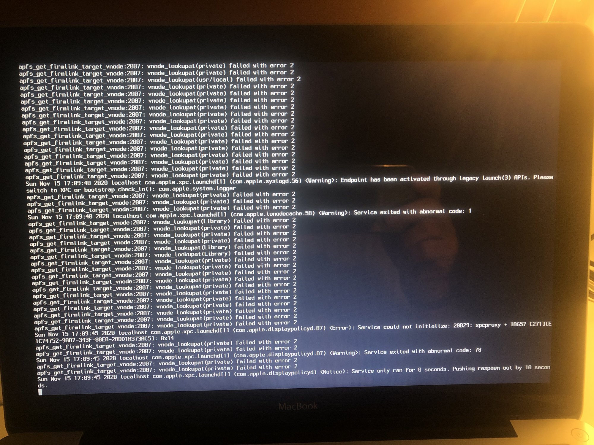

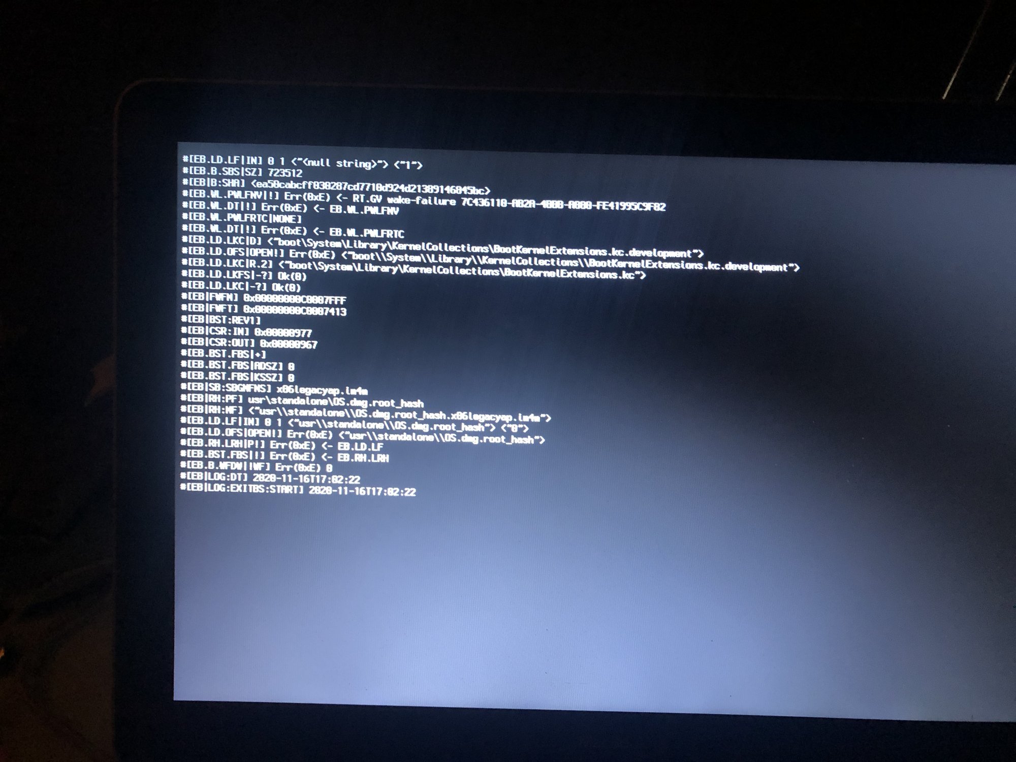

That ARV (Authenticated Root Volume) message:
Can't use last-sealed-snapshot or create-snapshot on non ARV volume
is really weird seems that the stock snapshot created by installation (that means stage3 installer completed properly) is locked, but meanwhile try this:
"BigSurfixes disable snapshot", "BigSurfixes delete snapshot" and try rebooting (even with ARV error) BigSur .
If this still produced that "ARV error" without desktop booting, then boot Mojave or Catalina and send the output of this: diskutil info /Volumes/YourBigSurLabel | grep Sealed
(you should type that diskutil info /Volumes/YourBigSurLabel also from "BigSur recovery environment", if you get Seal "Broken" that installation of BigSur is sealed and hasn't completed properly)
If none worked, then I suggest to boot the "BaseSystem fix Installer" through OpenCoreAPFSloader4b, and then apply "BigSurfixes opencore preboot" and try booting through opencore the "Big Sur" disk .

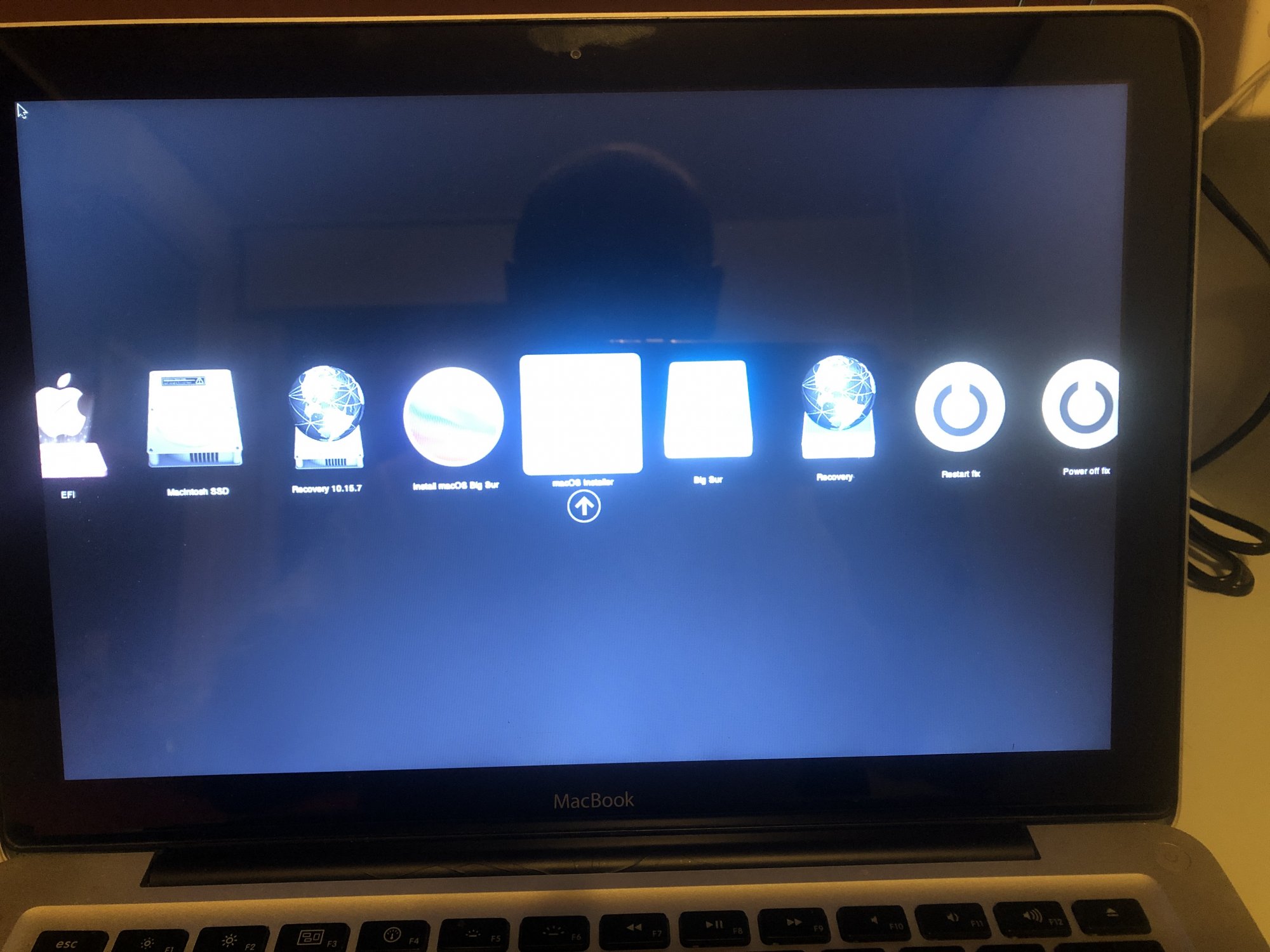

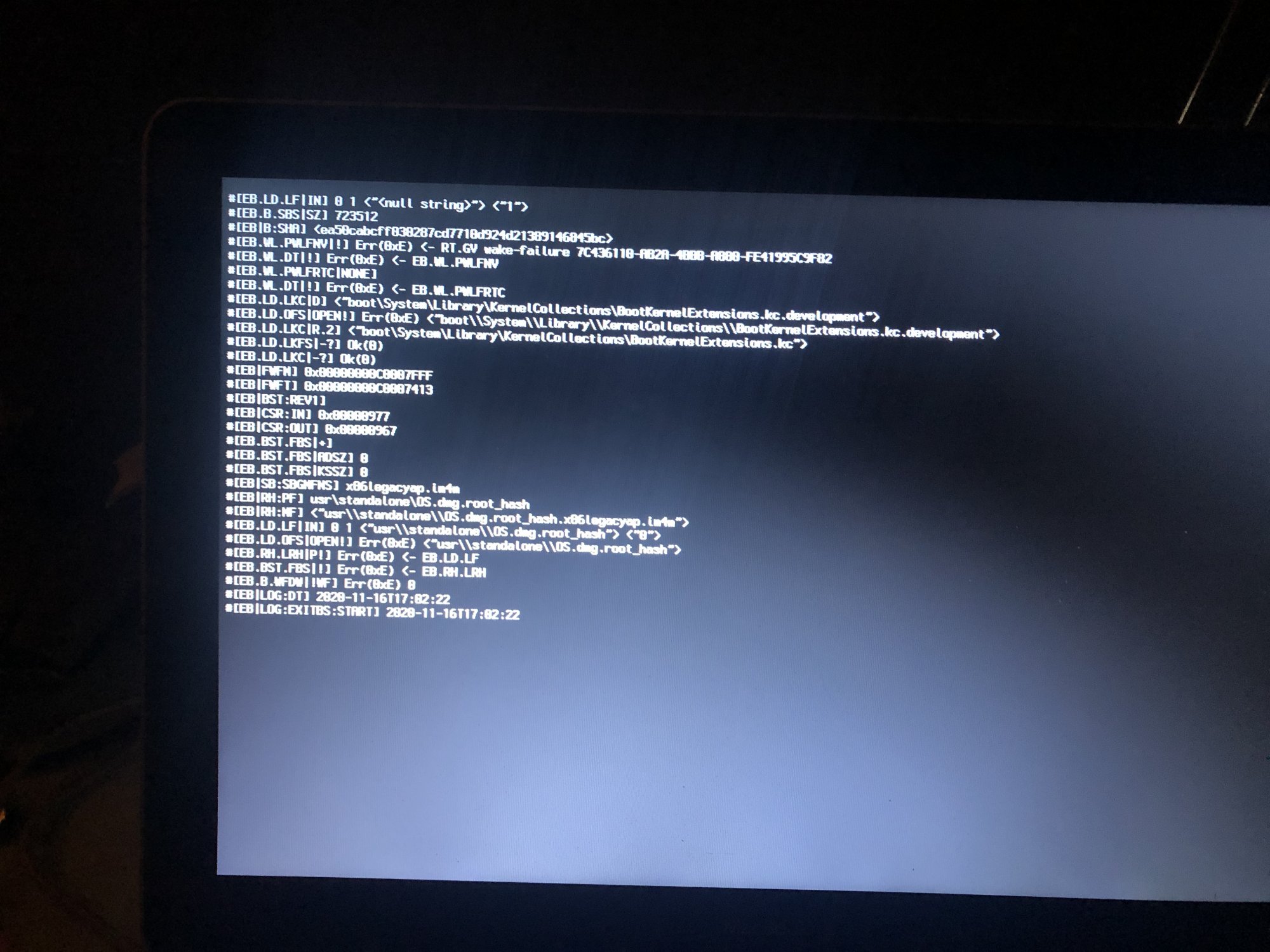

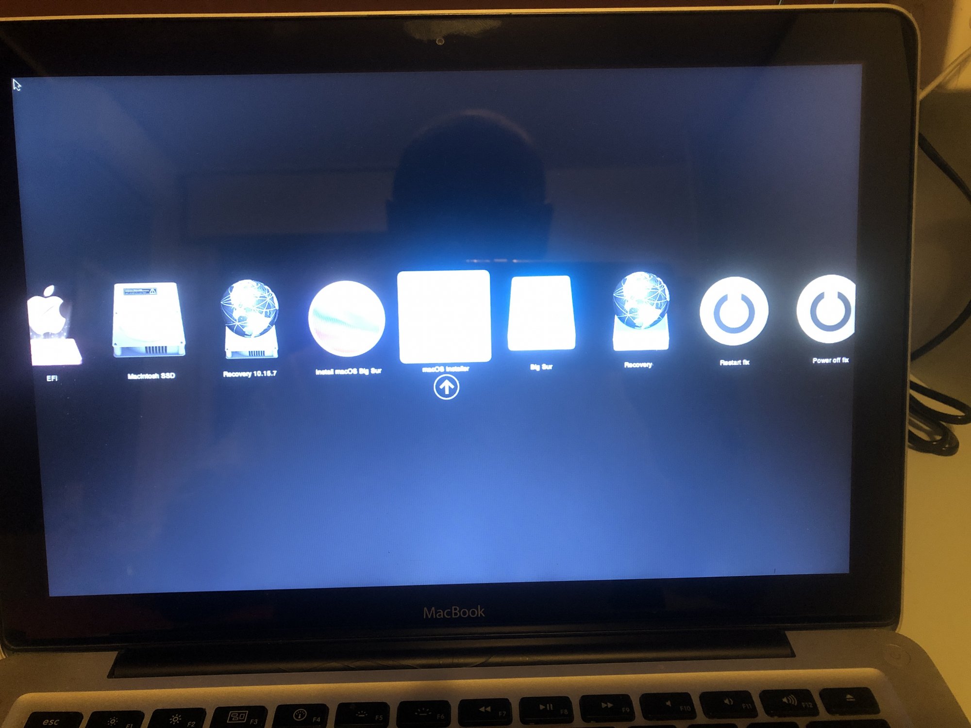

Disabling and deleting the snapshot worked, I had no snapshot and the reboot was still bootlooping (see pic 1).
The diskutil info returned: Sealed:No.
So I tried opencore reboot fix. The system restarted very quickly. You can see the CMD+S output in pic 2.
The odd thing is that rebooting thru OpenCoreAPFSloader4b the MacOS Installer is still present.

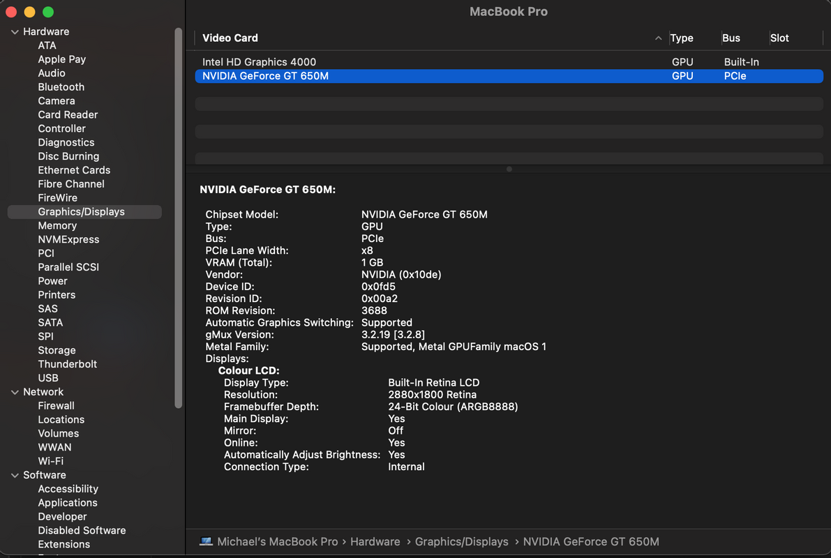

If your display card in your mac is not metal then you will face issues of acceleration. This is also mentioned in first post. Bigsur is only compatible with metal GPU
I did read that info, but am none the wiser as I can’t find any info on whether the GeForce GT 755M still supports metal. Google got me nowhere.
It claims to in system preferences.
Have a look in system information or Apple - About this mac - system report
I have a 2012 rMBP and graphics is either HD4000 or Nvidia GT650M and that seems to be Metal compatible.
I'm wondering if the M at the end of its name is a clue?
Are you installing an internal SATA disk or external USB disk, and do you used as target installation an HFS+ disk or APFS container ?
If you could try a SATA internal installation (this doesn't required stage2 and stage3 installer fix) it should work on that machine, then from BigSur recovery environment you could easily clone that installation to external USB , the main required fix after bootloop is "BigSurFix Legacy USB patches".
I am enough sure that also I fixed that apfs_get_firmlink_target_vnode ( @Ourkid and @telepati could confirm that ), but I need more testing on that stage3 installer when target is an external legacy USB host device.
You should use as target disk (for the stage1 installer) an already converted APFS container, possibly erasing it from Mojave or Catalina (that use their earlier apfs driver version), because the new BigSur apfs driver during conversion from HFS+ to APFS could made some incompatible modification to the Data Volume file system.
