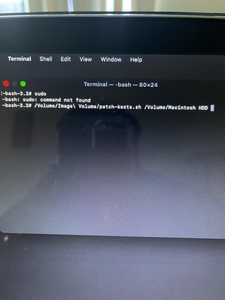

When ever I try to do nexts patch at the end I get this these are the things I’m doing can someone help
on the installed big sur plug in your patch flash drive open a terminal from the flash drive put patch-kexts.sh wait for it to install restart in my case double shutdown now everything works

This may not be your problem, but I have had issues with some usb drives. You may want to try a different usb stick, format it as GUID, and try again. Good Luck!
Reactions: TimothyR734
I‘ve used two different USB sticks, formatting them multiple times as GUID, with the same error each time 😢

Very strange - I have used Barry's patcher multiple times on 2 different mac mini 2012 machines and never had a problem like that. The script is pretty straight forward - it contains
# Make sure there isn't already an "EFI" volume mounted.
if [ -d "/Volumes/EFI" ]
then
echo 'An "EFI" volume is already mounted. Please unmount it then try again.'
echo "If you don't know what this means, then restart your Mac and try again."
so the shell thinks you *do* have an EFI partition mounted at that point.
If you go into Terminal right after you get this error and issue
ls -l /Volumes
what does it return?
An alternate possibility would be to try the following in Terminal:
sudo nvram boot-args='-no_compat_check'
and see if that will let you reboot into the usb installer w/o having to use the efi partition to set the nvram. If you are already on Big Sur you probably shouldn't need to set it again, and if you are not on Big Sur you should be able to set it in the terminal.
