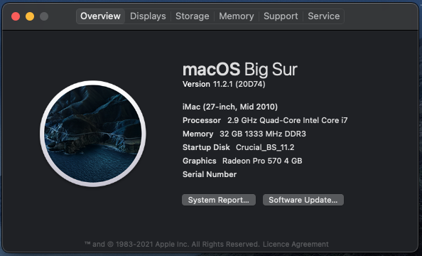

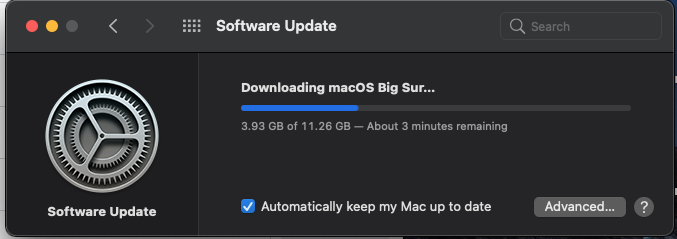

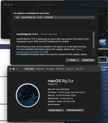

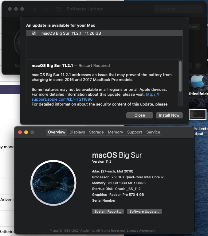

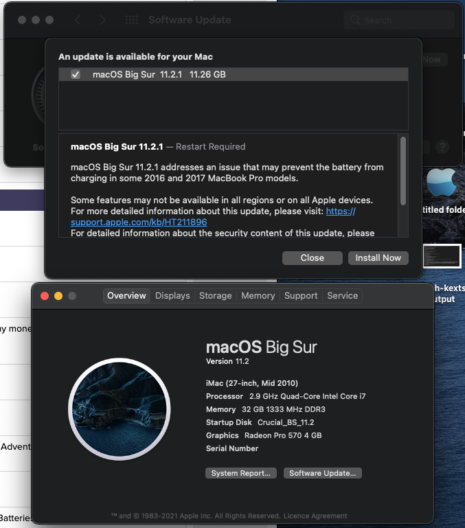

It seems the 11.2.1 OTA update can be installed directly with no need for the full installer.
I was running BS 11.2 with OC and Software Update showed me an update.

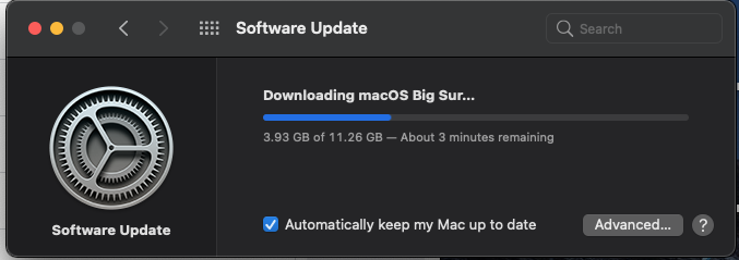

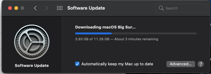

So I downloaded it and proceeded to install.

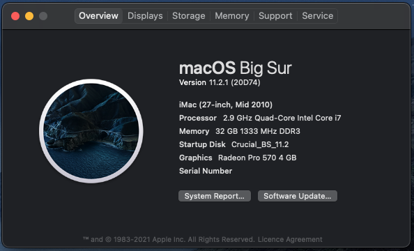

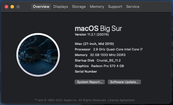

It took a bit of time to download and install with a few reboots, so much so that at some stage I was worried that it hanged. But with patience, the final OS is up and running without intervention.
I needed to patch the system again by running the patch-kexts.sh script on the Install macOS Big Sur USB stick, previously prepared for Big Sur installation, to re-enable all the hardware functions - Internal Sound, Wifi, BT, Ethernet, USB, Night shift, Sleep and brightness control, GPU HW video acceleration and DRM support of TV+ channel.

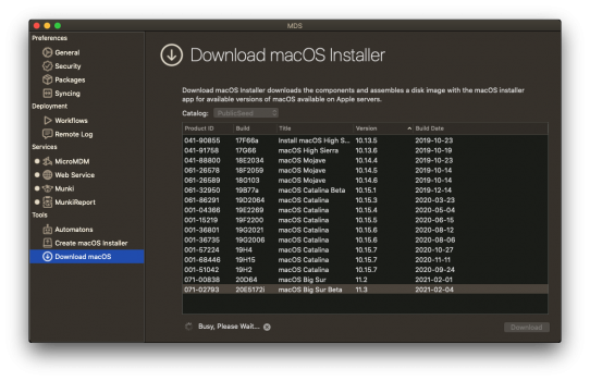

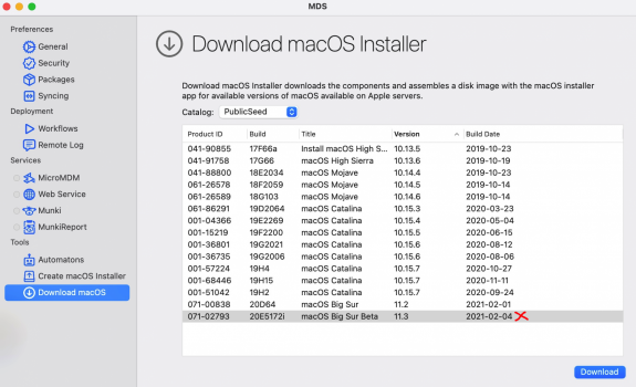

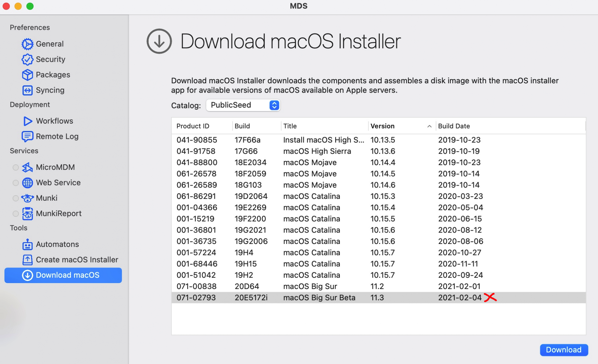

It seems that Big Sur 11.3 beta is available as an InstallAssistant.pkg; 12.38GB download.
http://swcdn.apple.com/content/down...j4siym3d0yvfgaauy2qdv8fn/InstallAssistant.pkg
The sucatalog info is:
Code:
1. macOS Big Sur Beta 11.3 (20E5172i)
   - 071-02793 - Added 2021-02-04 21:12:13
Apologies if this was already listed. Also, I'm not sure if this beta has the CVE-2021-3156 Heap-Based Buffer Overflow in Sudo bug patched. MrMacintosh says it is updated to sudo version 1.9.5p2 in the new BS 11.2.1 update.
Interesting that 20E5172i only appears in the 'public' version of the sucatalog and not in the developer!

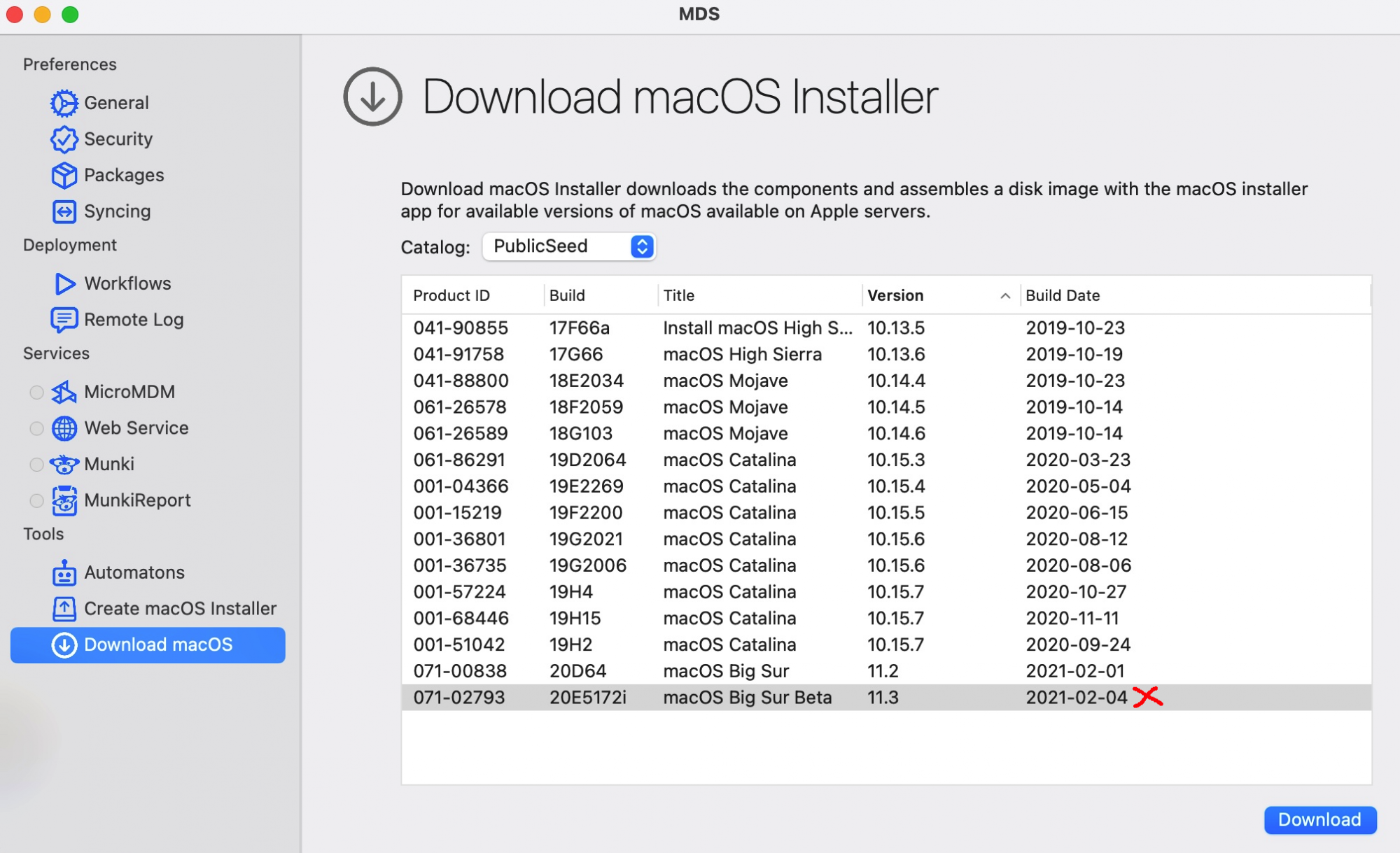

Thank you for the hint. Downloading it now via MDS, public seed.
Reactions: Pinarek

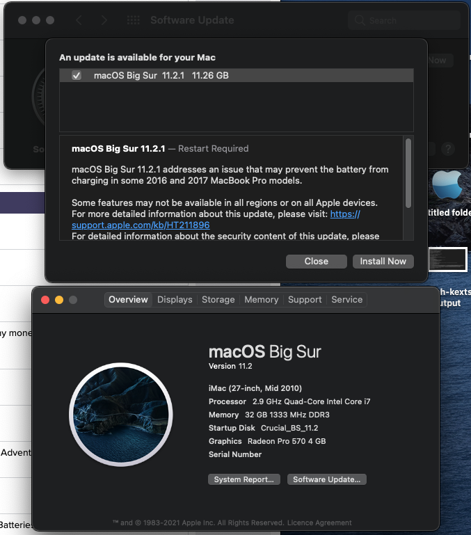

This was a (hidden) full installer OTA - the real delta OTA was less than 3 GB.

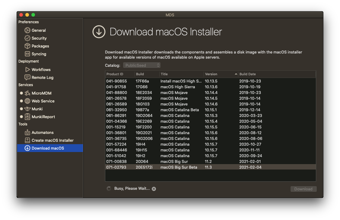

@buckrock yes you are right, but why does the 11.3 Beta1 ONLY appear in the public seed?
see my picture
Update: Sorry had seen too late that @hvds had already loaded a picture
