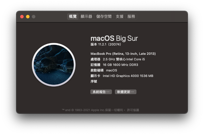

37-minute OTA update of macOS 11.2.1 (20D74) for MacBookPro9,2 with OpenCore 0.6.6
Reactions: Ausdauersportler

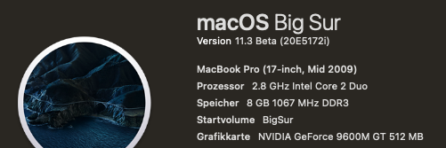

It seems that Big Sur 11.3 beta is available as an InstallAssistant.pkg; 12.38GB download.
http://swcdn.apple.com/content/down...j4siym3d0yvfgaauy2qdv8fn/InstallAssistant.pkg
The sucatalog info is:
Code:
1. macOS Big Sur Beta 11.3 (20E5172i)
   - 071-02793 - Added 2021-02-04 21:12:13
Apologies if this was already listed. Also, I'm not sure if this beta has the CVE-2021-3156 Heap-Based Buffer Overflow in Sudo bug patched. MrMacintosh says it is updated to sudo version 1.9.5p2 in the new BS 11.2.1 update.
Interesting that 20E5172i only appears in the 'public' version of the sucatalog and not in the developer!

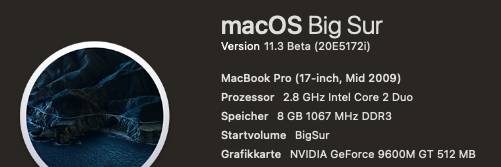

11.3 beta on an MBP5,2. Installed over 11.2 release on external SSD with jackluke's method as in post #8,686 .

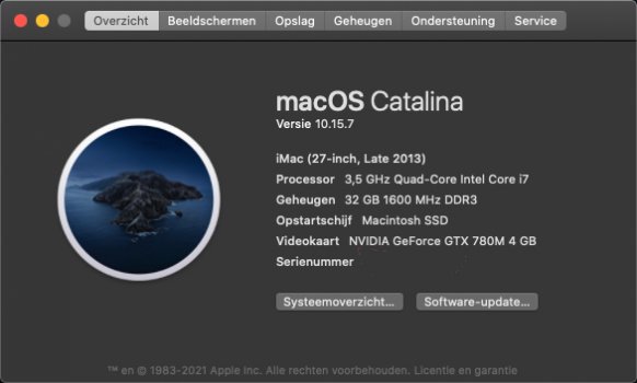

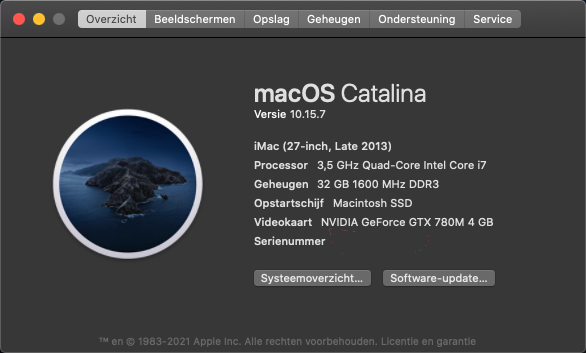

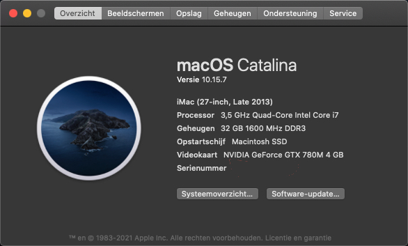

Hello,
First of all, tnx for the hard work!
I have read the first topic complete and I wanted to ask a question.
I have a beefed out iMac late 2013 (best proc, gpu, ssd (no fusion), etc.)
When reading the first topic, I think option 4 is the best, with that I get future updates.
But since it's option 4 and not 1 :) I wanted to ask why option 4 is not option 1 and what am I missing here :)
Should I choose another option?
Greetings,
Richard

Hello,
Greetings,
Richard
The list has been created in historical order. There is no technical order. All options have their right to live in this ecosystem. It all depends on where you start, which system you own, what needs do you have.
You have to understand the implications of using the OCLP vs. classical patcher options yourself. You will carry the burden yourself, too.
Start reading the thread post from mid Dezember 2020 about getting OTA upgrades, accidentally overwritten firmware and other problems and features.

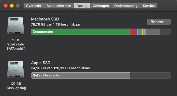

Hello, First of all, tnx for the hard work!
But since it's option 4 and not 1 I wanted to ask why option 4 is not option 1 and what am I missing here
Greetings, Richard

Thanks for the explanation, I did not know the concept of OpenCore .. I wanted to try it but after reading your message I will always use MicroPatcher which I find very simple and congratulations for the Italian proverb, you could not have chosen a better example.
I have just updated my MacBookPro10,2 to Big Sur 11.3 beta 1 (20E5172i) using ... @cdf's method from the thread OpenCore on the Mac Pro!
If you've upgraded your hardware to be 100% Big Sur compatible, then this only requires their basic, clean OC config plus their 'hybridization' (i.e. board-id spoofing) settings. If e.g. you had a machine similar to mine, but without an upgraded Wi-Fi card, you'd need to know how to add the Broadcom Wi-Fi patch to your OC config too.
But ... the micropatcher really (really!) does change the operating system - it patches it - permanently! With OC it's different, it does not work by changing (patching) anything permanently on your Mac, it works by 'injection', i.e. only if you start it it changes things in memory only, and as they are loaded. Yes it comes from the Hackintosh world, but all of this including what's in the micropatcher (kexts, patches) comes from and is used by both worlds - it's all about using macOS on unsupported hardware, after all!

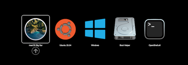

You'd probably just want to turn on the OC graphical bootpicker once you've got everything working (again as per their instructions) - and maybe turn on the lovely 'Modern' OC bootpicker style, which I've only just discovered! :)
