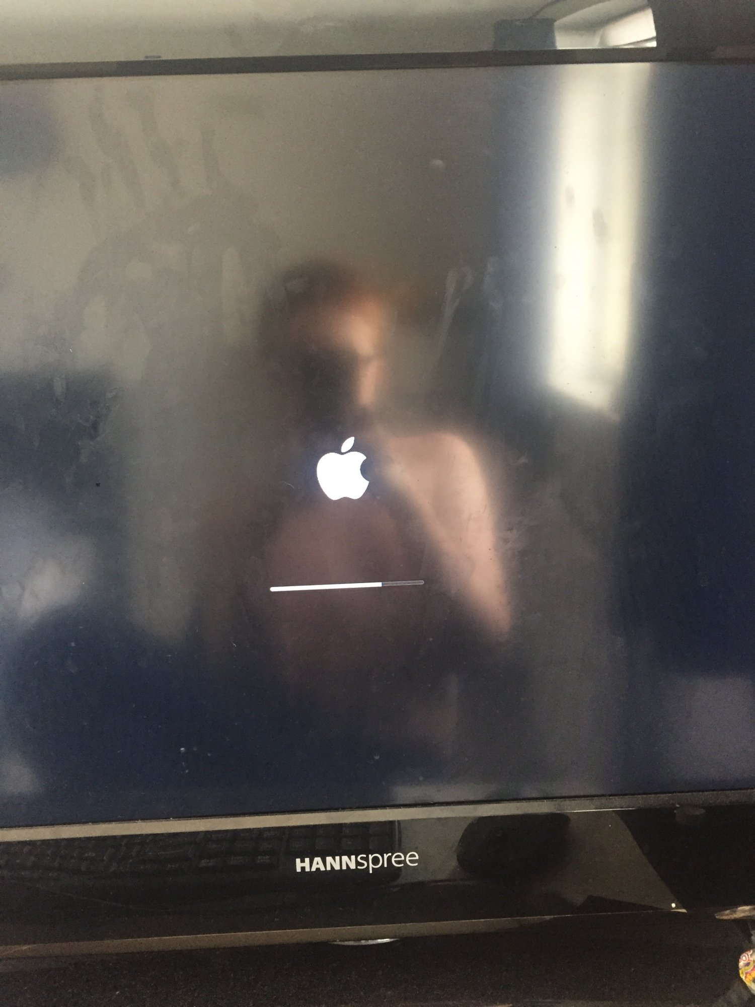

With your instructions... See the image: the Big Sur its frozen on the loading screen.
Thanks for your help!
Reboot to the USB BigSur Installer then and copy back the stock BigSur Wifi kext (otherwise you need to re-install):

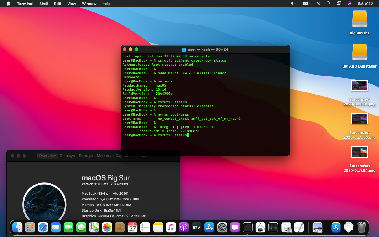

I guess ASentientBot refers to csrutil authenticated-root disable from an USB BigSur Installer recovery terminal.
Anyway I still can "sudo mount -uw /" (and mount BigSur System from HighSierra) even with that value enabled (I haven't neither disabled it from bigsur recovery after install).
