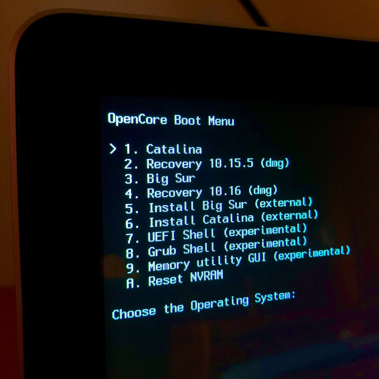

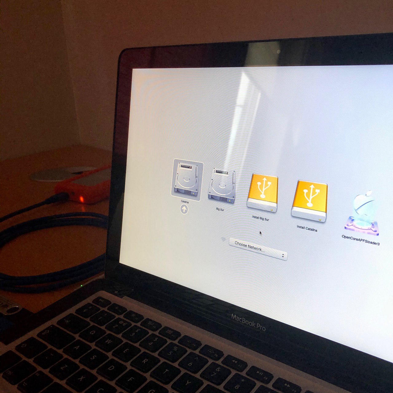

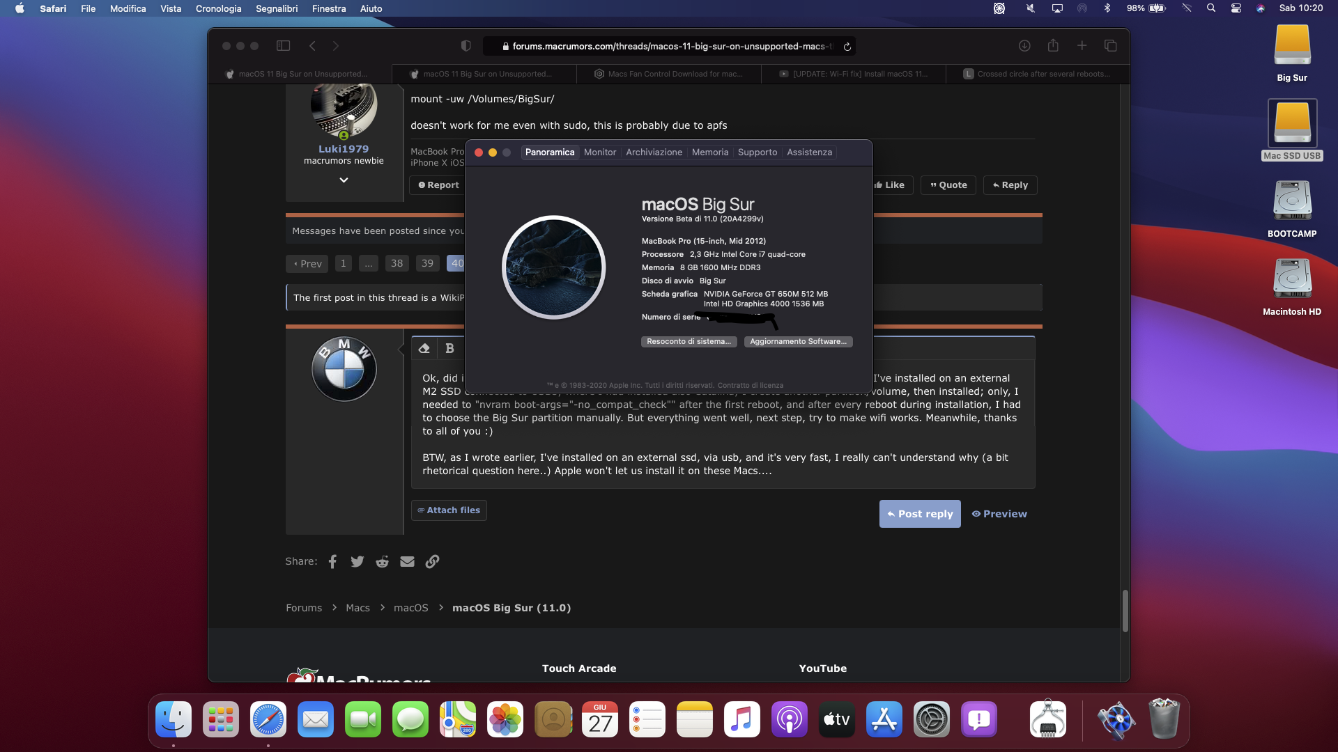

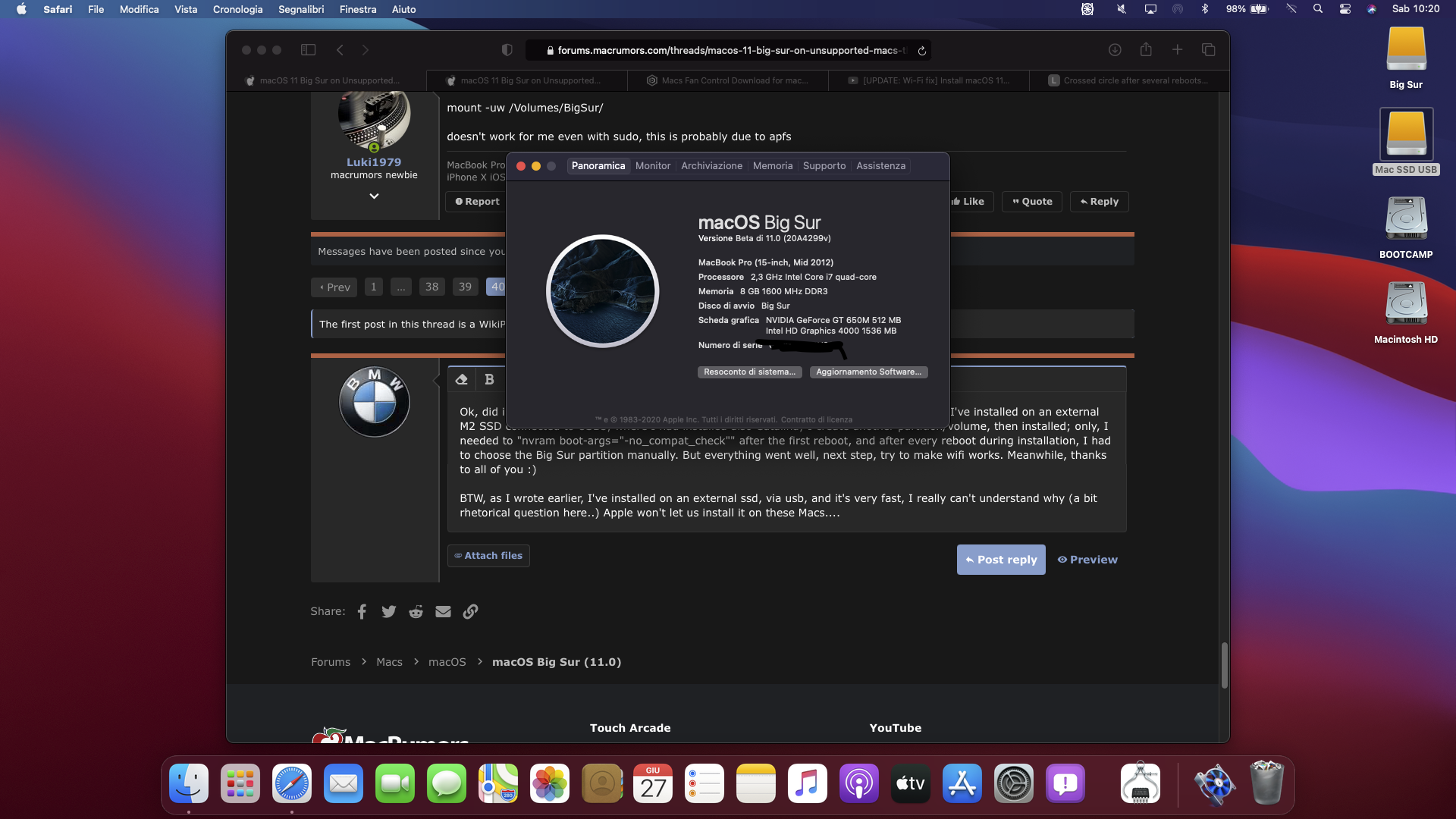

Ok, did it! Following the YouTube guide by @GameRoof , on MacBook Pro 9.1 it works well. I've installed on an external M2 SSD connected to USB3, where I had installed also Catalina; I create another partition/volume, then installed; only, I needed to "nvram boot-args="-no_compat_check"" after the first reboot, and after every reboot during installation, I had to choose the Big Sur partition manually. But everything went well, next step, try to make wifi works. Meanwhile, thanks to all of you
BTW, as I wrote earlier, I've installed on an external ssd, via usb, and it's very fast, I really can't understand why (a bit rhetorical question here..) Apple won't let us install it on these Macs....

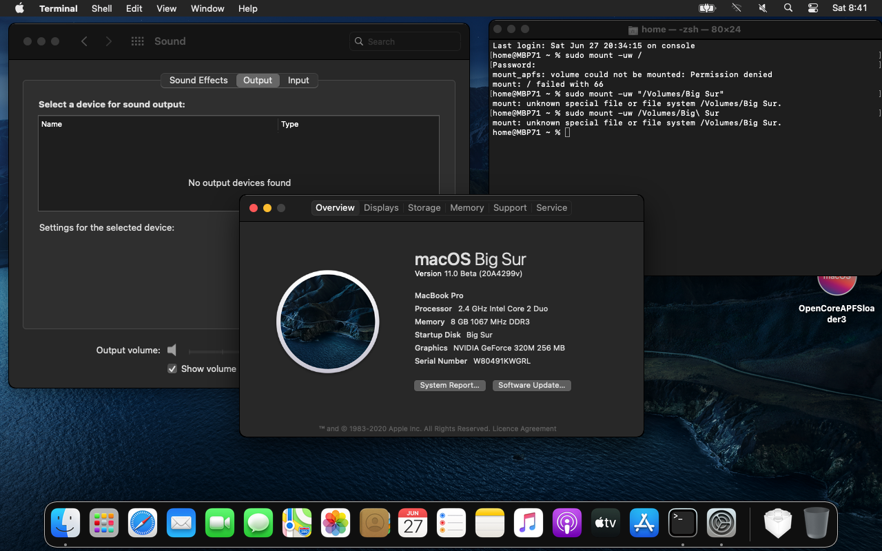

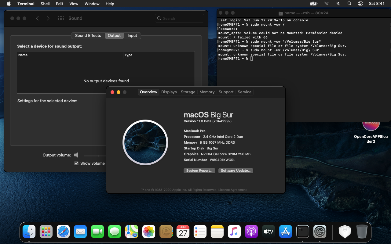

unknown special file or file system /Volumes/BigSur.Are you getting "Failed with 66" Error?

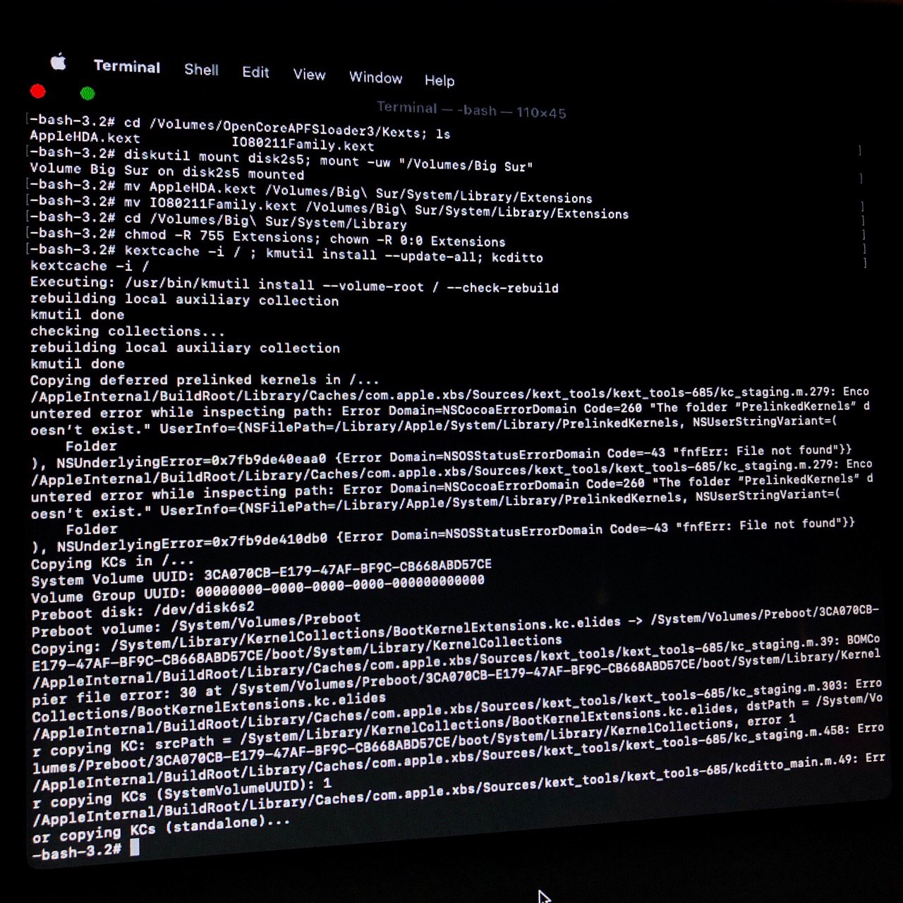

open a BigSur terminal and type:
Code:sudo mount -uw / ; killall Finder open /System/Library/Extensions/ replace from Finder in that path the IO80211Family.kext and AppleHDA.kext
return to terminal continue typing
Code:sudo -s chmod -R 755 /System/Library/Extensions/ chown -R 0:0 /System/Library/Extensions/ kextcache -i / (this is required to update the prelinkedkernel) kmutil install --update-all (this is required to update the BootKernelExtensions.kc) kcditto (this is required to copy both the "kextcache" to the APFS Preboot)
at next reboot both should work on unsupported BigSur Mac.
kextcache -i / ; kmutil install --update-all; kcditto
. I think there were some errors copying the kexts to Preboot. Maybe should've specified kextcache -i /Volumes/Big\ Sur/

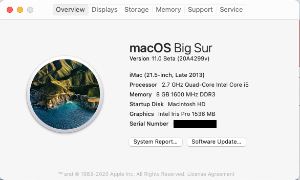

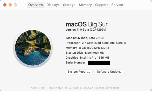

Is there anyway when you get a chance if you can explain or post the links of the steps that you used to get this working. Thanks, PayneLate 2013 21" iMac.
Everything works... WiFi, my third party SSD (Samsung Evo 860) and no issues with HW acceleration for the graphics.

Big Sur system volume would not mount as writable.
Commands executed successfully untilkextcache -i / ; kmutil install --update-all; kcditto
There's nearly 50 lines of output. I just showed it in case the errors are important; could be irrelevant.

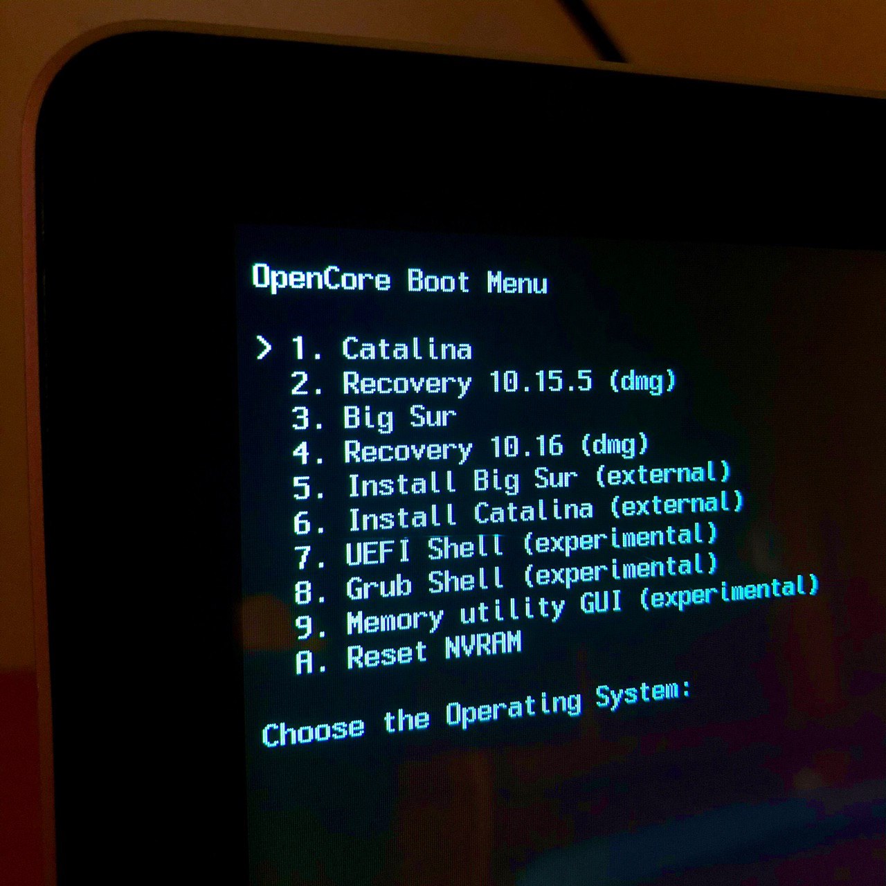

diskutil list
locate your USB external EFI on diskX (where you installed usbopencore)
sudo -s
diskutil mount diskXsY
cd /Volumes/EFI/EFI/OC/Drivers/
mv OpenCanopy.efi OpenCanopy2.efi
diskutil unmount EFI
Do you also have a 2013 imac?Second that, I want my wifi back again, not going to read/search 41 pages, if someone figured it out then take the time to update Post number one, it's A Wikipost, anyone with the right permissions can edit the post.
Sounds good.Nope, 2012 Mac Mini.
