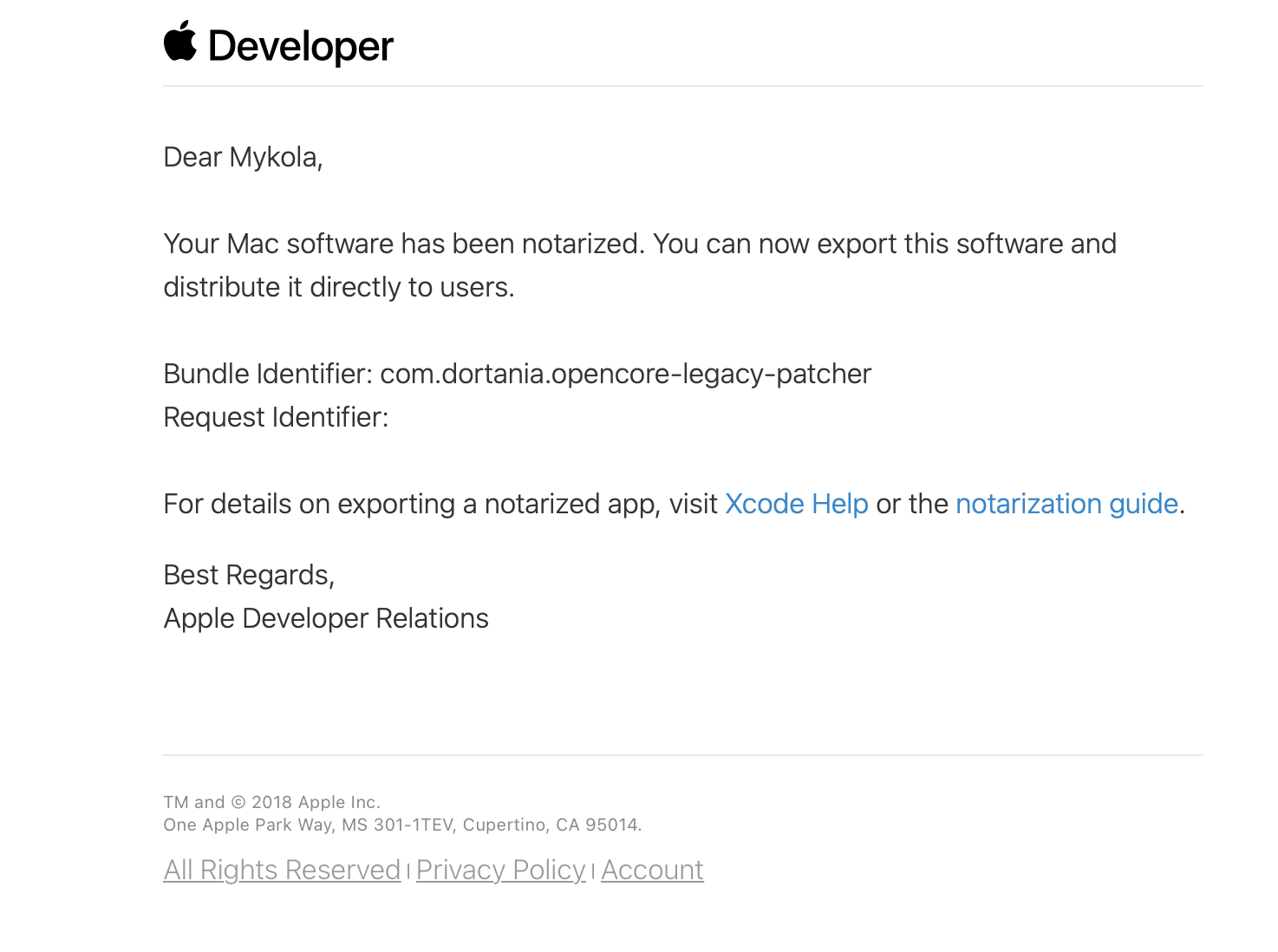

Actually we do sign it! I get an email from Apple every commit to Github, as we sign all binaries on Github Actions:

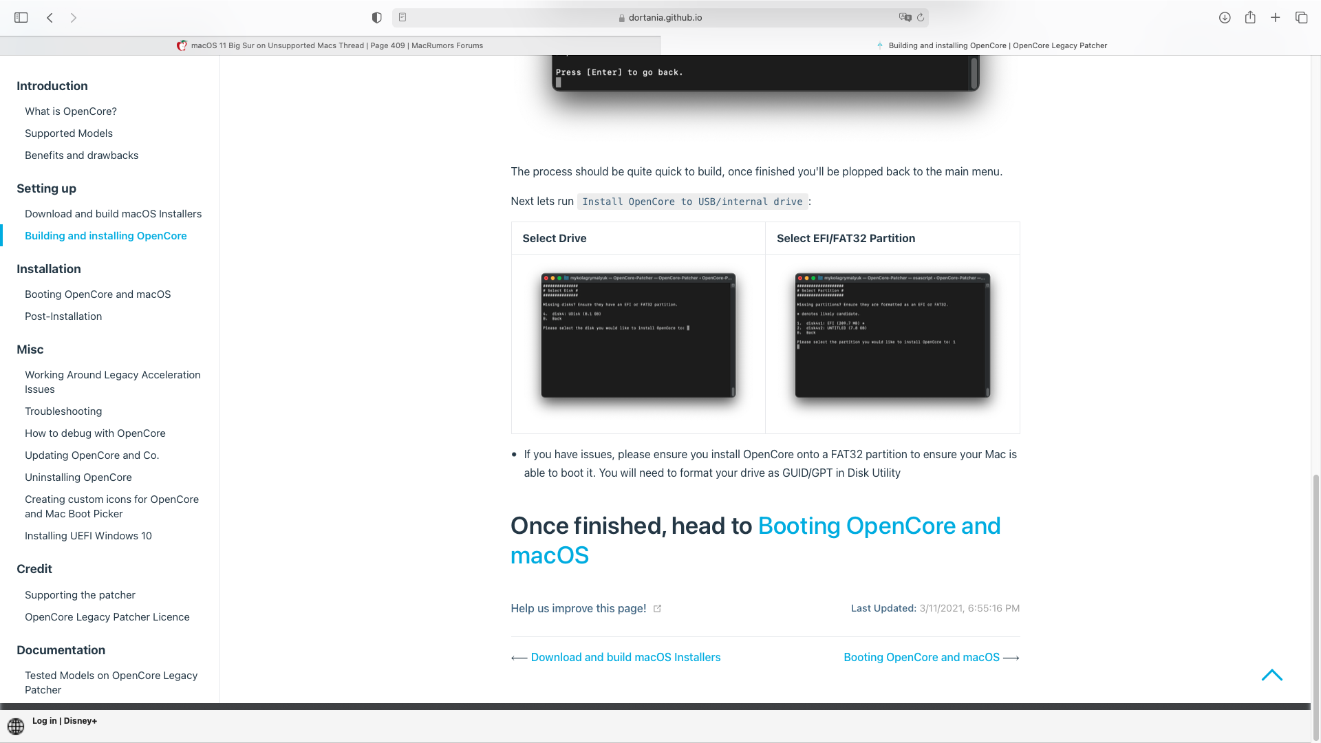

not understand in "building and installing" step.
how to format disk to fat32 ?
I want to do clean install so need to format drive to fat32 ? and how ?

Ok, let's go over some basic things.
1. Your mini is currently running what version of macOS? Catalina? Mojave? Do you have a time machine backup?
2. You have a USB stick ready? 16GB or more? Erase and formatted the stick to macOS Extended (Journaled) and GUID?
3. Downloaded Big Sur? Maybe 11.3 or 11.3.1?
4. Created the bootable installer of Big Sur onto the USB stick?
If you don't understand these basics, I think you should stop and instead get help from a friend with more Mac knowledge...

1 my mini is in Big Sur .using Patches Sur.
2,3,4 all i know.
No idea why anyone would want to install Big Sur on unsupported machines, other than for the cool technical aspect of it. It runs terribly on my officially supported Early 2015 MBP and I ended up downgrading back to Catalina.
ahm im running Big Sur on my mid 2011 21.5" iMac and its runs very smoothly. did u install BS as update over Catalina or u made a fresh install? also wat size of ram do u have?
2,3,4 all i know.
Ah, so you are already on Big Sur using another patcher and you want to switch to OCLP.
See my earlier post on switching to OCLP.
Still not sure exactly what problems you are having...
Maybe you are unsure on installing the OCLP onto the USB stick's EFI ???
Just follow the steps in the official guide.

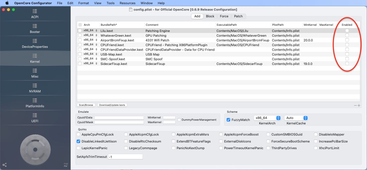

Hello! I would like to ask a question. I have an iMac14,2 which is said to be fully Big Sur ready and therefore cheat the installation it's enough. At this point I said to myself: "Why not disable every additional Kext module in OpenCore EFI Build? (Lilu, WhateverGreen, etc ...)" To do first I used OpenCore Configurator. I deactivated all Kext modules (see attached image) and I see that everything works fine after restarting my 27 '' iMac (Late 2013 - i7 - Nividia GTX 980 4GB). Did I act badly? Are there any aspects that I ignore and for which the additional Kext are essential? Thank you
An additional question for any nerds who may have already addressed and solved this problem; thanks.
I add that I am making a lot of attempts with EFI, since I do not resign that "Photo Booth" works badly (it appears with a black screen and only two effects appear), while it works very very well restarting the Mac in Safe Mode. From the Log I seem to understand that in Normal mode the internal iGPU (it sees it as HD5000) don't uses the OpenCL library but Drivers and Plug-In that cause some conflict.
- If the Mac boots in safe mode, Photo Booth works very well and its Log says it only uses these Open CL libraries:
Code:

I cannot really believe to asked this question. The most extensions names are speaking, so let`s check them out:
- Lilu/WhatEvergreen: needed for GPU patching, in your case most likely using the vit9696 to enable external display ports and avoid black screen on boot (which does no occur in every case, can only be detected if used)
- AirportBrcmFixup: likely enables continuity and handoff with your system (can only be detected if used)
- CPUFriend and DataProvider: enables correct CPU boosting on load (can only be detected if used)
- USB-Map: enables all USB ports and all functionality like charging as before on your supported macOS version Catalina (can only be detected if used)
SMC-Spoof: set a high version number of the SMC software to avoid unwanted SMC updates coming in with new Big Sur updates (Big Sur installers believes to run on iMac15,x and will try to apply updates according to this)
SidecarFixup: since you own a HD4000/HD5000 (metal capable iGPU) you can now use SideCar with an USB connected SideCar capable iPad (can only be detected if used)
In fact you turned off every security and feature enabling extension just to get Photo Booth running. Well done.
About the Photo Booth and save mode:
From the dying ATI cards in iMac11,x and 12,x we know that running the save mode disables OpenCL/OpenGL acceleration and one could use the half dead card until it breaks completely.
Your experiment shows that something in the Big Sur versions of the Kepler related extensions breaks the Photo Booth. This can be an unknown Apple bug (do we know if the same thing happens on the last supported Nvidia based machines?), but this can also be the result of an intended code change for future macOS updates and releases. NVIDIA cards will be likely dropped on the next major release?
(IMHO) One can only fix this by patching back the Catalina extensions as it is currently done with the unsupported GPU types. This would break the OTA upgrades.
About OpenCore Configurator:
While being easy to use it is known to break sometimes the validity of the config files generated. The current consensus is to use Xcode or ProperTree to edit config.plist files. In any case make backups before touching config files with this program.
About the iMac14,2 and being fully Big Sur ready:
Nobody claimed this. From the past experiences we found out that nearly everything may work on Catalina supported systems without major patching. You already can see from the list of extensions used with OC above that your system is not fully Big Sur ready.

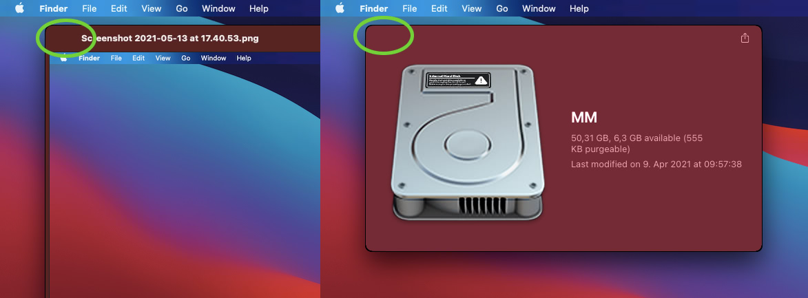

Is it only me, or are others as well have the close and resize buttons missing on the top left edge
of Quick Look windows? (Big Sur 11.2.3 with OCLP 0.1.2, MacBook Pro 2008 with non-metal gpu)
Clicking where they normally should appear does work, though.
(resizing and closing behaviour of the window is as expected)

  • WhateverGreen.kext
    • Kext used for patching graphical portions, macOS hardcodes display outputs, DRM and such to SMBIOS models and thus we recommend them to all users to avoid edge cases such as external monitor support as well as failing to wake display from sleep
  • CPUFriend.kext + CPUFriendDataProvider.kext
    • Kext used for reinjecting power profiles. Required as since we spoof a different Mac, incorrect power profiles are applied
  • USB-Map.kext
    • Kext used for defining USB ports. Since we spoof different Mac, need to ensure USB ports are still mapped correctly
  • AirportBrcmFixup.kext
    • Edge case to patch Airport cards that suddenly reduce speeds even on native models. This issue is exhibited on supported models in Big Sur, we're just working around an Apple bug
Hope this clarifies, we respect kernel space resources and would not inject kexts unless they're used to fix issues or add functionality.
A. Try to shut down the system once completely and do not touch or start from the internal HDD holding the old Sierra installation. This should avoid the signature problem.
B. Try on 3. pressing CRTL when choosing the „EFI boot opencore“ to make it the standard boot selection on reboot automatically. This way you can watch the installation unattended. There will be only text shown during the boot phase if you choose the verbose boot mode within the OCLP app. Now you get an idea why watching videos does not replace reading docs.
C. You did not create a APFS partition to install Big Sur in advance? From your photos I cannot see which USB partitions you are planning to use to install Big Sur onto? Make sure to start the disk utilities from the Big Sur installer and prepare a APFS container to hold the installation. Name it Big Sur?!
D. Resetting the PRAM kicks out OpenCore - without you cannot install or run Big Sur.
E. Use 11.2.3 or older - it is known to install without any problems and race conditions. You can update later on when you are familiar with your system and can survive failing installations.
I manage several systems like yours and have never seen this problem before.

Sorry to disagree... On my iMac14,3 I also removed every kext (Even SMCSpoof for aesthetics on System Info, but would NOT recommend this particular one for security reasons regarding bricking the machine) and the iMac works flawlessly, just with no SideCar support as supposedly it would not have that anyways.
The iMac14,4 being fully officially supported and the MacBookPro11,x as well (The later for Nvidia Kepler GT 7xxM Microarchitecture) I myself also wonder why each and every one of those kexts are necessary for iMac's 14,x. Again, I have no problem using it myself and its my opinion (just an opinion) calling these iMacs "fully Big Sur ready" is not as heretical as it might seem ;ˆ) But I am also the first to admit I'm probably missing something here...
As I wrote before, you can detect issues only if you use the hardware. Go to the Github page, look at the issues tab, deselect the filter and search through the list of more than 200 issues raised. You will find at least one from an iMac14,x user.
Just because you cannot see a problem it does not mean there is no. Logic and mathematical proofs work slightly different: One counter example can negate an assumption. But a single positive example proofs nothing. I would call your post ego emperical studies using a different model which I did not mention at all.
Thanks for your time! But that was somewhat clear already. Still don't explain (IMHO) why Spoofing an iMac14,x to an iMac15,1 would REQUIRE those KEXTs. As I explained earlier, I am using my iMac flawlessly, including external monitors (mDP to DP 1440p and mDP to HDMI 768p) with no injected KEXTs. I don't know half of what you guys do, so I can't say why it is working in my case without the WhateverGreen kext. Regarding CPUFriend and USBMap, I'd assume it's perhaps because both SMBIOS relate to similar Haswell CPU's with similar (if not identical) USB controllers? Go figure.
And I've also tried changing the Spoofing from 15,1 to 14,4. Everything worked nice but HandBreak would miss its iGPU's QuickSync option.
I was just chipping in my experience. I did not detect any of the referred issues myself using an iMac14,3, which is very similar to the iMac14,2 of the original OKonnel's post, which by themselves are very similar to an officially supported iMac14,4, not to mention the iMac15,1 used by OCLP for Spoofing. If you think this experience should not be shared, OK! Talk about ego sir! Thanks for your time replying anyhow... Signing off.
