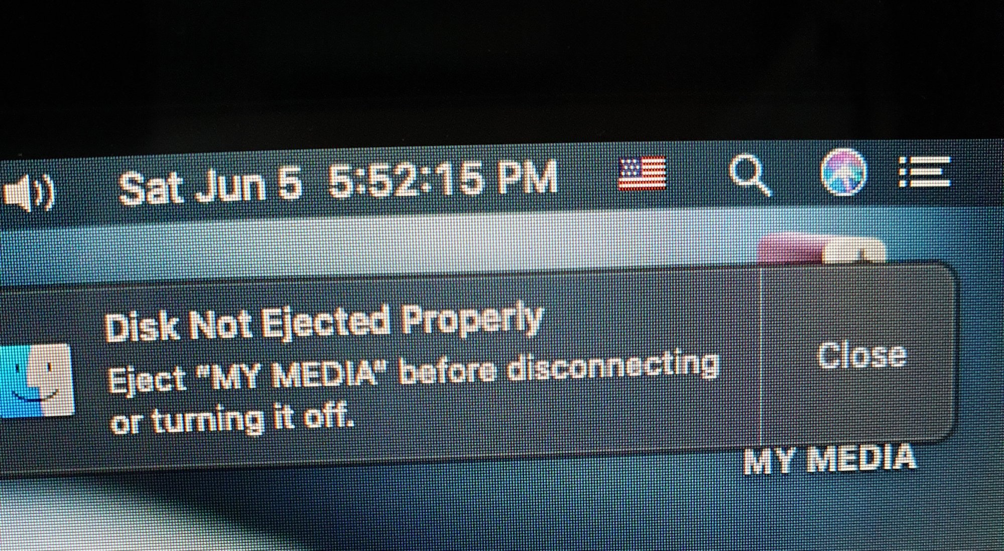

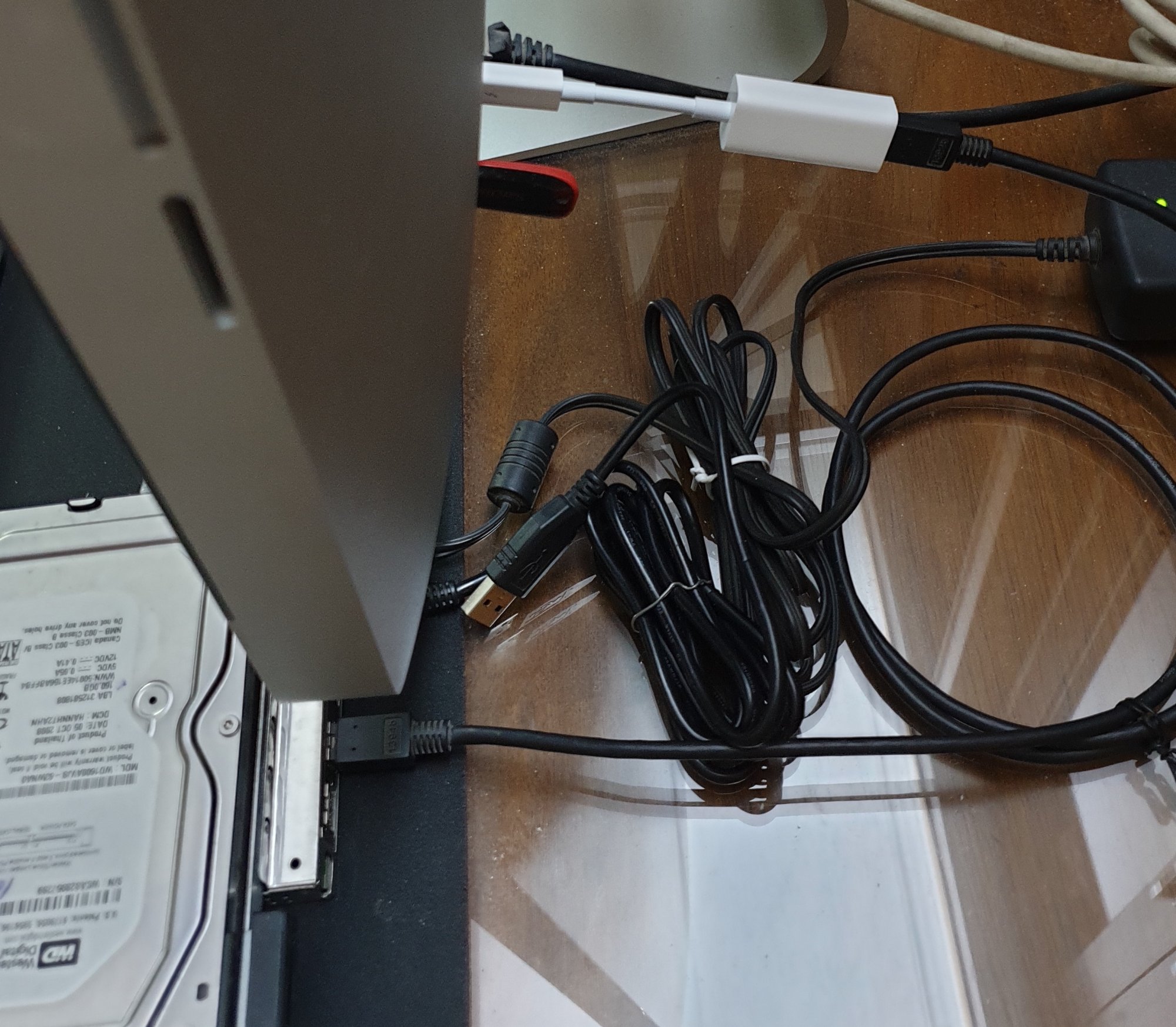

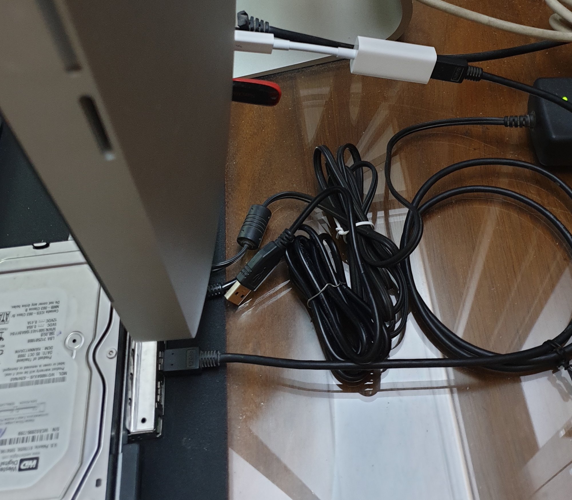

I have an issue. I am on BigSur . I have a 160GB hdd connected through Firewire 800 through Apple Thunderbolt to firewire adapter connected to the thunderbolt port.
Strangely the disk keeps getting ejected and mounted without any reason. This happens once a while not very often.
The disk is properly partitioned with Mac OS Extended Journaled with GUID partition. However, while connecting with USB 2.0 port there is no Issue.
I have currently daisy chained 2 Firewire 800 External 3.5 inch HDD(Self Powered through AC Outlet) through single Thunderbolt port on the iMac 27' inch and both drives show well on the desktop
I want to use the higher speed Thunderbolt port as it allows me above process and freeing my USB port.
Anybody having similar issue could provide some insights. Any solution would really help. I face similar issue on Catalina using Thunderbolt Port, maybe also on High Sierra.

I normally don't require for booting except for backups of Time Machine. The issue is that the Disk keeps ejecting when attached through the thunderbolt 2 adapter. But does not happen often.
I was just few minutes back uploading file to the cloud and bam the disk got ejected. Had to use USB port.. So I need solution as to how this can be stopped.
Some Terminal Command by developers could help.

I have seen external disks being ejected spuriously when the cables/connectors or power supply of the external disk weren't in good state.
Reactions: Dilli
You may be right but I don't have that issue with my drives or cables . OR my USB connection too would have got terminated which apparently it did not.. I just uploaded 4GB to the cloud from same drive without issue. So I feel that the apple thunderbolt adapter is not allowing firewire connections to stay for long.

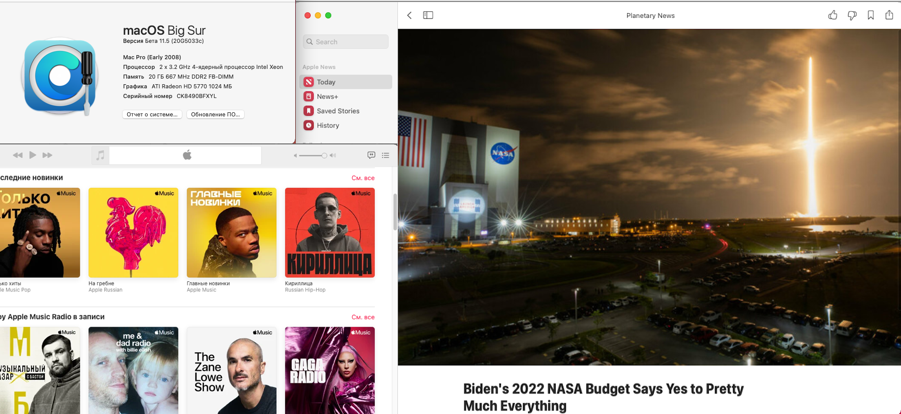

Hello, the impossible is possible😊MacBook7,1(320m)👌MacPro3,1(R9 280)👍

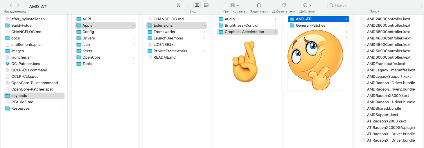

For the experiment, I installed 11.5 (20G5033c) OCLP 0.1.6 with an ATI Radeon HD 5770 Mac Edition video card.
But, there is no progress in accelerating ATI Radeon HD 5770 Mac Edition🙁" AttributeError: 'PatchSysVolume' object has no attribute 'success_status' "
Thank you dosdude1,khronokernel,ASentientBot and other developers

You may be right but I don't have that issue with my drives or cables . OR my USB connection too have got terminated. I just uploaded 4GB to the cloud from same drive without issue. So I feel that the apple thunderbolt adapter is not allowing firewire connections to stay for long.
