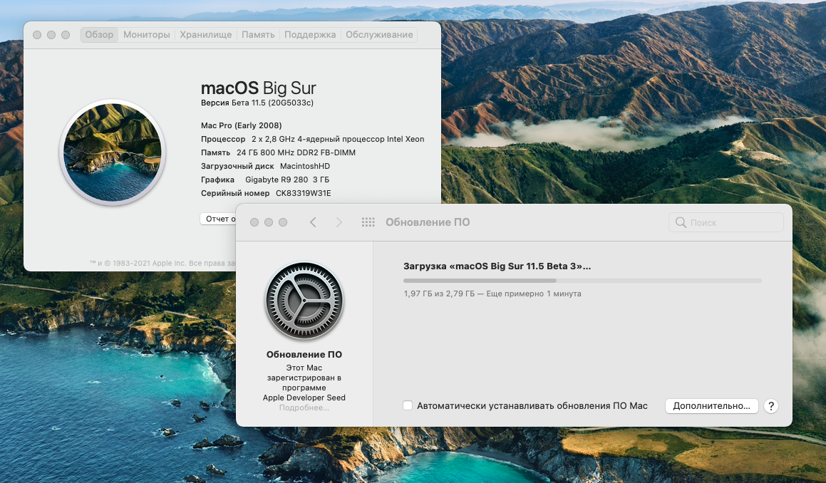

Hi!
Successfully Updated to MacOS 11.5 Beta3 on my CMP 3.1
Mac Pro 3.1
CPU - 2xE5462
RAM - 24GB DDR2 6400
SSD - 480GB HyperX Predator
Expansion card -ThunderBolt Adapter GC-Apine Ridge
GPU- R9 280 3GB (Flashed Mac Efi)
OCLP 0.1.7NB
Terrible work after i tryed to update to OCLP 0.1.7 - PCI-Express SSD unworkable
After Back to 0.1.7NB - some issues with freezes and forbiden sign
After i remove GC-Alpine Ridge - update finished normally
After reset SMC and move GC-Alpine Ridge back - work normally... ...some time
Final Issue - mac can't wakeup.
Reactions: AlexSakha67

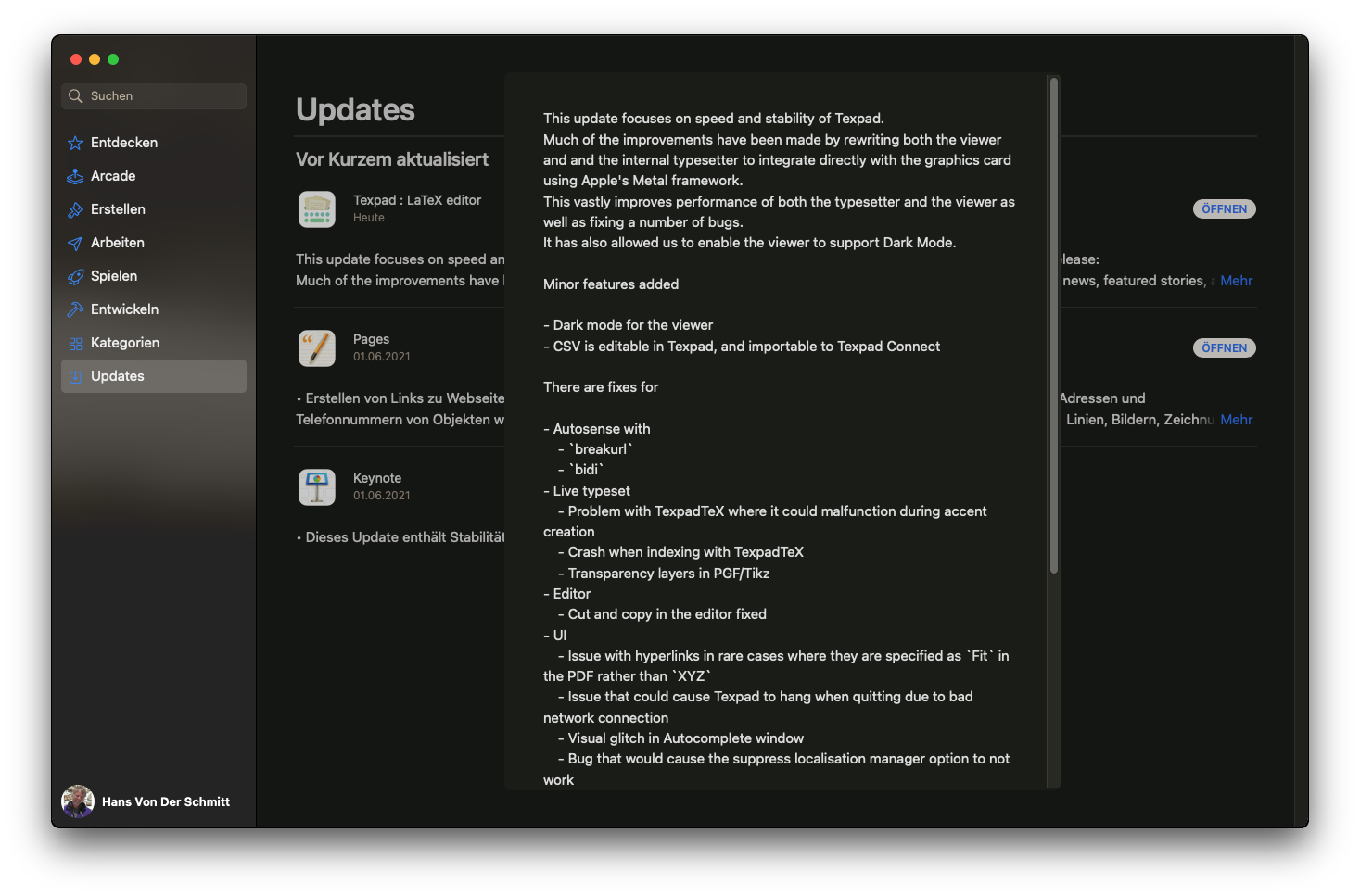

LaTeX is a standard tool to write physics etc papers - the progress towards Metal is good but not for me with my MBP5,2. Need to be more careful nowadays before applying upgrades from the Appstore. Back to a backup version...
