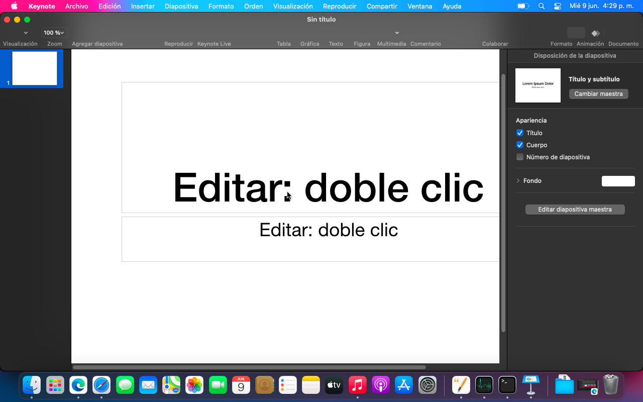

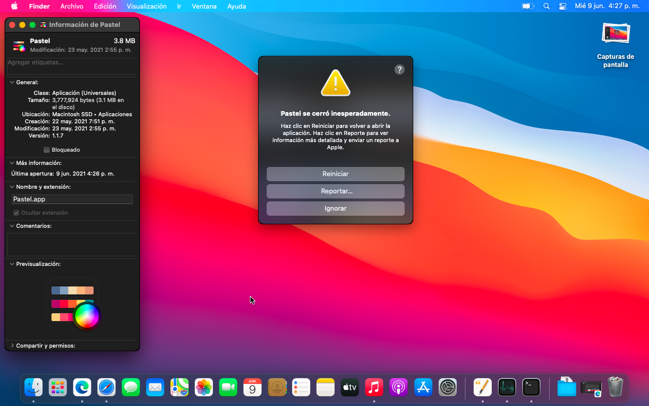

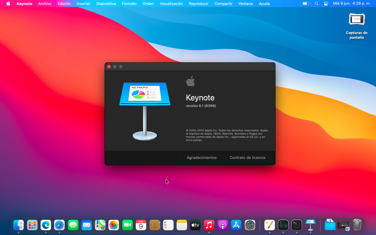

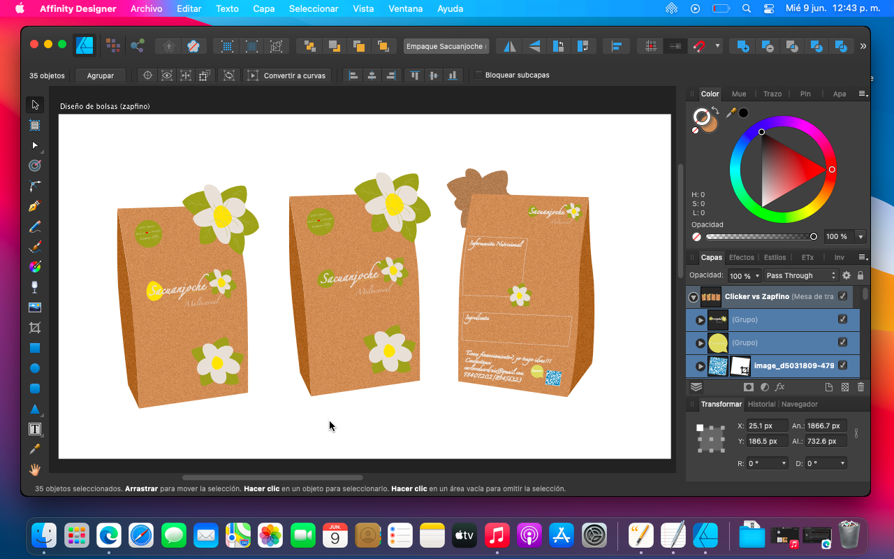

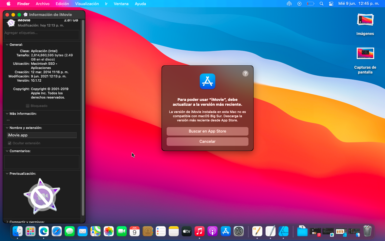

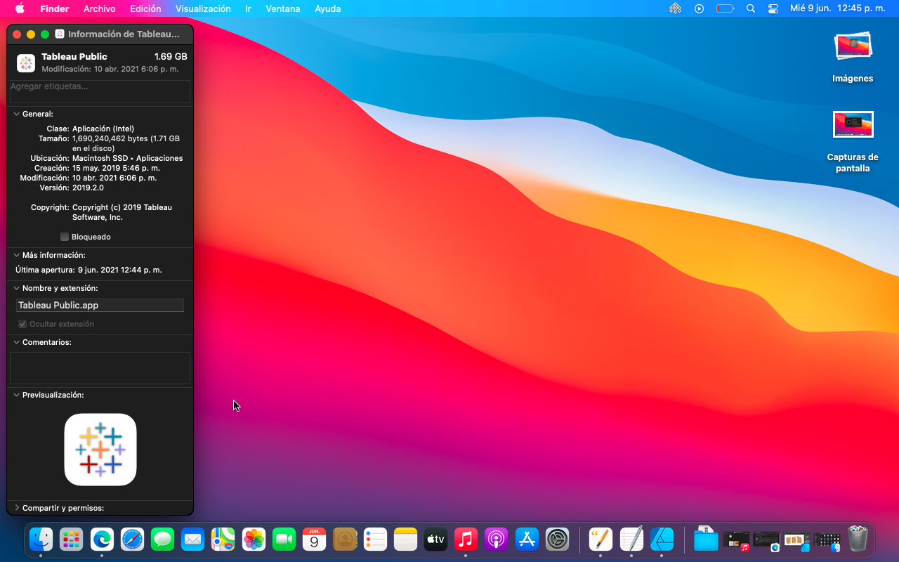

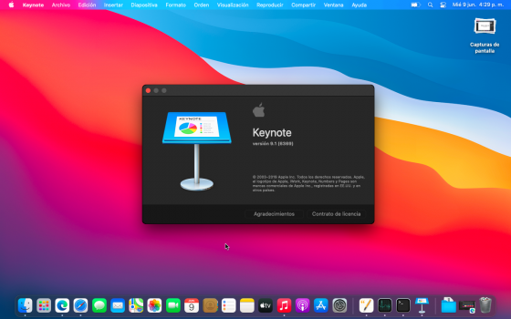

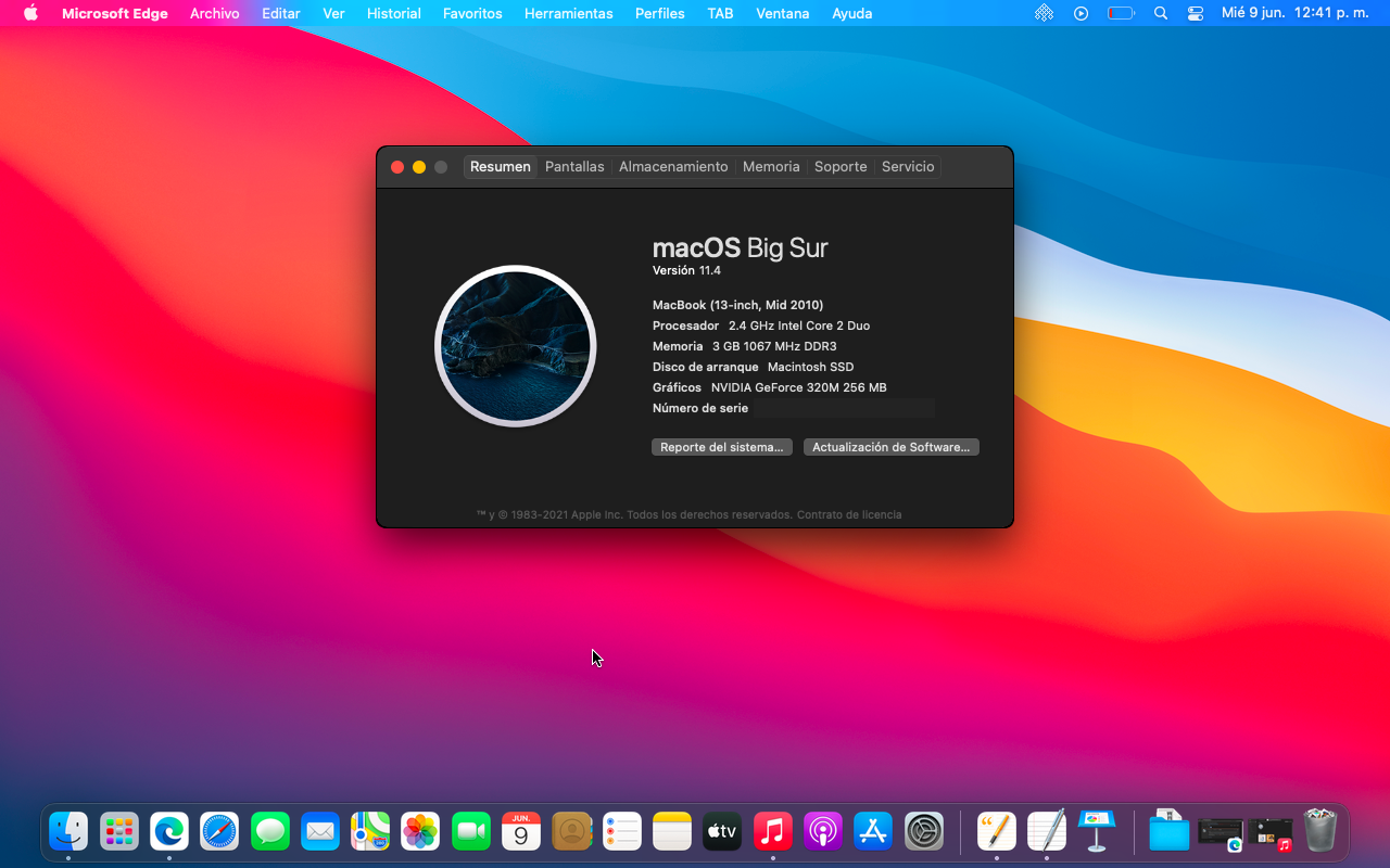

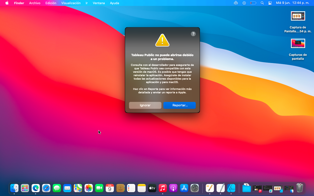

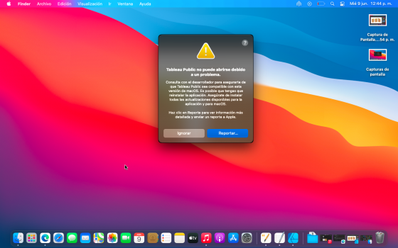

I ended installing Big Sur 11.4 on the 7,1 whitebook, it runs fast (didn't expect it but it's awesome that it's runing fast in the whitebook), but there's a lot of graphic glitches (as expected) (and they don't bother me, they are just minor details, doesn't affect any major task like using affinity designer), the problem is that a lot of apps doesn't work anymore like tableau public 2019.2.0 (the latest one that i could find that can work with my penryn processor, the newer ones says that my processor isn't compatible for some reason(and i need tableau)) another app that doesn't work anymore is iMovie 10.1.12 (the last version of iMovie that didn't require metal(worked well on catalina 10.15.6)) it's say that i need to update iMovie, but the latest version just crashes when open, and other app that kinda works is Keynote 9.1 (the last version that didn't require metal) works but with a lot of graphical glitches and sometimes crashes, and Pastel, an app that worked great on catalina and that is "fully supported" on Big Sur doesn't open anymore(it tries to but closes immediately)... the question is, do you believe that if i install Bug Sur 11.2.3, maybe they can work again on that macOS version or there's some way of running them on 11.4...what do you recommend me, and thanks again mate!... by the way, Big Sur looks fantastic on my 7,1 Whitebook...

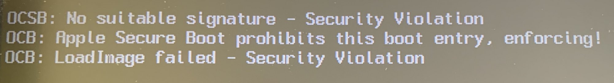

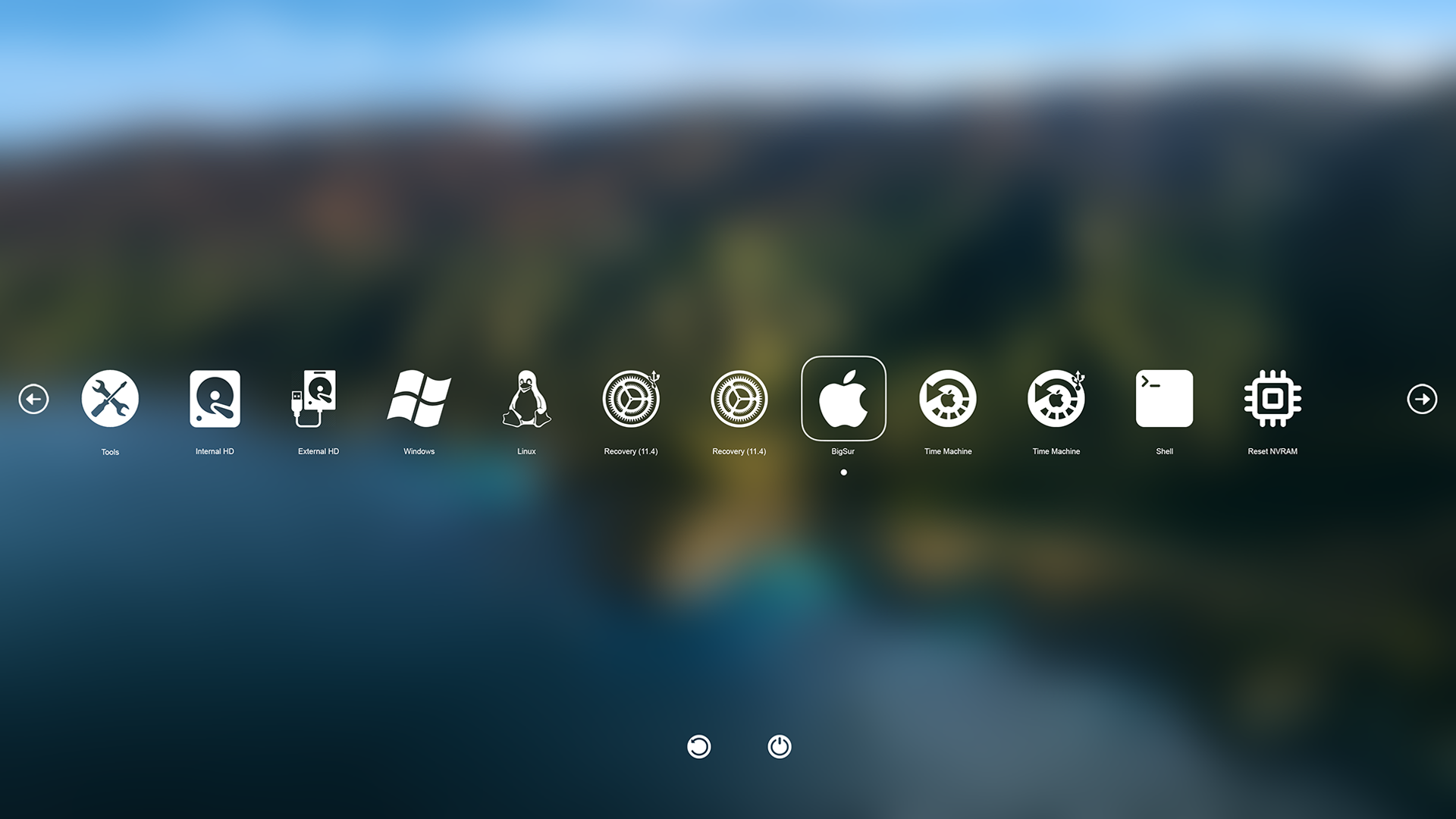

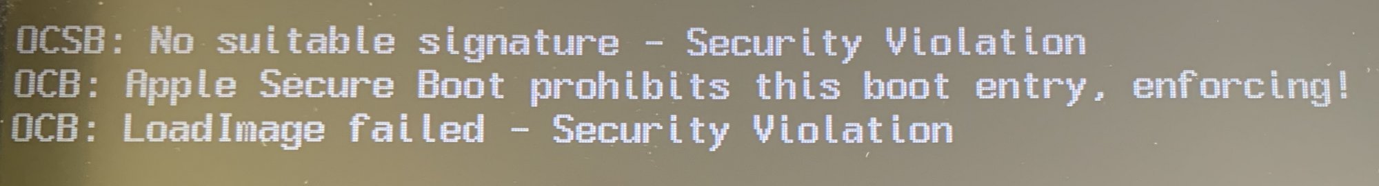

I restored my 2012 Mac Mini to Big Sur after trying to install Monterey from a Time Machine backup, sadly I get this.
Anyone know how to recover from this?
I first boot the OCLP in the picker, then choose the SSD with BS.
I get this below, I also sometimes get a lot more text to eventually come to a point it says CPU halting, this problem most likely is easy to solve, PRAM might be messed up after trying to install Monterey.
Rebuild your OC config and disable SecureBootModel - it is one of the options. You can just install the very same version of Big Sur on top of your current installation to enable SBM, again. Alternatively one can modify the preboot partition, which got a little bit corrupted on your journey to Monterey.

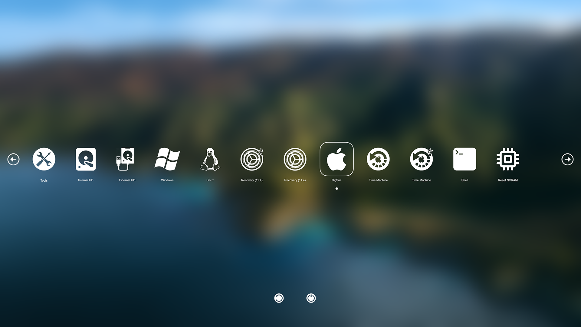

Thanks, that helped....a bit, have the other issue now.
That helped with the first issue, I had several OC installed on disks/usb sticks so that's why I had one issue like the one in the picture but then later had the other issue (which is the current one) of My Mac booting but CPU being halted (No kernel panic) and then shuts down.
I try to find the log so I can post it here later on.

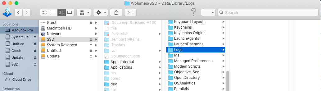

Have to put my Mac Mini in Target disk mode to retrieve the logs.

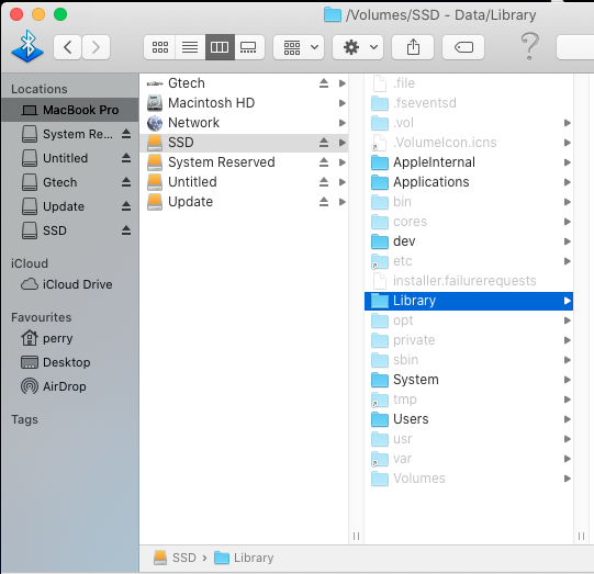

I also still have one extra Update disk, leftover from Monterey????
Target disk mode, Orange ones is the Mini.
