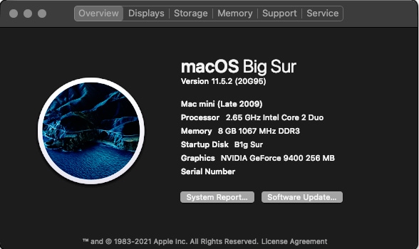

Update OTA from 11.5.1 w/OCLP v.0.2.5 TUI default settings for Mini3,1. Smoothest Big Sur update, yet. Slight increase in system overhead, CPU temps no change. Boots reliably.🤞🏼

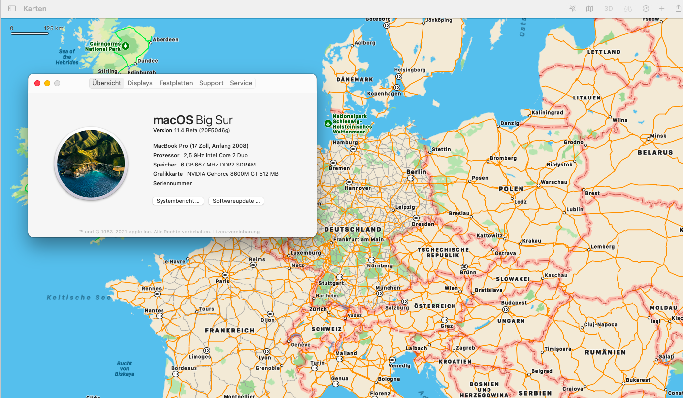

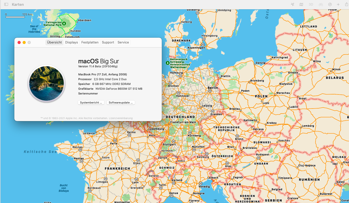

Both Apple Maps and Find My issues with the initial buttons (not being there / clickable with the OpenGL framework patches) can be circumvented by force-quitting the app, keep the (missing) button position in mind, open app again and rapid-fire-click onto that area until the "whats new" popup window closes.
You have to only do this once and both apps are fully usable from then on.
Of course, satellite views are still too dark - but we had that since Mojave/Catalina.
Thanks so much! This solved my problem. I wish there was a central database with all these problems/solutions so we could find the answers more quickly. The biggest problem is trying to figure out how to phrase the question...

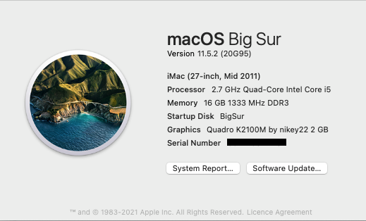

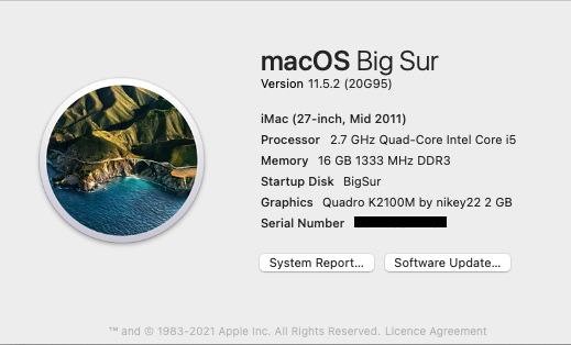

Anyone else experience stability issues with 11.5.2? My config is in my signature. I just updated a couple of hours ago and i had to force restart 2 times now. First, the screen just turned white when i opened Safari. The second time every app just simply closed and i was unable to open any app, it would crash immediately, even Finder for example.
This happens only on my experimental platforms (all iMac12,x and iMac11,x) when having a crash and not really properly booting into OpenCore, again. Sometimes one comes through to the desktop and then the problems come up. In all cases a PRAM reset and a reboot into OpenCore fixes all issues.
Currently I am using OCLP 0.2.4 and Big Sur 11.5.2 on my iMac12,2 / WX 4170 (pretty similar to yours) without any problems and crashes.
Uptime: 20:19 up 12 days, 20:03, 5 users, load averages: 1.03 1.18 1.09
P.S.: The weird Screen Recording issue persists, though. The RX480 on my iMac11,3 works perfect in this case.
