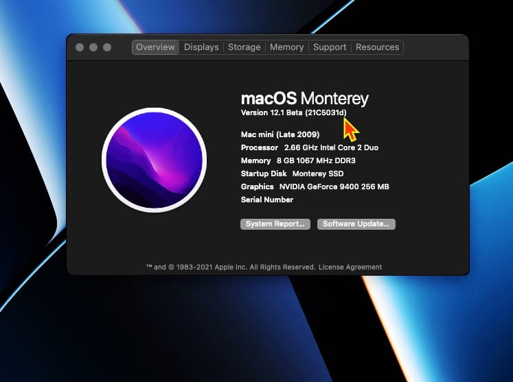

12.1b2 OTA atop b1 easy fast update. Runs as expected within the limits of hardware on this most primitive of unsupportrd Macs. OCLP_032 is nearing Big Sur competence with Monterey patching. 🧐

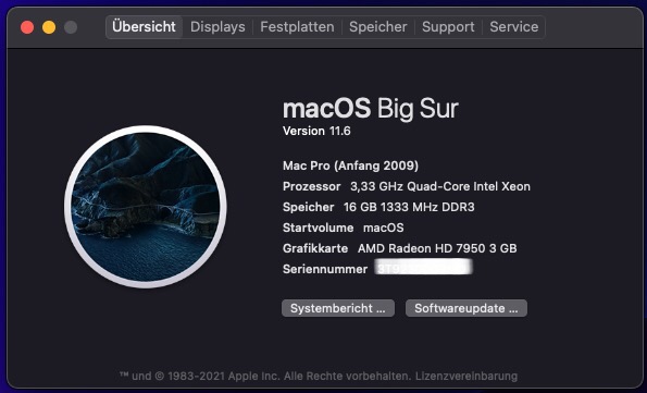

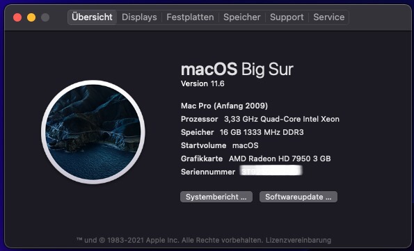

Does anyone have a fully functioning Mac Pro 4.1 with Monterey 12.0.1 and OCLP 0.3.1 internal? It's only like this for me with Big Sur 11.6.1, so far everything has been going well without any problems.

In this case there is a reason to update OCLP as version 0.3.0 and newer offers greater support for Monterey. Just do as Ausdauersportler says. It's always good to have some form of backup of any critical data though before doing something like this, especially considering that none of this is officially supported.

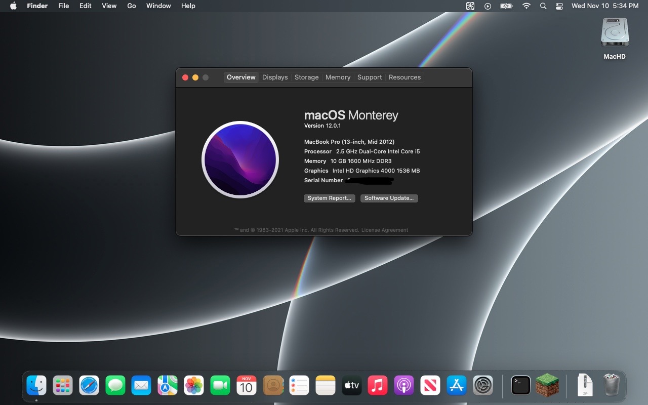

Its sad to say my older MacBook has better thermal properties then my 2017 MBP. Even on Monterey. The only issue I forgot to do was insert OCLP into EFI. Other then that works better then I expect. Any issues I should look out for?
Reactions: K two

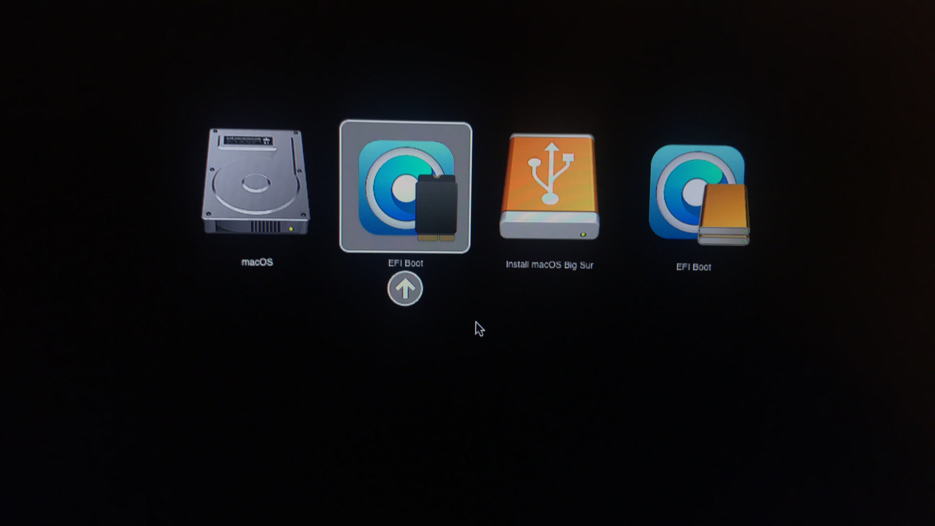

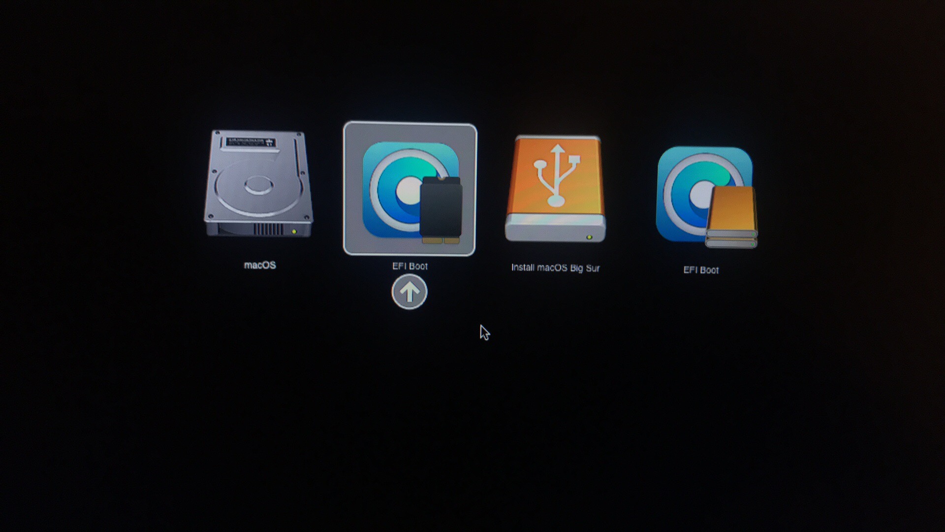

A. Fallback path (prepare ahead)
- Create USB stick installer for Big Sur 11.6.1
- Run OCLP 0.2.5 and install EFI on USB stick
- In case of fallback, boot onto USB stick, select EFI boot, select Big Sur installer and overwrite Monterey
B. Upgrade path
- Run OCLP 0.3.1 and install EFI onto boot disk
- Start Big Sur, check in Software Update for Monterey OTA offer
- Upgrade to Monterey
- Run post-install patch (you need the HD4000 patch for 2012 macmini)
B. Upgrade path
Alright, thanks! I retained my 11.6.1 USB stick with OCLP 0.2.5 on it, so that's already done. But I was under the impression that an older version of macOS won't install over a newer one without completely erasing the disk. I'm glad that's not true, it makes recovery so much easier!
With Big Sur, you may have noticed that OS is on separate volume(SSV). Your user files are in another volume.
AFAIK, no harm done downgrading Monterey back to Big Sur.
As contingency, you should have time machine backup. Just in case.
K two - i have similar machine laying in my closet :) Do you think it will be good, stable enough to use it a server and some browsing ? Thank you !
Reactions: K two
