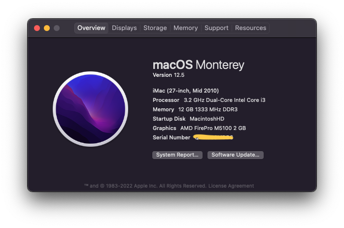

Can someone please confirm that AMD GCN v1-3 GPUs work with Monterey 12.5?
( I am specifically interested in the m5100). Many thanks.
FirePro M4000 and FirePro M6100 do work. M5100 will, too. They will also work with future Monterey versions. (Monterey is fully/natively supported on Macs which originally came with those AMD GCN GPUs...)

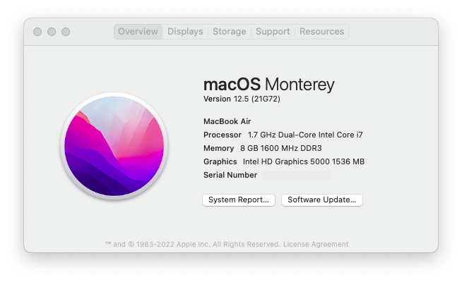

Updated 12.5 with OCLP 0.4.9 for MacBook Air 13.3 6,2 Mid 2013, Intel HD Graphics 5000, no issues at all.
