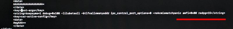

If you can edit the config.plist of OpenCore add radpg=15 to the boot-args.
If you have another Mac build and install OpenCore for target iMac11,3 and pick the GPU family type GCN from settings->misc settings->GPU selection.
This card needs special OC settings to run macOS and these are only set correctly when running OCLP on macOS on the same machine with the same hardware - this can become a catch 22 - so these manual selection has been added.
Edit: Does not matter which EFI and which config.plist you are going to edit, just make sure to boot the changed one!

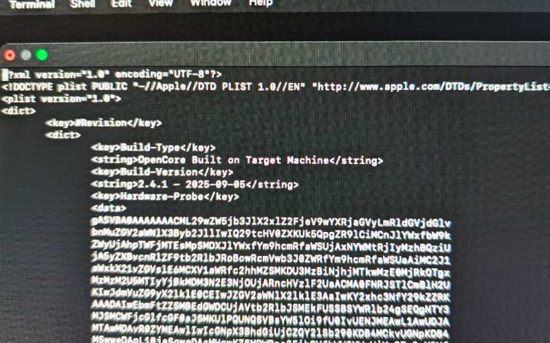

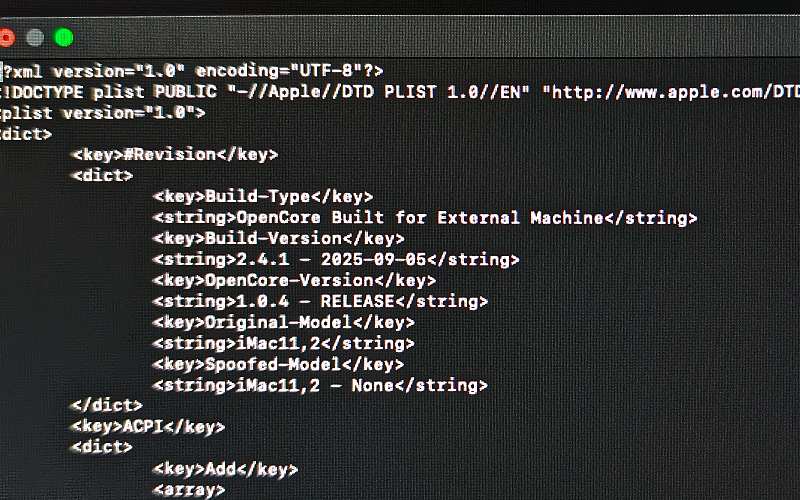

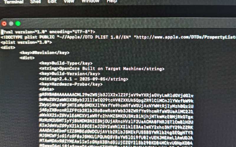

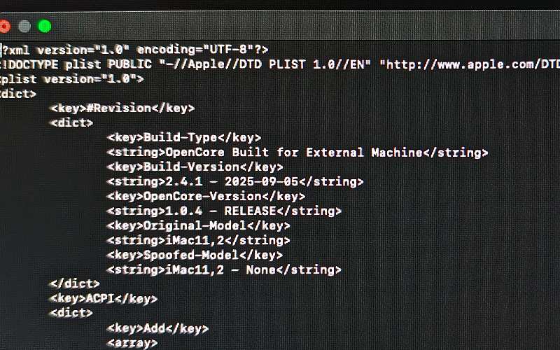

Ok, so that didn't work. I went to EFI partitions on both the SSD and the Install USB and changed the config.plist. USB still boots fine, SSD gets a yellow screen. Neither did Safe Mode boot from SSD work. And yes, the changes saved after reboot (multiple), I did check. Screenshots just in case it matters.
USB config.plist header
SSD config.plist header
Here's where I added the argument in both:

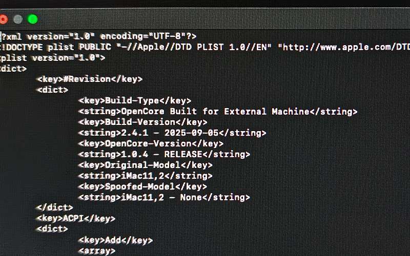

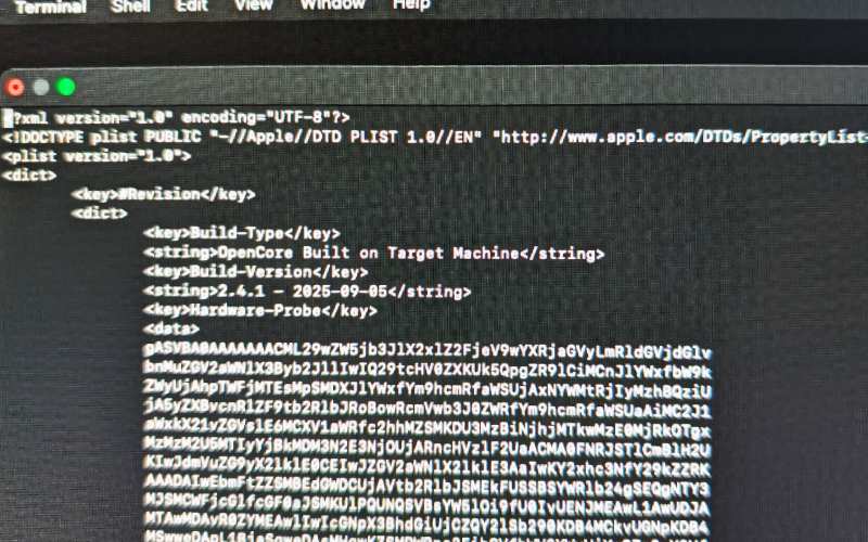

Whatever you did, even your USB settings are borked. Spoofing to the iMac11,2 model will not be used by any valid OCLP generated OpenCore configuration using a new upgraded AMD GPU on these MXM iMac models.
