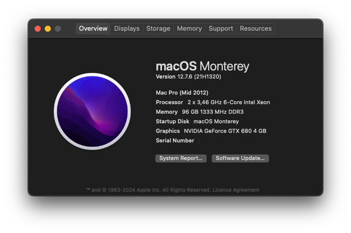

Updated to the latest macOS Monterey patched with OCLP 2.4.0
