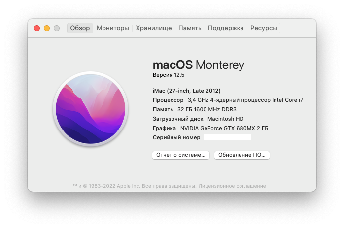

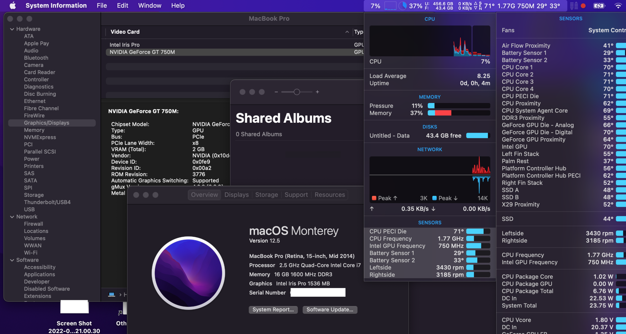

updated my 11,3 mid 2014 nvidia 750m from 12.4 to 12.5 smoothly without problems
I tried to trigger the Nvidia GPU with the photos app and everything worked perfectly like 12.4
Thank you again for everyone involved in this , much appreciated

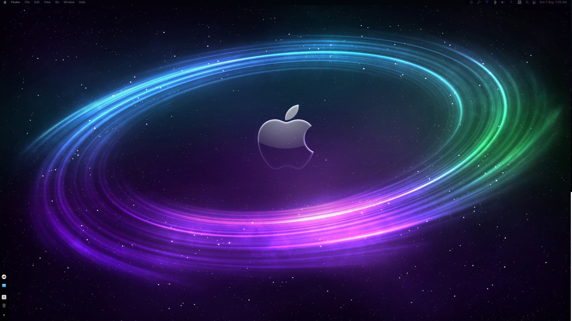

My late 2012/13.2, 27/Imac now seems to work perfectly with 12.5/4.10 updated from 12.2. I downloaded 4/10 first then 12.5 after the installation I reinstalled 4.10, after the reboot(which seemed quick) I ran the patcher which said it would patch N/Kepler and Ivy bridge. the process was seamless and easier than previous efforts.
Thanks to all the geniuses who devote such time and effort to make this possible.
I just now received notice again that Ventura is available, I will wait patiently, happy that this Imac is doing better that I ever expected.

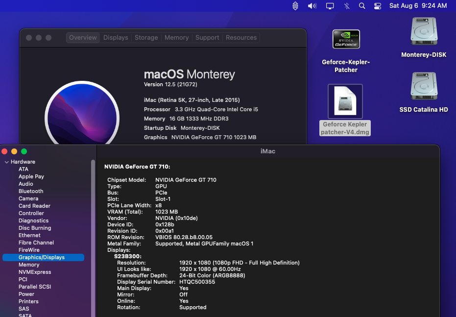

Thanks to the OLCP developers for the Kepler fix. However, I decided to replace my Kepler with an AMD card so I could get through Monterey without a root patch. The good news is that since the developers solved this problem that should be on their way to solving Legacy Metal in Ventura. Since I have AVX2-compliant MacBook Air (2015), I am hopeful this particular device should be among the easiest to support. Sadly, all unsupported Macs for Ventura will be at the root patch stage. Monterey should smooth sailing from this point forward.

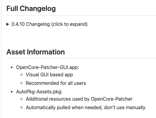

It is stated very clearly that AutoPkg-Assets.pkg should not be run by the user.

AutoPkg-Assets.pkg is a support package used by the autopatcher during OS installation. It is automatically added to any USB installer created by OCLP and is run using an undocumented macOS post-installation administration feature.
Once again, you should NEVER run this package. It is not designed to be run by users. It is only for the autopatcher and bricked machines can and should be expected if you run Autopkg-Assets.pkg.

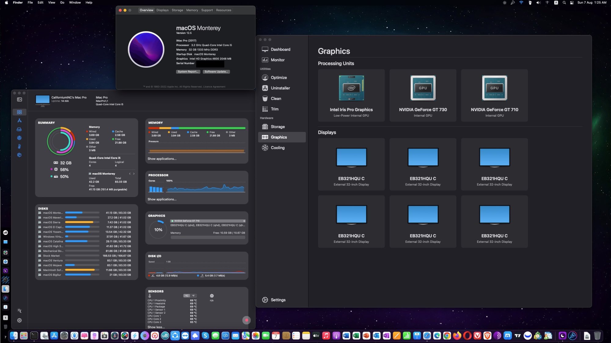

Thankyou for making my day with the release of the Opencore Patcher 4.10 and making the macOS Monterey 12.5 able to install on my computer. I am going to buy Asus Nvidia GT 730, Low profile graphics 4 HDMI output 2 more cards and add 6 to 8 more monitors to my computer thus completing my dream 12 or 16 monitor setup.

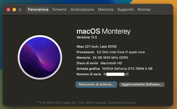

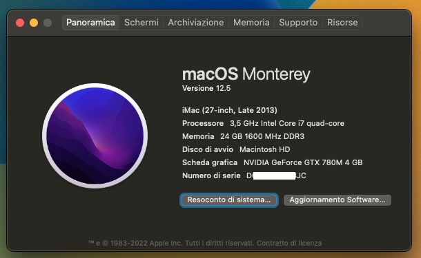

Success! MacOS 12.5 installation perfectly successful in my iMac with nVidia from the Kepler series. See attached screenshot. Thanks to all the OCLP Developers and @khronokernel first of all.
