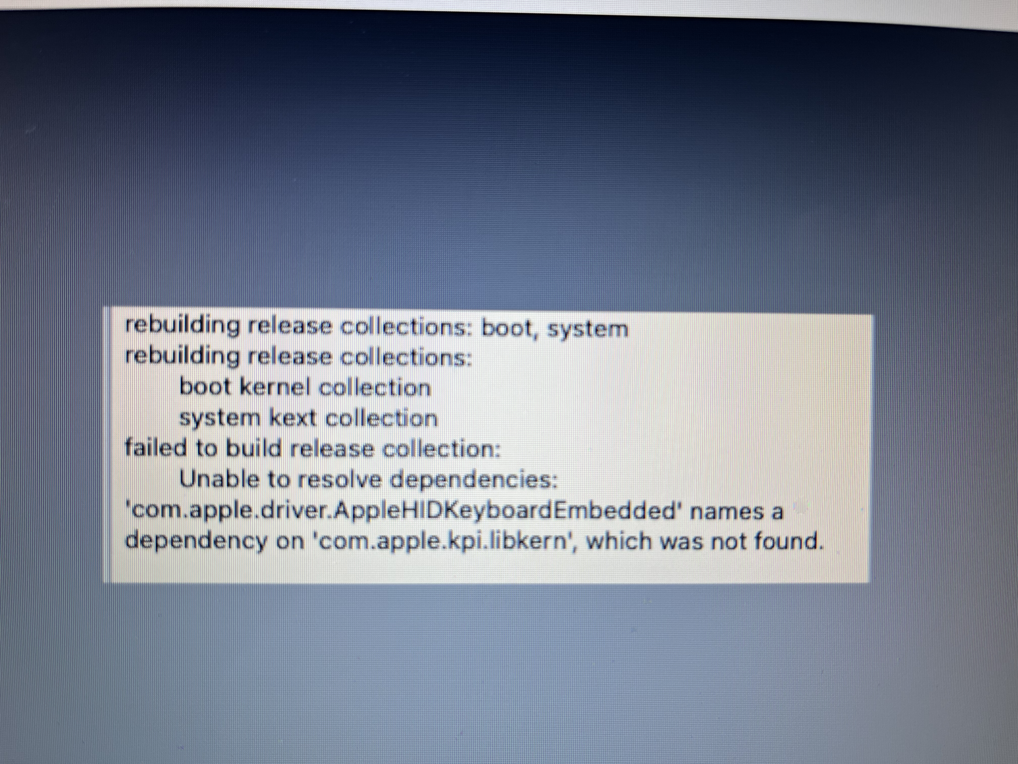

Opencore Legacy Patcher prompted me to install its latest update today. After I let it install, it asked to restart the computer. Now the computer gets stuck when booting up.

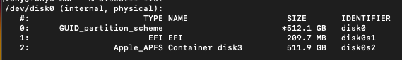

If you can launch Monterey Recovery and you know vi editor, you can try the steps below. I haven't done this myself, so you'll have to let me know if this works. Be very careful since you're operating as root.
  1. Boot with Open Core EFI and press space bar at Open Core boot menu to show auxiliary menu items
  2. Choose Monterey Recovery and allow Recovery mode to boot
  3. Open Terminal
  4. Enter command "diskutil list" to show a list like this
  5. Identify your EFI partition (disk0s1 in my example in step 4)
  6. Enter the command "diskutil mount disk0s1" (replacing disk0s1 with the identifier you found in step 4
  7. Enter the command "cd /Volumes/EFI/EFI/OC"
  8. Enter the command "cp config.plist config-bak.plist" (to save a backup of your unmodified config.plist)
  9. Edit config.plist with vi editor (search for boot-arg and add -v to boot-arg list, save config.plist)
  10. After exiting vi (saving modified config.plist), enter command "cd /", then enter command "diskutil umount disk0s1" (replacing disk0s1 with the identifier you found in step 4
  11. Reboot
Be very careful in step 9 to edit only the boot-arg list. If you think you screwed up your config.plist, don't reboot from Recovery Mode. Instead, copy config-bak.plist to config.plist (command "cp config-bak.plist config.plist") and try editing config.plist again (try again BEFORE you reboot from Recovery Mode).

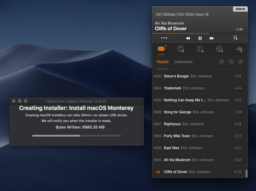

Although I'd like to solve this and pass on my findings to the devs but I've been without an OS for several days and I needed access to my data ASAP. Not willing to dabble in places I'm unfamiliar with at this point. Many thanks for the info.
On a happy note, it's time for some install music:

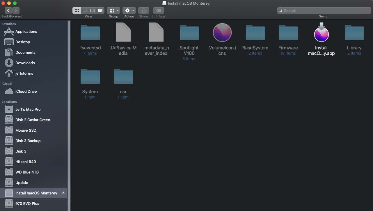

Hmmm... I think I found out why I was not able to boot into Opencore USB to recover Monterey. This did not happen the first time I used this flash drive. I tried wiping it and installing again and it was successful but it failed to load EFI on reboot. Just ordered a new thumb drive and will try again tomorrow. For now I'm up and running on Mojave

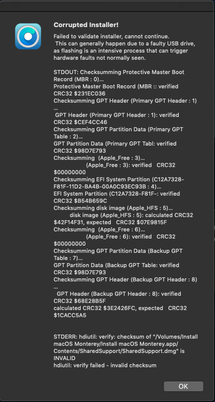

Ok, bought new thumb drive and tried again but OCLP is not creating the EFI Boot option. See the contents of my thumb drive with newly installed OCLP patcher 0.6.8 below.
