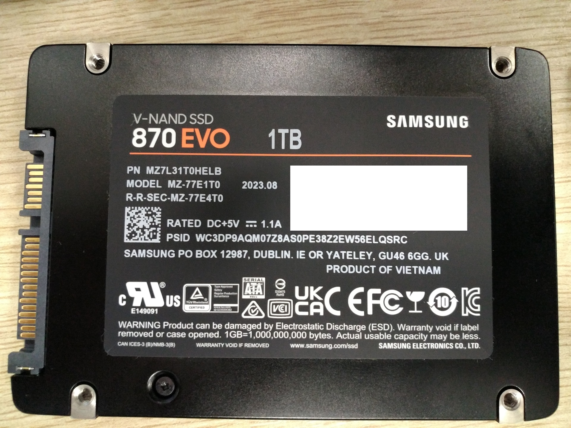

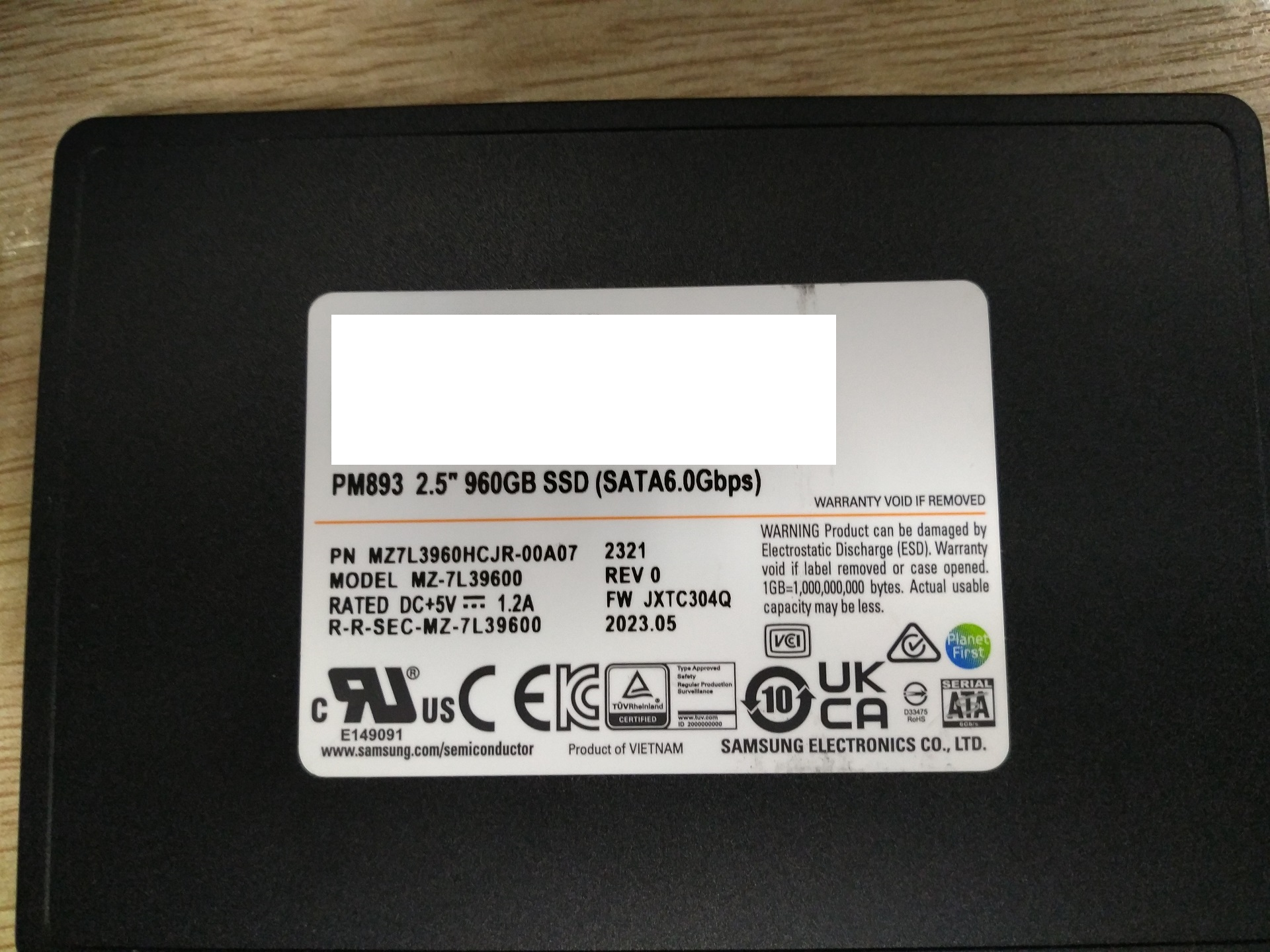

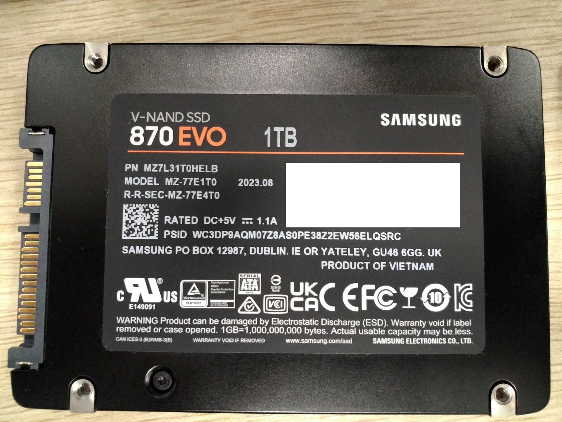

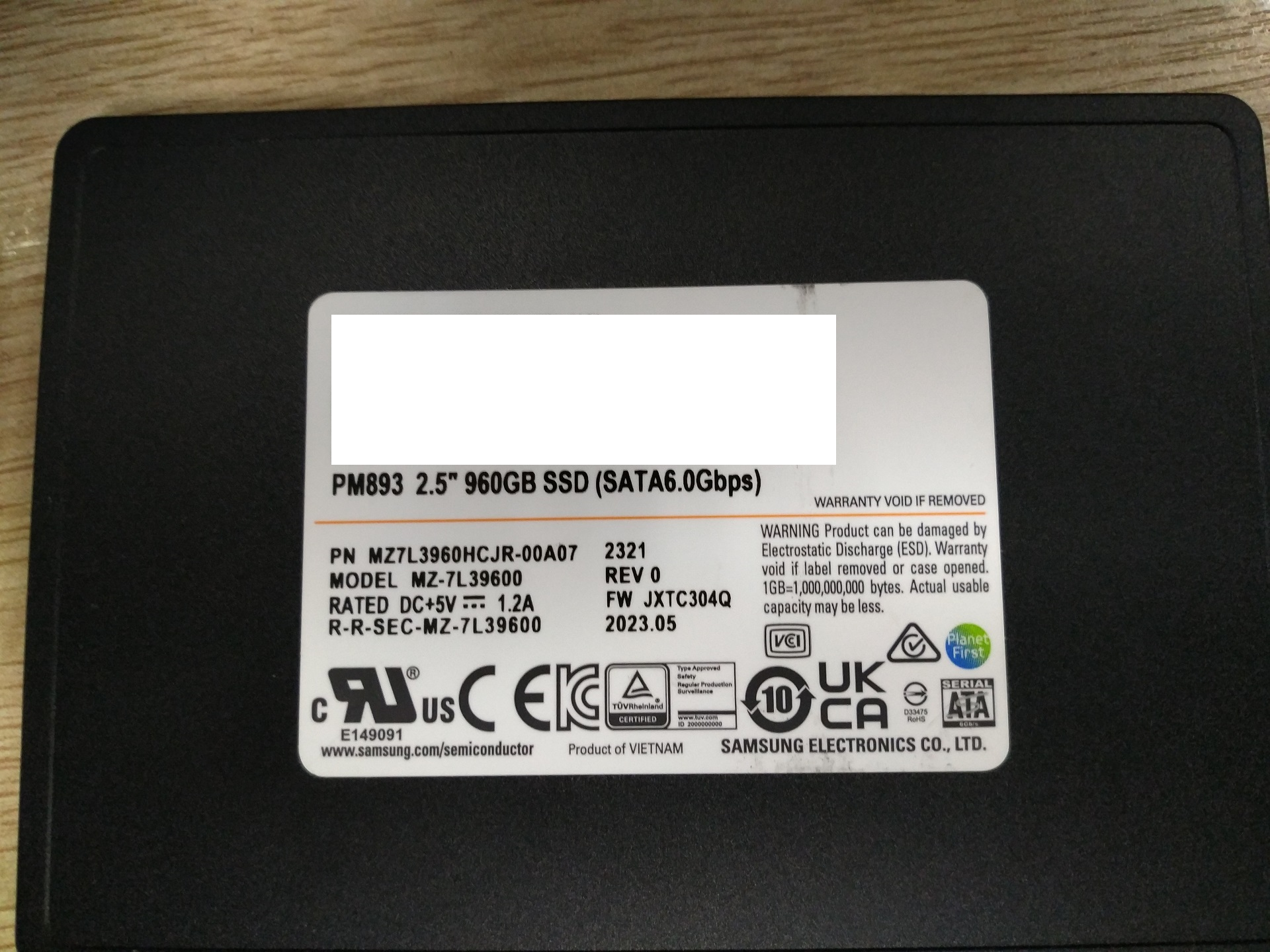

Got second copy of Monterey installed 🙂. First SSD used - didn't worked, Samsung EVO 870 1Tb. But I've got other, server grade PM893 - all OK. Partitioned it as APFS & started installation. After 3-4 autoreboots system was online 😀.

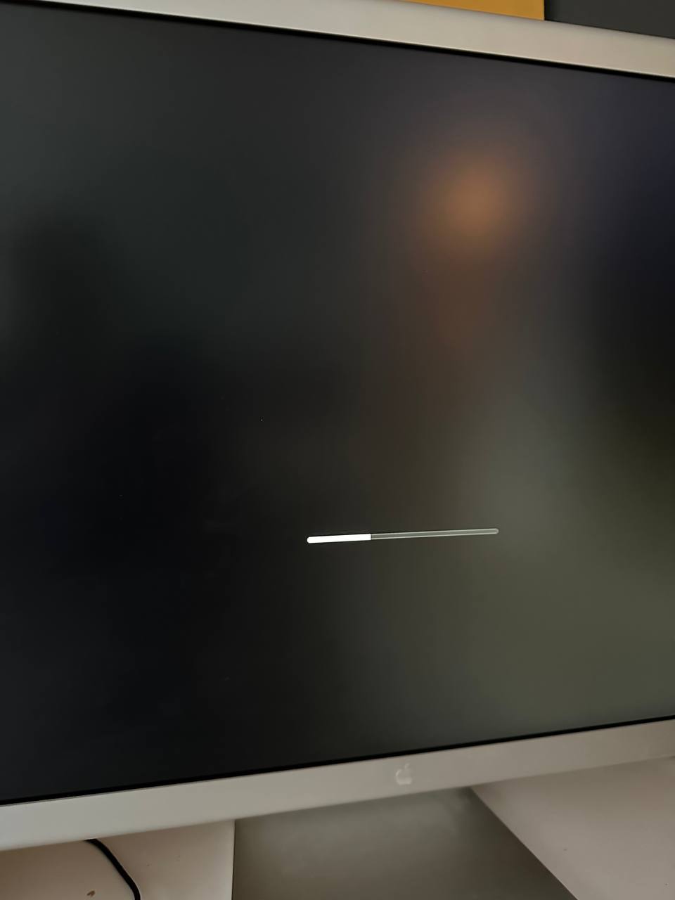

Hello! Why after I updated the video card from GTX Titan to RX 6800 XT, it stopped automatically transferring me to the Open Core EFI Boot loader. The video card is fully flashed for Mac Pro 5.1, was bought at Macvidcards.
When turning on, it automatically loads to somewhere unclear, on the screen is a loading bar without the Apple logo. I have to press alt myself and manually select the OpenCore loader.
I am using MacOS Monterey and OpenCore Patcher version 0.6.4. OpenCore loader is installed on an empty separate drive in the first
SATA slot. Please help what to do, I can't find anything on the internet.
It's a common issue, NVIDIA webdrivers for GTX Titan are known to mess with the MacPro5,1 BootROM's NVRAM volume, saving a big blob inside the VSS stores that blocks AMD GPUs to work. If you can't access the Apple native BootPicker with your RX 6800XT MacVidCards flashed GPU, you have this issue.
You can try a deep NVRAM reset, if doesn't work, you will need a BootROM reconstruction service. You will also gonna need to clean install Monterey, since when you install an unsupported release via OCLP, the root patching process removes all GPU drivers but the drivers for the GPU you had installed when you did the macOS install.
So, if you changed the Titan for the RX 6800XT without re-installing Monterey, the 6800XT didn't work because of the missing GPU drivers.

I would like to clarify that my operating system actually works well, and I do get access to the EFI Boot Loader, but not automatically. Each time I start my computer, I need to manually press the 'alt' key to access the boot menu and manually select the EFI Boot Loader. This is not very convenient, and I am looking for a way to automate this process.
I need help to make the computer automatically enter the EFI Boot Loader without having to manually select this option every time. Could you advise how to solve this?
Thank you for your time and assistance.
If the Apple native BootPicker is working, press Control and select whatever you want as the default boot.
It seems there has been a misunderstanding. Although I can access the native Apple BootPicker, the issue is that even after selecting the desired boot option while holding the Control key to set it as default, my computer still boots to an unknown location. I continue to see the loading bar without the Apple logo, regardless of my actions in the BootPicker.
Are there any other steps I can try to resolve this issue? Sorry for the confusion, but I really need to make my computer boot correctly and automatically.
Thank you for your patience and assistance.
Did you tried to deep reset the NVRAM? If you cant set the default boot disk, you have an issue with the BootROM.
Do you even have the Apple BootPicker? The grey one?
This is becoming circular…
If you can't bless via BootPicker + Control, you probably have an issue with the MacPro BootROM.
The only other way to bless is doing it manually, mount your ESP, then:
Code:
bless --mount /Volumes/EFI --setBoot --file /Volumes/EFI/EFI/BOOT/BOOTx64.efi
For more info, read the first post of the thread below:
Reactions: GidroGen

Yes, I successfully performed a deep NVRAM reset and heard the startup sounds, indicating that the reset was indeed performed. However, the core issue remains unchanged. After the reset, I still need to manually press the 'alt' key to access the Apple BootPicker, the grey one, and manually select the EFI Boot OpenCore, and then the Monterey system boots up. So, the system works, but I must manually select the boot option every time, which is not ideal.
It seems there might be an issue with the BootROM, as you've suggested, since I can't set the boot disk to automatically load through the EFI Boot OpenCore without manual intervention.
Do you have any further suggestions on how I might resolve this issue to automate the boot process? Or is there a specific method to diagnose or address the BootROM issue directly?
Thank you for your continued assistance.
