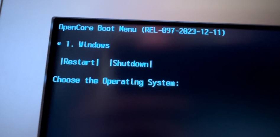

IMAGE 2024-03-16 17:08:42.jpg
Sorry for the delayed response, and thank you very much! I managed to set it as the default, but it was only possible by reinstalling macOS. However, another problem has arisen. After selecting OpenCore Boot Loader as the primary, this window started appearing upon startup. It loaded fine the first time, but the second time I encountered this unclear window. Moreover, if I boot manually, everything is fine. I'm using OpenCore Legacy Patcher 1.4.2, macOS Monterey, Windows 11, on a Mac Pro 5.1. Thanks in advance for your help.

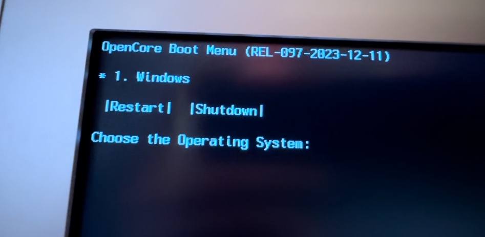

View attachment 2359806Sorry for the delayed response, and thank you very much! I managed to set it as the default, but it was only possible by reinstalling macOS. However, another problem has arisen. After selecting OpenCore Boot Loader as the primary, this window started appearing upon startup. It loaded fine the first time, but the second time I encountered this unclear window. Moreover, if I boot manually, everything is fine. I'm using OpenCore Legacy Patcher 1.4.2, macOS Monterey, Windows 11, on a Mac Pro 5.1. Thanks in advance for your help.
This happens when the NVRAM volume is messed and Windows take over, just resetting the NVRAM is not enough. When this happens is usually a Windows boot coup.
Did you enabled ProtectSecureBoot? You probably have the BootROM signed by Windows UEFI installed SecureBoot.
Also, the text mode OC BootPicker shouldn't even appear with a correctly installed OC/OCLP instance and a supported GPU.
Thank you so much for your detailed explanation! I'll admit, I found some of the technical aspects a bit challenging to fully grasp. Could you possibly simplify the steps I need to take next? Specifically, I'm unclear on how to adjust or disable the ProtectSecureBoot setting in OpenCore, as well as how to address the NVRAM issue you mentioned. Any additional guidance or a more step-by-step approach would be incredibly helpful. Thanks again for your patience and assistance!
ProtectSecureBoot is useless after the BootROM is already damaged. Anyway, you can get everything you need about the config.plist from the first post of the Manually Configured OpenCore on the Mac Pro stickie thread, this is easily searchable and fairly documented. ProtectSecureBoot is part of the Basic Settings.
