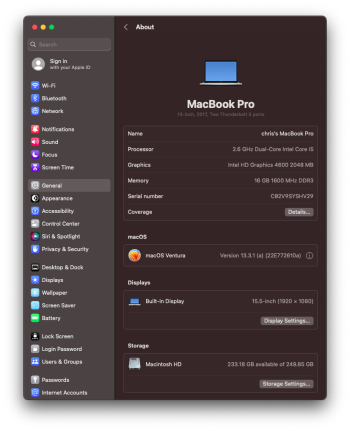

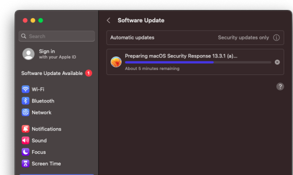

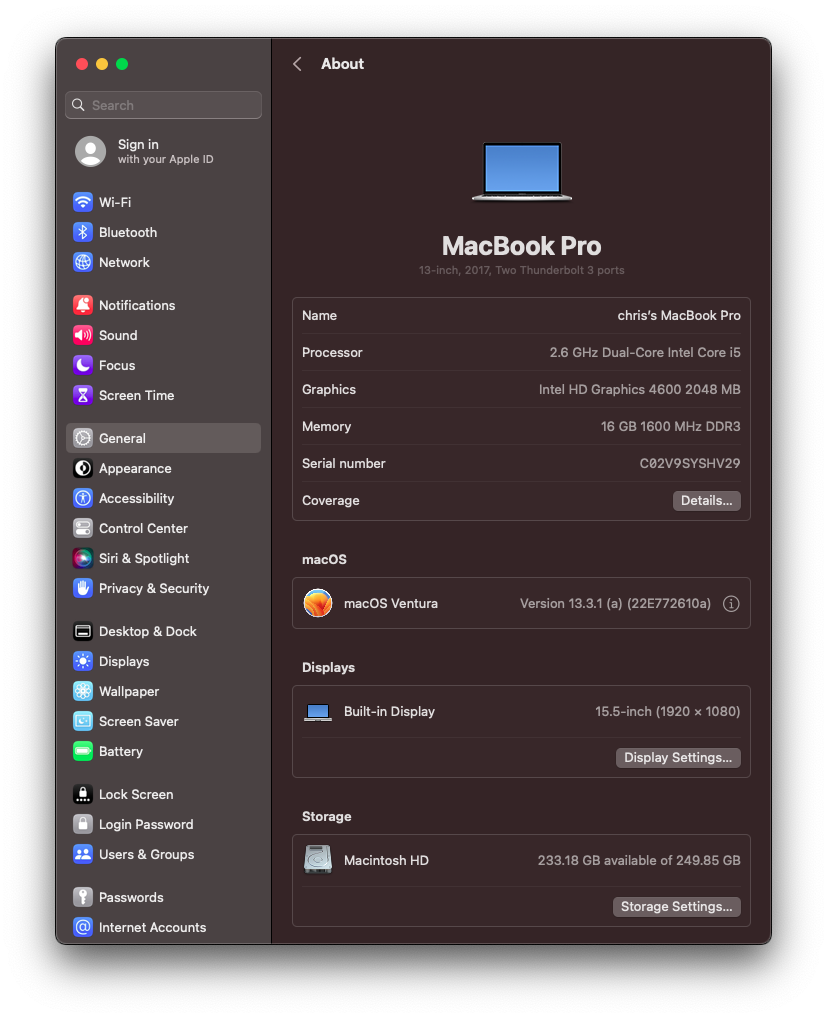

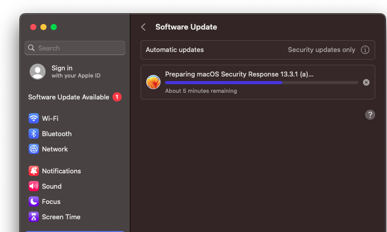

Just to confirm that there is no issue for Rapid Security Response update here on HP Probook 650 G1 Pure Haswel cpu i5-4340M Latest OCLP 0.6.5
Reactions: perez987

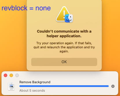

Just like to report back that the "Remove Background" feature does not work for my iMac13,2 (Ivy, GTX 680MX) either with revblock=media or none. But it works on my iMac12,2 (Sandy, K3100M) with revblock=none. Both have Kepler GPU.
P.S. I've tried with various OCLP & Ventura versions and this issue is persistent.
