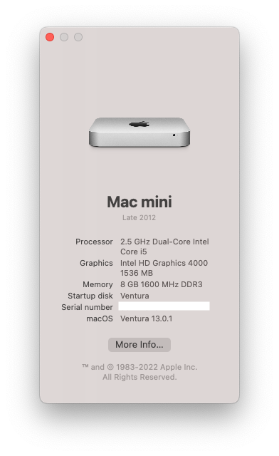

Finally gone ahead to OTA to 13.0.1 on the 2012 mini w/ 0.5.1 OCLP.
Went nominal, multiple reboots, then prompted to redo root patch. Seems ok, will monitor. Not expecting any bug fixes anyway.

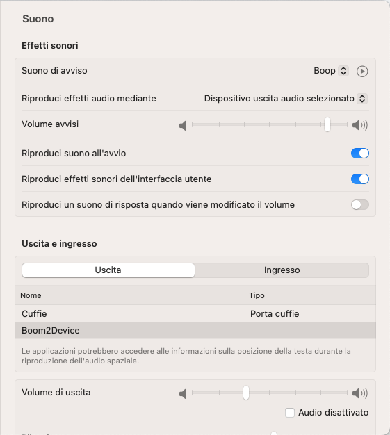

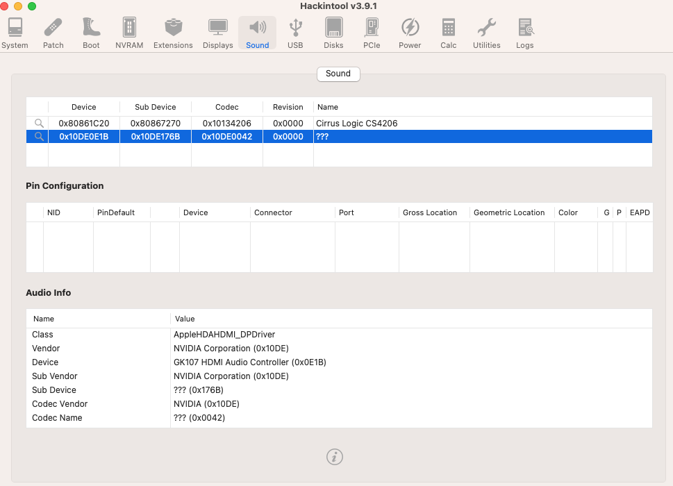

on iMac 2011 21.5 with quadro k1000m, Ventura 13.0.1 work well, very good... only wifi is broken but with "Wireless USB Big Sur Adapter" v. 15 and a compatible dongle as d-link dwa 121 is all OK... just another note... before with monterey the integrated audio worked, now it doesn't anymore, the item "built-in integrated speakers" is no longer present in sound > output... but the headphone output is ok... the initial sound when turned on is ok, but after that the onboard audio is missing

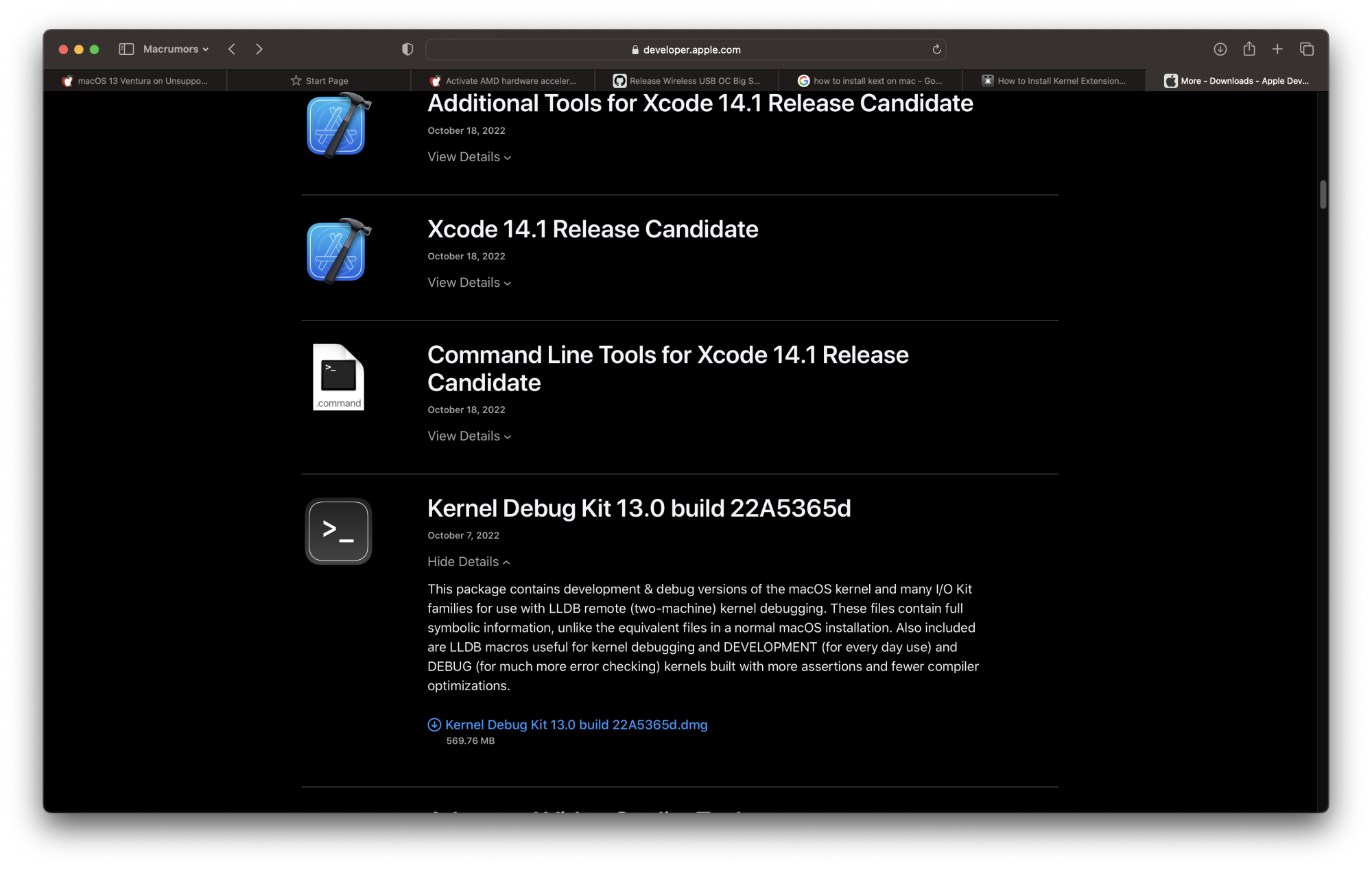

At the risk of looking foolish, is: Kernel Debug Kit 13.0 build 22A5365d the same as disabling SIP? If not, I'm confused on the sequence. Do I run OCLP 5.1 first and then the Kernel debug kit on Ventura? I have a Mac Pro 6.1, which I just learn yesterday is affected.

Sorry, I'm not familiar with it. I create developper account, search Kernel Debug Kit 13.0 build 22A5365d and didn't find it. If you can point me where it is and what to do with it. Does it resolve the problem or shw detail error.
You have to have a Developer Account
Here's the link: https://developer.apple.com/download/all/
Scroll until you see "Kernel Debug Kit 13.0 build xxxxxxx", click on "View Details" , scroll until you see the download link.

iMac 21.5 2011 updated with Quadro k1000m 2gb, Ventura 13.0.1 (all work fine, only no wifi solved with usb dongle):
Is it possible to solve the problem of missing built-in speaker voice in audio>output in a future release of OCLP?
