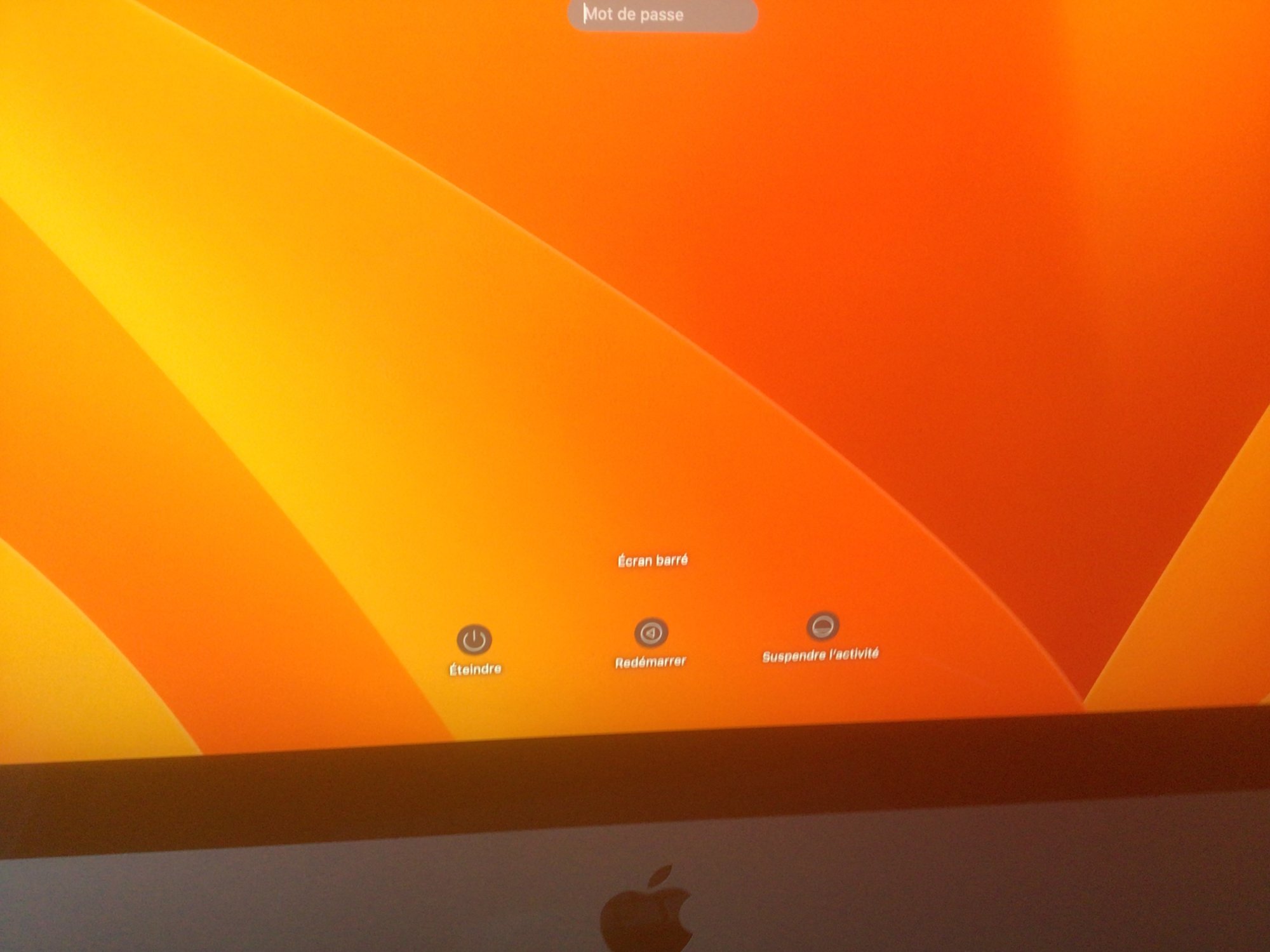

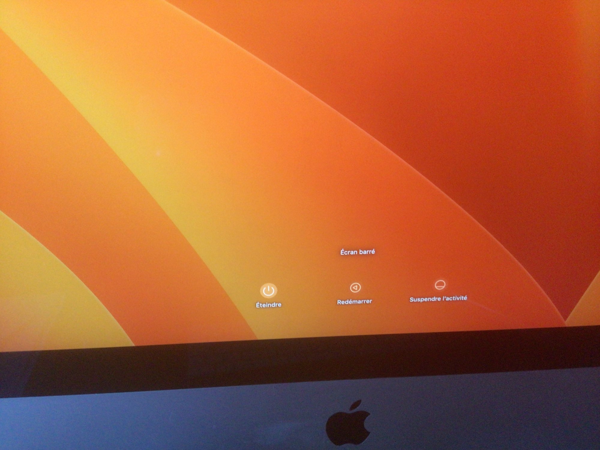

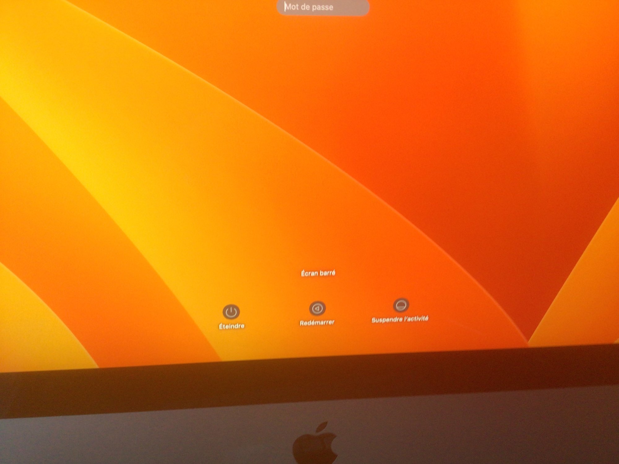

Hello all, need help .... I'm just a simple user who want to keep his device, but not tecki, but can follow a guide.
I finally installed Ventura 13.0 on my late iMac 2015 with OCLP 0.5.1 and I was stuck on a reboot with a 97% percentage advance (....the last reboot before the login in Ventura based on a video guide). After 1 hr, I powered off my iMac. I restarted with press option key, login, downloaded the Kernel_Debug_Kit_13.0_build_22A5365d as mentionned on one post and did the Post install Root patch, but as requested by OCLP to do a reboot, nothing happend. So After 10min, I did a power off again. I noticed after I do a login, I can close my session and redo the login and I can do sleep but not able to do a shut down or restart Very strange and wish it work. My CPU is not at 100% used and no app are open.
Hello, I redo all the process to install Ventura 13.0 with OLCP 0.5.1 and still in same situation not able to do a shut down or restart before or after login in Ventura. So I found that link https://4ddig.tenorshare.com/mac-problems/fix-mac-wont-shut-down.html#part1
who suggest some options to resolve the not shutting down. One of them, is Try the Safe Boot. So I did. at the login page in Ventura , I noticed, all the zones password, shut down option, restart option and suspend option are in gray and the shut down and restart work at login page or after the login. But, when I do a restart or a shut down, guess what… all zones in gray are now in white. I pressed power off and I redo the try the save boot feature and it wok. It’s not normal to do so !!
My late iMac 27 2015 3.2 ghz I5 4 core with 24g of ram is not custom IMac except I replaced my dead original HD one year ago with a Timetec 1T SSD and it work fine since then. See first attachment the login Ventura page that work and the other one where entry are in white. I also noticed, when it’s working the background of all drop down menu are in deep black compare when it’s not working, it’s lighter black. I could missed something, but I redo 3x and double check what I do.
Hi, if you unpatch can you boot normally ?

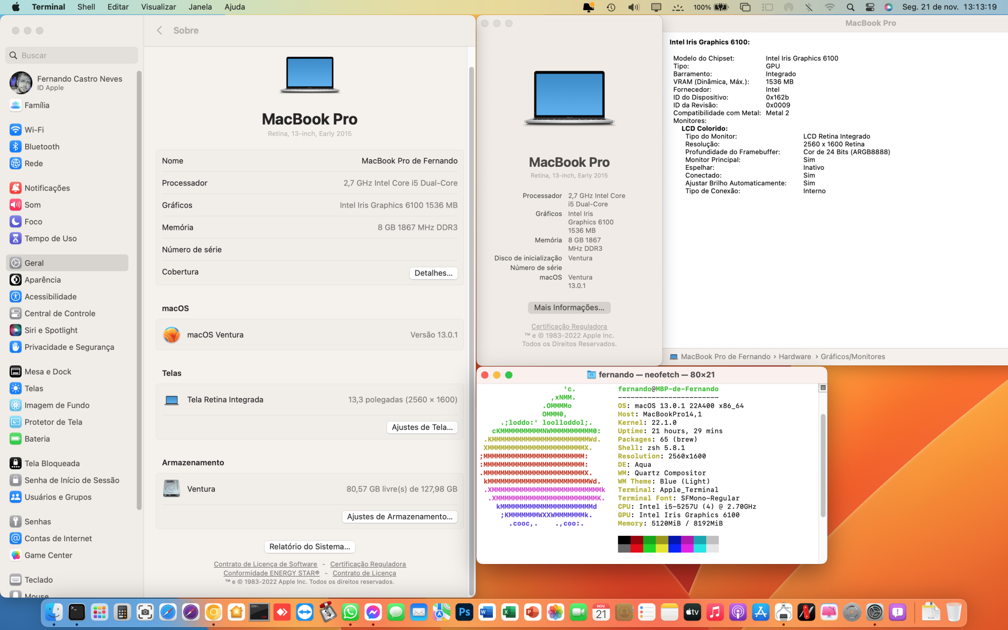

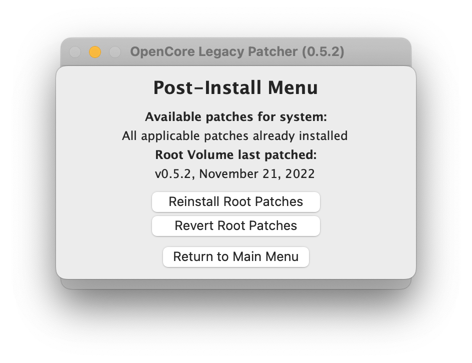

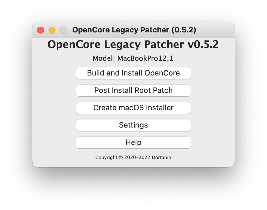

EFI's of Real Mac (MacBookPro12,1) - MacBook Pro 13'' Retina Early 2015 with Latest OpenCore 0.8.7 and Latest Kext's today's version 11-19-22.
OpenCore Legacy Patcher 0.5.2 Root Patches => Working Acceleration on my Intel Iris Graphics 6100 1536MB.
Has the latest kext's today's 11/19/22 version. From https://dortania.github.io/build-repo/
To work acceleration in Intel Iris Graphics 6100 with Ventura 13.0.1, you need to install OCLP 0.5.2 with Root Patches. => OpenCore-Patcher.app (GUI).zip
Hmm? Can you fill me in on what exactly hasn't worked with the acceleration before this?
