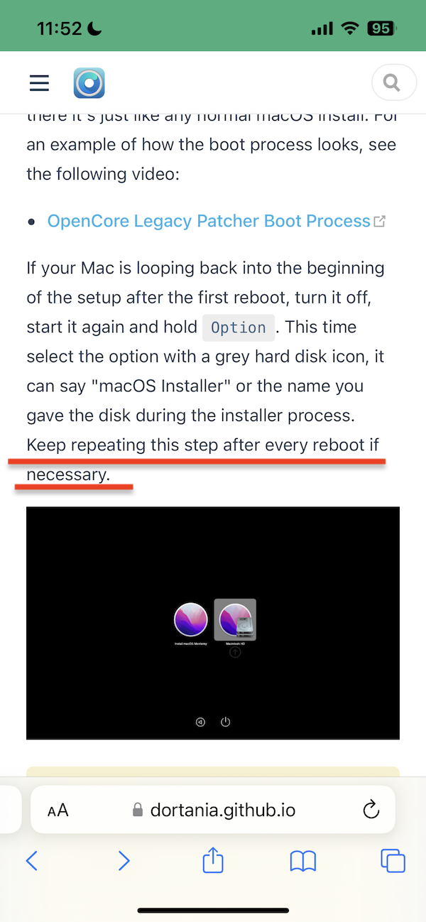

Dis you install from Usb device to a clean partition or an upgrade of Monterey?
I was then able to build my USB drive with OCLP and Ventura
Please follow the guide closely.
If you are creating the USB installer on another mac, you must choose carefully the right model of your target mac. The boot EFI created is specific to that target mac model.
Edit - with that error message, re-start the installer again and again. It will get through eventually. See guide underlined text.

I had the same error. I just keep trying and ater 4 or 5 times in installed fine, even tough I changed nothing.

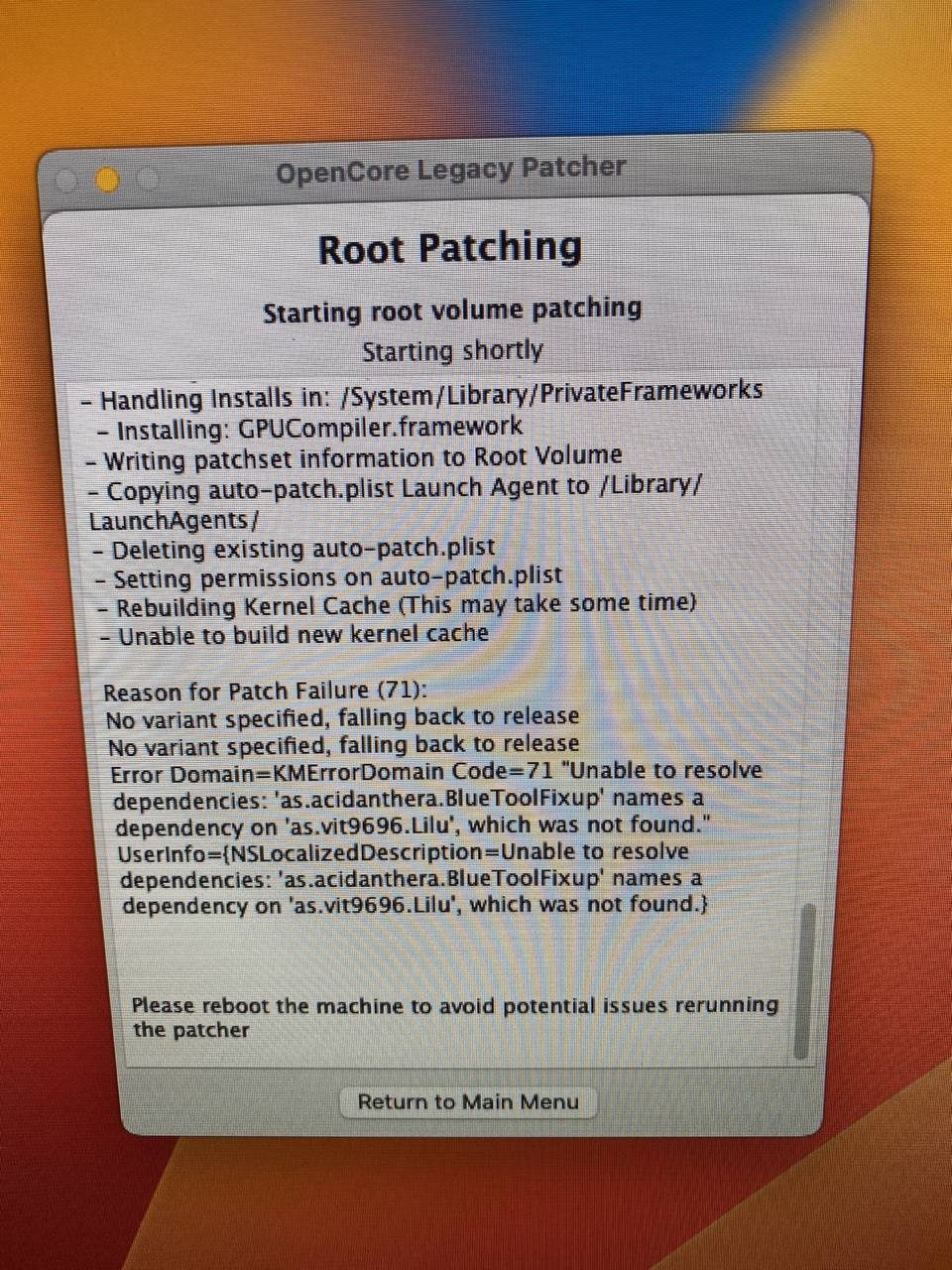

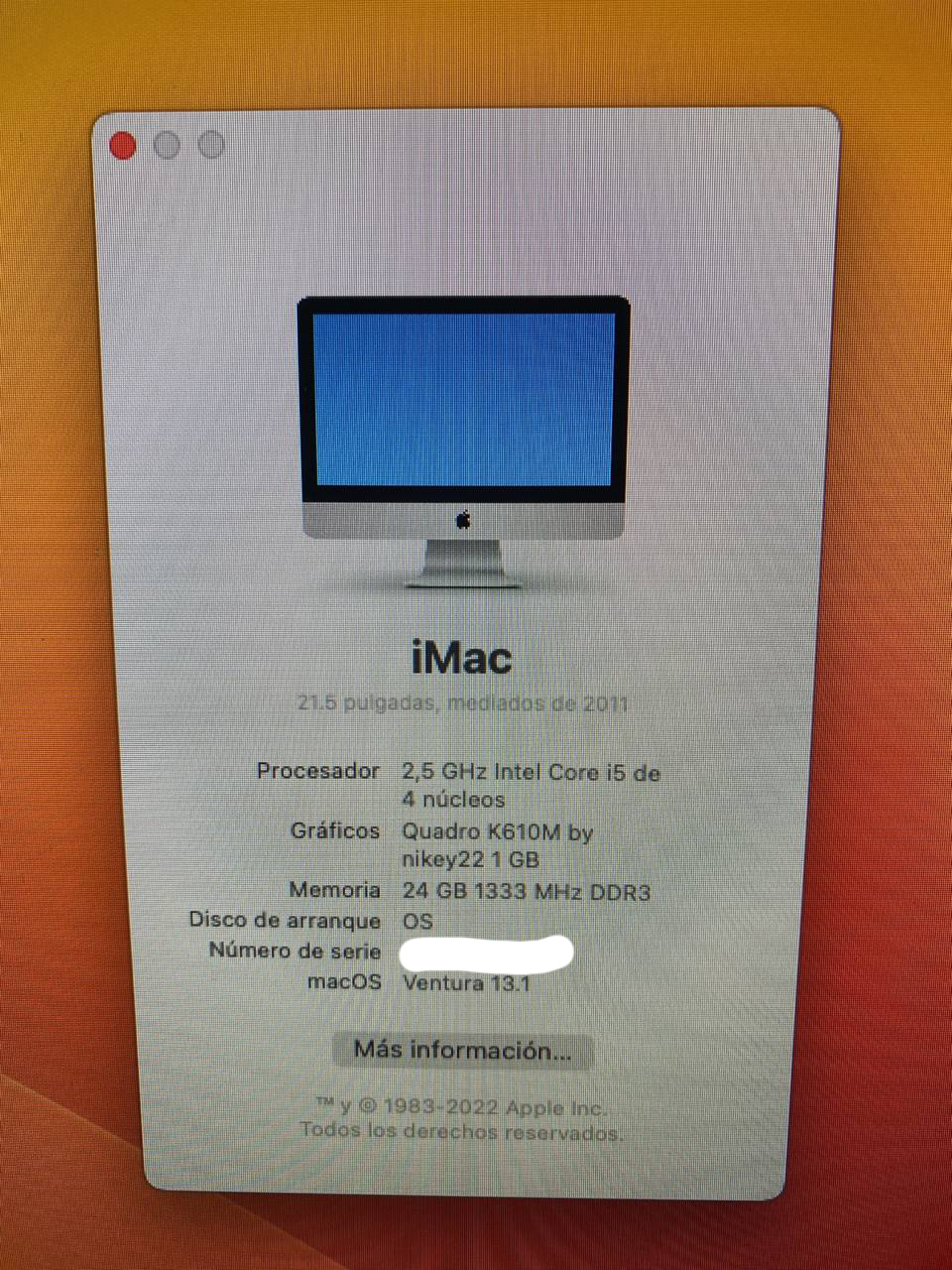

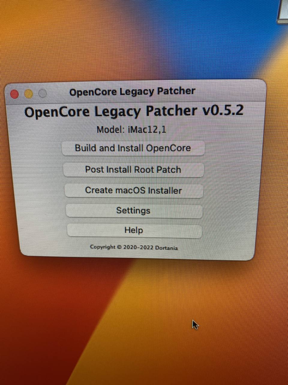

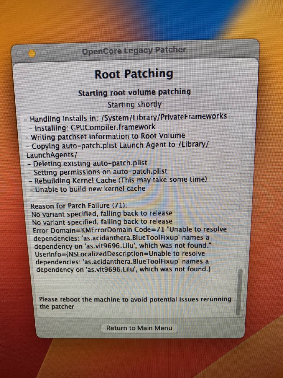

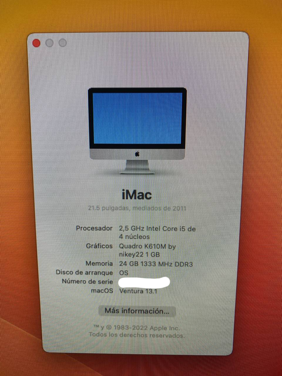

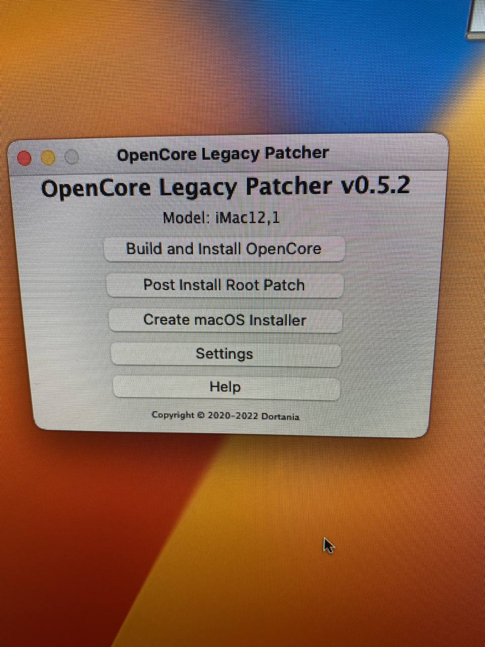

Hi, I successful install ventura in a 2011 iMac, all wroks, but when update to 13.1 beta and tried to reenable graphics acelerartion, OCLP show this error:
IMAGE 2022-11-15 15:11:40.jpg
IMAGE 2022-11-15 15:11:45.jpg
IMAGE 2022-11-15 15:11:51.jpg
