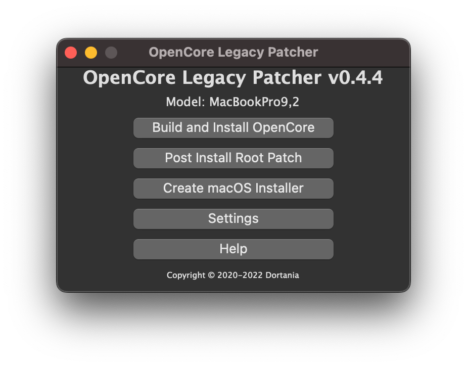

I need some assistance with OpenCore app so I can install Ventura on my 2012 Mac Mini. This person posted a YT video on how to do it, step by step. It looks easy enough however OpenCore does not give me an option to Build and Install OpenCore. That is grayed out even when I launch OpenCore. So when I perform Create macOS Installer and it tells me to install Ventura which it previously downloaded. It's on my Mac so no need to download it again. Once the process is finished I get the message that Ventura has been successfully installed and I click OK. The problem is my only option is to return to the main manu which looks like this picture with Build and Install OpenCore still grayed out. So I can't proceed. Am I doing something wrong.
First of all you'll need a newer version of OCLP. 0.5.0 and up support Ventura.
Reactions: rehkram
That pic came from the instructions on the OCLP website. I was using 0.5.1 and that's what happened. I then downloaded 0.5.0 just to see if it would make a difference and I saw the same but yeah I downloaded 0.5.1
I put OCLP 5.1 in my Applications folder. When I launch it, it says OpenCore Legacy Patcher v0.5.1 and Model Macmini8,1
The option to Build and Install OpenCore is still grayed out. I tried downloading it again and it still looks the same, odd.
Reactions: rehkram
First of all you must do a NVRAM reset - then boot in your supported system without efi boot. The problem is that there is a wrong oc efi boot spoofed your MM as 8,1. It should show 6,1 for MM 2012. Start 0.5.1 and device must be 6,1. You can use opencore configurator for easy mounting the efi partition and delete oc folder and build a new one.
Reactions: Heat_Fan89
Am I the only one having problems playing YouTube Videos (Macmini7,1) using Safari?
Chrome playing fine.
Oh snap, I totally forgot to mention that I downloaded and tried to do the build on my 2018 Mini. So perhaps that's the problem. I can easily do that on my 2012 Mini. That should solve the problem. Kudos to you for figuring it out.

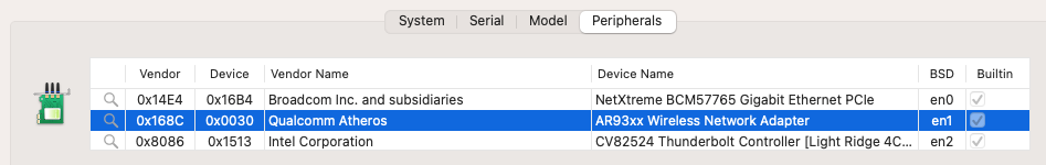

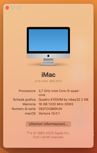

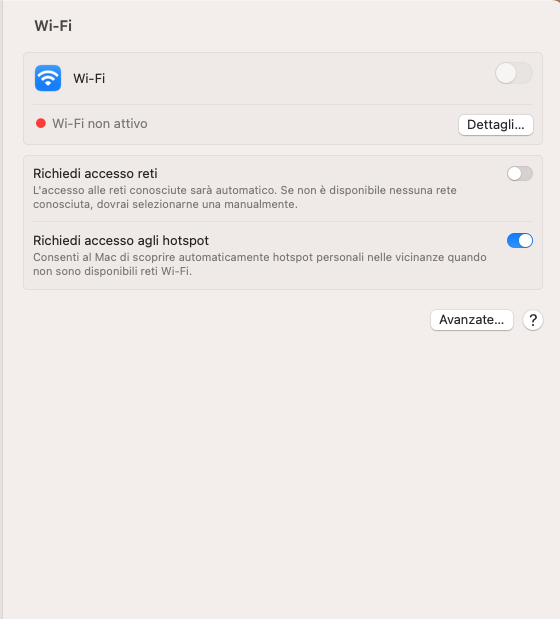

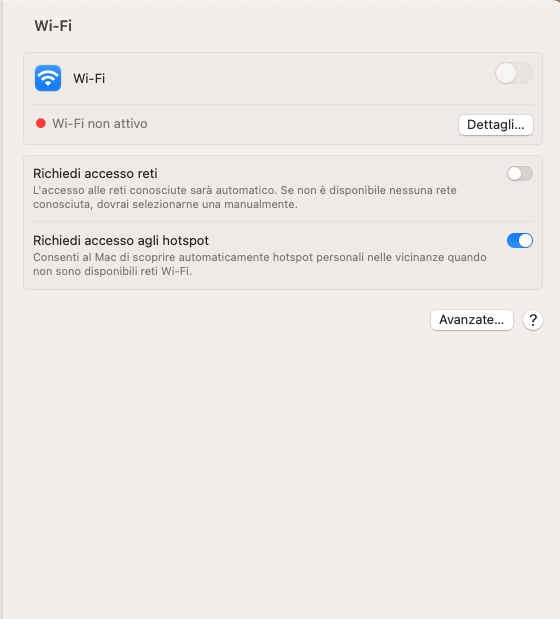

imac 21.5 2011 with updated video card nvidia quadro k1000m 2GB (was Radeon HD 6770M), installed Ventura 13.0.1 from monterey 12.6.1... everything runs fine for now, even the apps that required metal to work and be installed.. ONE BIG PROBLEM: wifi doesn't activate, the slide stays on "deactivated" and doesn't move... I obviously installed the "postinstall patch", but.... you can navigate with an iphone connected to USB and sharing active , but no wifi for now... HELP!!
This is expected. Currently neither OCLP or Ventura support the 2011 iMac. Having said that, you could make it to work if you upgrade the stock wifi card to a newer one. You can read about it here. #
ahh ok... we didn't want it... what a pity!!!

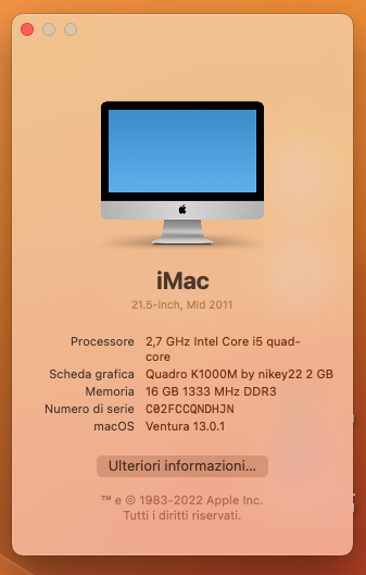

Just finished installing macOS Ventura on my 2011 21.5" iMac.
hi, does wifi work? I have the same Mac 21.5 2011 (with quadro k1000m 2 GB), installed ventura, everything works except wifi because the built-in atheros card is not supported by OCLP and Ventura, Did you change wifi card? or do you use anything else for wifi?
