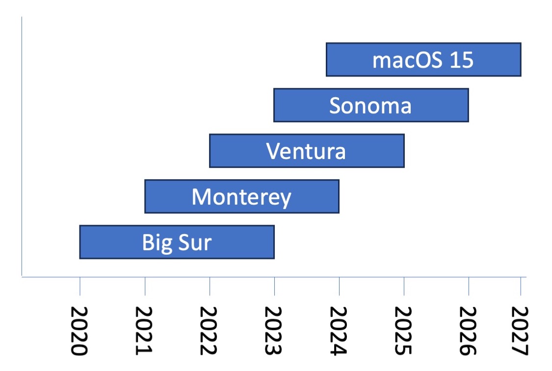

Apple just released an update for Big Sur (which was released in 2020) which implies 3 years of released updates from Apple for each version of macOS. If Apple releases only one more Intel-Mac compatible macOS next year, that means Apple support of Intel Macs for almost 4 more years (maybe more). That's a long life expectancy for OCLP, too! :)
EDIT: Maybe someone who's better at math can check my logic.
I haven't looked. The last Big Sur update I saw just recently (Sept. 11, 2023) was 11.7.10. Wouldn't surprise me if that was the last for Big Sur, but I never say 'never.'
I was responding to your post where you said "Apple Just released an update for Big Sur" which implies there was newer. If you were referring to 11.7.10 apologizes, just wanted to make sure.

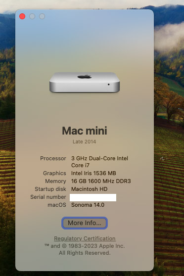

Got a late 2014 MacMini [7.1] - was running Monterey 12.7 Monday morning. But later that day I discovered OCLP 1.0.1, and did a successful update to Ventura 13.6 - everything seemed painless and worked fine.
So a few moments ago I created a Sonoma USB Installer and did the update to Sonoma 14.0
Drive/File access is a bit slow (as I might expect) but otherwise seems to be running fine.
Just to clarify - no complaints.
I do plan to go to one of the AS minis within the year, but for now,
it's nice to have the current OS available! So yes, Thanks!!
(I did make a contribution to the OCLP team to show my thanks!)
