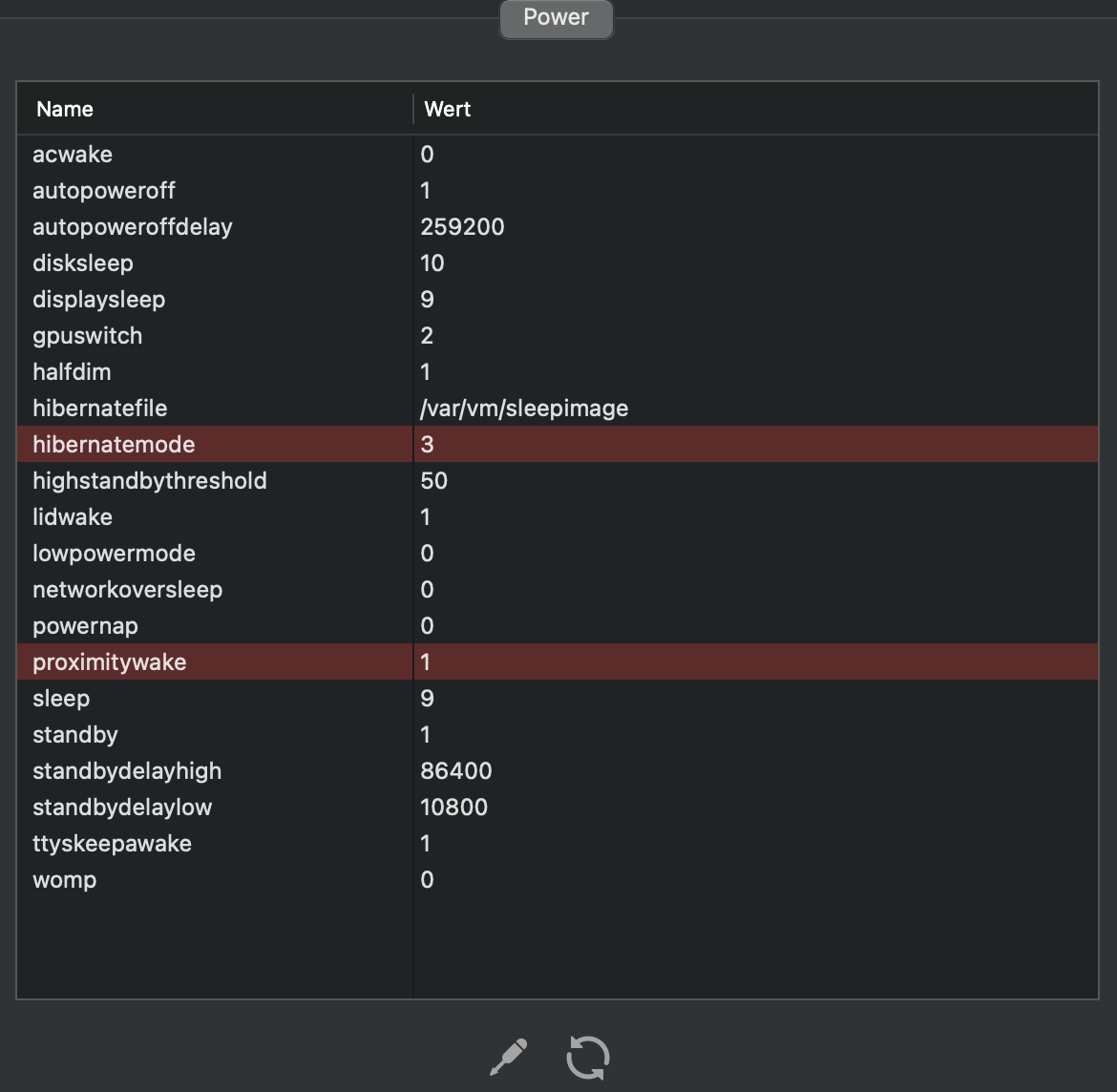

No change here overnight after SMC and NVRAM reset. The MacBook Pro is off and turns on as soon as the lid is opened. That would have been too easy :) ...
In the console again the same diagnostic report.
Code:
Sleep Wake failure in EFI
Failure code:: 0x0171260e 0x0000001f

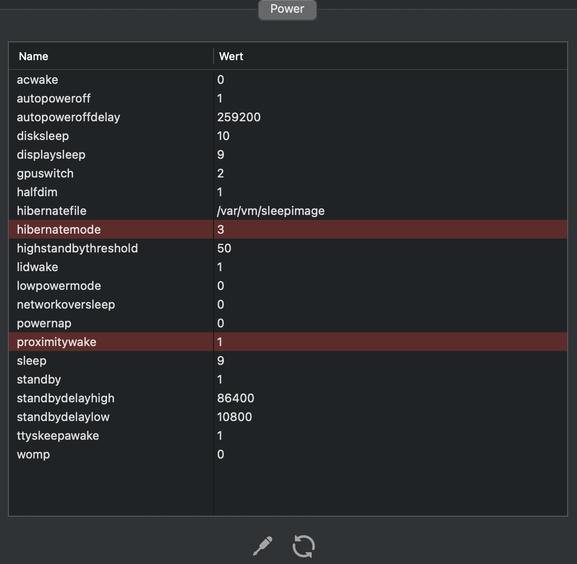

Here are my current power settings BTW – didn't change anything since the SONOMA installation on the MacBookPro14,2 (macOS 14.1 (23B73), OCLP 1.1.0n):
Code:

I've now tried Hibernation 0, it works but it loses about 15% battery overnight. What happens when the battery runs out does it shut down or just crash?
I suggest to familarize yourself with what the pmset parameters do before changing them on real Macs.
Hibernatemode is highlited in red in Hackintool, because Hibernatemode usually is not working on Hackintoshes out of the box and it's therefore recommended to change it to 0 (suspend to RAM) because Hibernatemode 3 or 25 can cause issues. Dortania's instructions are primarily aimed at PC users to address these issues (most of these fixes are not applicable to real Macs anyway…)
So before changing any of these settings on a real Mac you should first figure out what causes the system to not enter sleep. You can use Terminal to do so:
pmset -g log | grep -e "Sleep.*due to" -e "Wake.*due to"
Next, check the results and see what causes the issue and how to address them. Sometimes it's a PCI device prohibiting entering sleep. In this case this can be adddressed by simple injecting a different ASPM state for the device in question via DeviceProperties in the config.plist.

Agree with everything said about pmsettings. Devs are working hard to enable power management on Macs that are no longer supported in Sonoma. As Devs restore and/or enable power management for unsupported Macs (e.g., by using Open Core to inject kexts like AppleIntelCPUPowerManagement or CPUFriend which are NOT required when macOS natively supports the Mac), the real Mac may develop some characteristics of a hackintosh.
As I said before, we're driving the car while the Devs are building the engine. And we're now using Open Core to boot real Macs. Some of the Developer techniques used to boot macOS on unsupported Macs are the same techniques used to boot macOS on hackintoshes.
Not wanting to offend, not wanting to have my way, not wanting to prove anyone wrong... It's just a fact that we now have real Macs with a split personality: part real Mac and part hackintosh. The line between the real Mac and hackintosh is at the very least blurred a little.
EDIT: For example, in hackintoshes, it is not uncommon to disable "Wake for Network Access" and "Enable Power Nap." Disabling these in macOS Energy Saver settings fixed the EFI wake issue for this real Mac user. Fixing sleep/wake issues is probably going to require solutions that differ for each Mac Model. Finding the solution that works is going to require some trial and error and may include testing some solutions that are recommended for hackintoshes. Note that this Dortania reference recommends disabling Wake for Network Access and Power Nap.

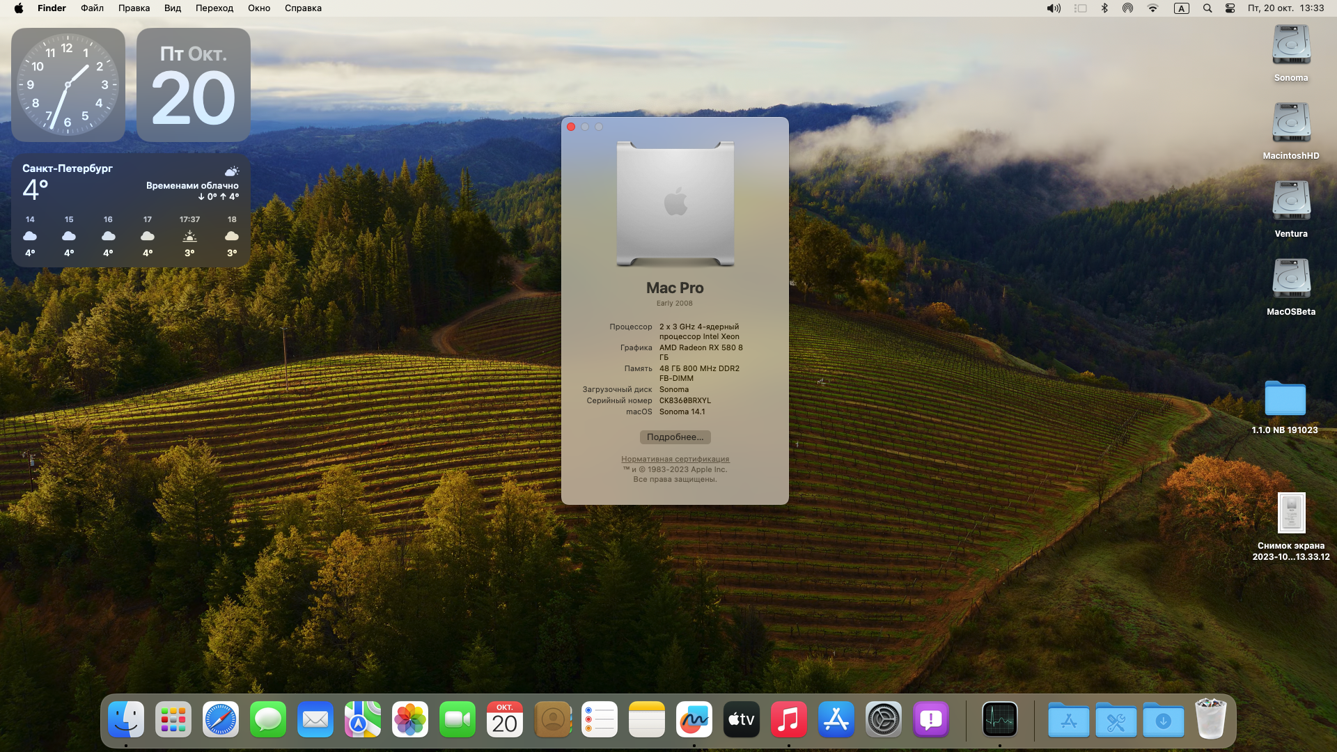

I thought the Devs fixed this with AMFIPass.kext (which allows unsupported Macs to boot with AMFI enabled). Are there still some Mac Models that require AMFI to be disabled?

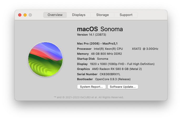

I think you don't fully understand. To activate AMFIPass - you need checkbox "disable AMFI". For work with CGN legacy drivers or Modern WIFI drivers - you need to check "disable AMFI".
Agree that there is definitely a misunderstanding. In order to activate AMFIPass, you need to uncheck "Disable AMFI." AMFIPass.kext is always included in the OC config.plist. Checking or unchecking "Disable AMFI" in the OCLP GUI does not enable or disable AMFIPass.
EDIT: For some Mac Models, AMFIPass (activated by UNCHECKING "Disable AMFI" in the OCLP GUI) has worked since OCLP 0.6.7 or 0.6.8 (don't remember which version). I was simply asking if some Mac Models still require the checkbox "Disable AMFI" to be checked.
EDIT2: If you would like to see what happens when you uncheck "Disable AMFI," look in the Open Core config.plist generated by OCLP. You will see that when you uncheck "Disable AMFI" in the OCLP GUI and then "Build and Install Open Core," the OC config.plist generated by OCLP will include AMFIPass.kext does not include boot-arg "amfi=0x80" and does include AMFIPass.kext. When you check "Disable AMFI" in the OCLP GUI and then "Build and Install Open Core," the OC config.plist generated by OCLP will not include AMFIPass.kext and instead will includes "amfi=0x80" boot-arg and kernel patches (to disable AMFI) and still includes AMFIPass.kext.
EDIT3: It is very important to note that when you check or uncheck "Disable AMFI" checkbox in the OCLP GUI, this setting will not take effect until you "Build and Install Open Core" and then reboot.

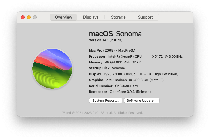

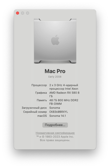

Maybe you first try it on REAL old mac??
I check the box "Disable AMFI" and i get AMFIpass.kext in my EFI folder on my real CMP 3.1.
I don't know, what tell about this your friends - alien reptiloids, but it's real case.
Reactions: deeveedee
I stand corrected - you are correct. At some point during the Beta testing of AMFIPass.kext (I hadn't noticed this), OCLP is now keeping AMFIPass.kext regardless of whether "Disable AMFI" is checked in the OCLP GUI. I'm not sure when this changed and will need to look back in commit history. I never reexamined this after the AMFIPass.kext beta testing completed, so that is clearly my mistake. It now looks like AMFIPass.kext is always injected and that checking "Disable AMFI" adds "amfi=0x80" boot-arg. Thank you.
My question remains... I thought that Devs fixed OCLP so that AMFI no longer needed to be disabled. I wasn't aware that there were still Mac Models that needed "Disable AMFI" to be checked.
EDIT: I will modify my previous post to indicate that AMFIPass.kext is always injected and that checking "Disable AMFI" adds "amfi=0x80" boot arg.
