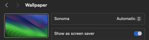

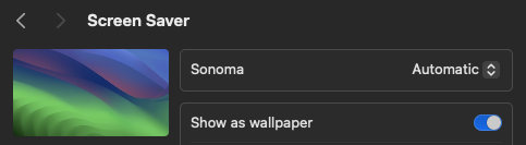

@mikelets456 Is probably correct in saying that it is the WallPaper that makes the difference. I indirectly set my Sonoma WallPaper through the "System Settings > Screen Saver" by choosing "Show as wallpaper" in the Screen Saver setting.
Also see "System Settings > Wallpaper"
Reactions: mikelets456

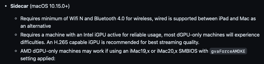

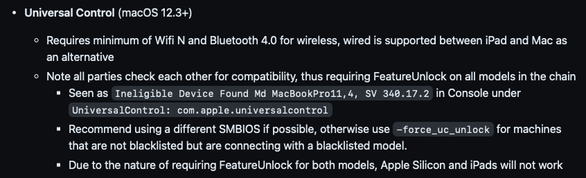

Clever. What made you think to do this? Do you know what feature you lost when you changed FeatureUnlock from Enabled to Partial? Well done.
EDIT: I diff'd the config.plists for full and partial FU and found that setting FU to Partial adds boot-arg '-disable_sidecar_mac' which "disables Sidecar/AirPlay/Universal Control patches"
Here are the FeatureUnlock.kext notes for Sidecar:

Here are the FeatureUnlock.kext notes for Universal Control
