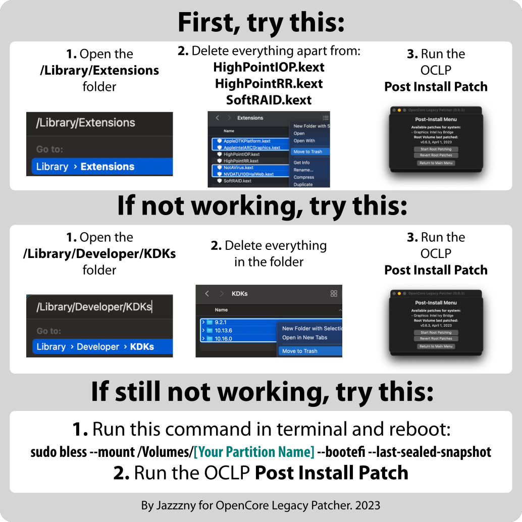

Assuming that @davidlv is on the right track, maybe you need to manually remove patches and try again? I'm guessing, but can't hurt (famous last words).
Manually remove patches:

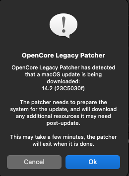

Upgrading Sonoma 14.1 (Release) to 14.2 Beta (patched with OCLP 1.2.0n built 11/5/2023 with Python3.11.5). This is the first time I'm seeing this:
Saw that sort of notice when upgrading to the 14.1 final - just said ok and allowed it to install the necessary. Worked perfectly after a couple of switch offs and reboots.
Upgrade from Sonoma 14.1 (Release) to 14.2 (Beta 23C5030f) proceeded without issues on my MBP6,2 (non-metal Nvidia Tesla) patched with OCLP 1.2.0n (built 11/5/2023 with Python3.11.5). I first patched 14.1 with OCLP 1.2.0n and then performed the macOS upgrade via OTA (which downloaded the full macOS installer). My Open Core EFI is configured with AMFI and Library Validation fully enabled and FeatureUnlock = Partial.
When I initiated the macOS upgrade, OCLP detected the upgrade and asked permission to "prepare the system for updates." Not being familiar with this new prompt, I clicked "Cancel" to the OCLP prompt and then manually applied OCLP 1.2.0n post-install patches after the macOS upgrade was complete. I did not revert root-patches at any time during this upgrade.
EDIT: I established and maintained a wired-Ethernet connection during the entire macOS upgrade and OCLP post-install patching process.

Sorry but start over reinstalling 14.1 with oclp 1.1.0. Wipe the drive.
I updated to 14.1 from the USB installer. This completely cleared the remnants of the previous OCPL. Then I installed the OCPL 1.2.0 patch in safe mode and everything works. Wi-Fi worked in safe mode even before the patch was installed. I didn't have to connect it to ethernet.
