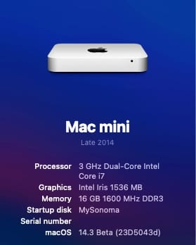

macOS 14.3 Beta 2 is now available OTA. Installed atop Beta 1. OCLP v.1.4.0n. Runs as expected :apple::)
