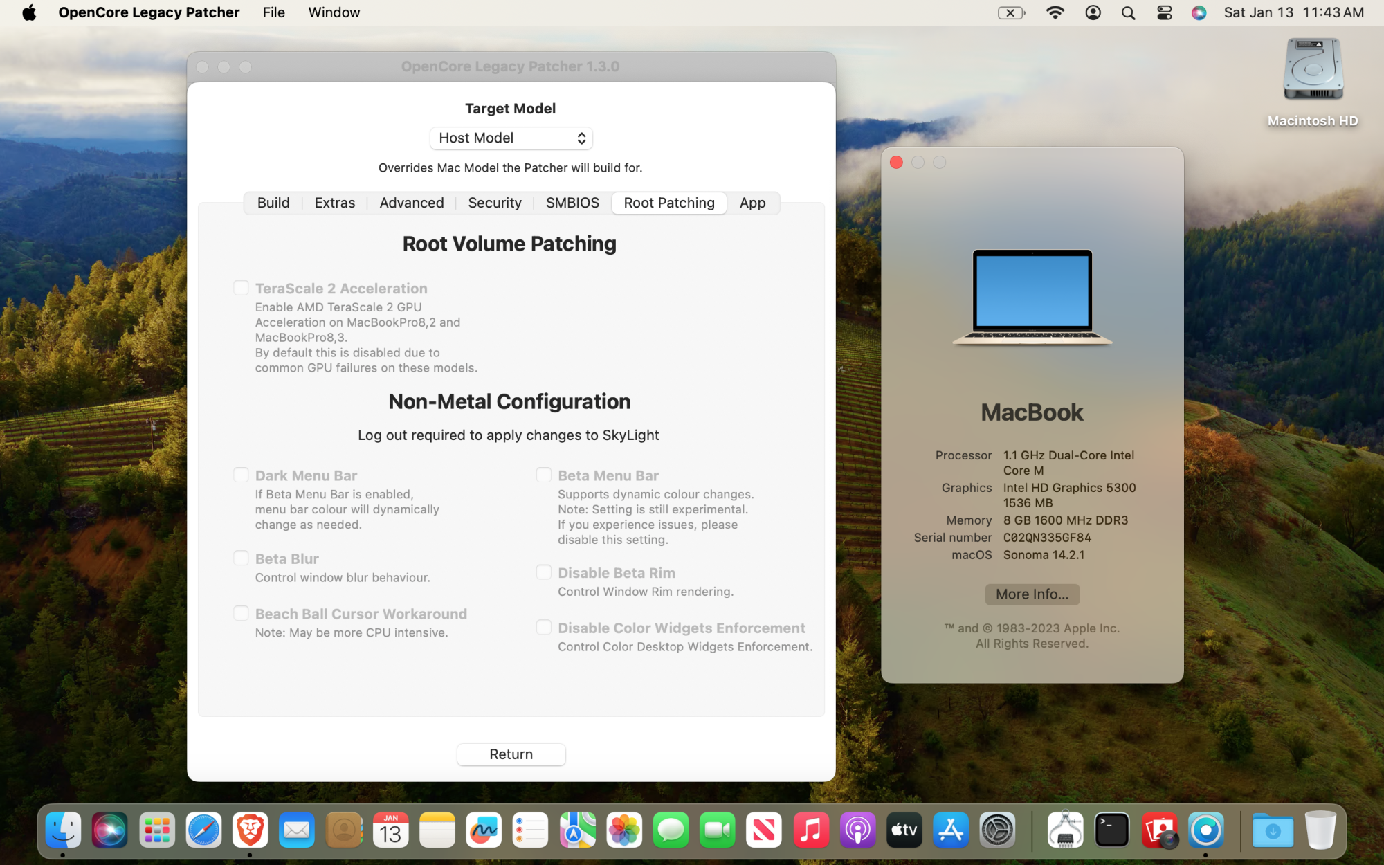

Macbook 8,1 OCLP 1.3.0 Sonoma 14.2.1. Works perfect.
Somehow I got "You shut down your computer because of a problem" on every boot. This solved it ( link )

how do you find your MBP 8,1 on Sonoma. You are the first I have seen post having it on.
I'm currently on Montery but considering updating soon.
Anything special you needed to do?
