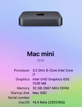

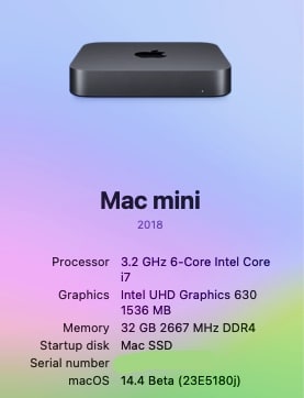

Installed macOS 14.4b1 OTA onto a supported Mini8,1, runs as expected. :cool:

After sometime running macOS 14.4b1 on a supported Mini, I noticed a big increase in demand of CPU time and memory compared to macOS 14.3 suggesting Macs with 4GB of RAM, even 8GB will notice a substantial decrease in performance once the OCLP devs sort-out the post-install patch issues brought about by macOS 14.4. FWIW 🤔
