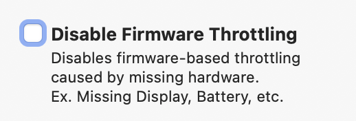

That´s what the setting is for in OCLP:Has anyone tried booting a MacBook Pro 2014 without a battery on Sonoma? is it possible to? Can it run at full speed ? (Or any MacBook without battery?)
Done a it a few times on a 2012 rMBP for various reasons. It will semi-work but lack the proper current to do certain things that the battery is needed for regardless. So maybe not usable for anything "serious". If you are reluctant to buy a battery for some reason, borrow one for tests you may need? But it should boot.Has anyone tried booting a MacBook Pro 2014 without a battery on Sonoma? is it possible to? Can it run at full speed ? (Or any MacBook without battery?)

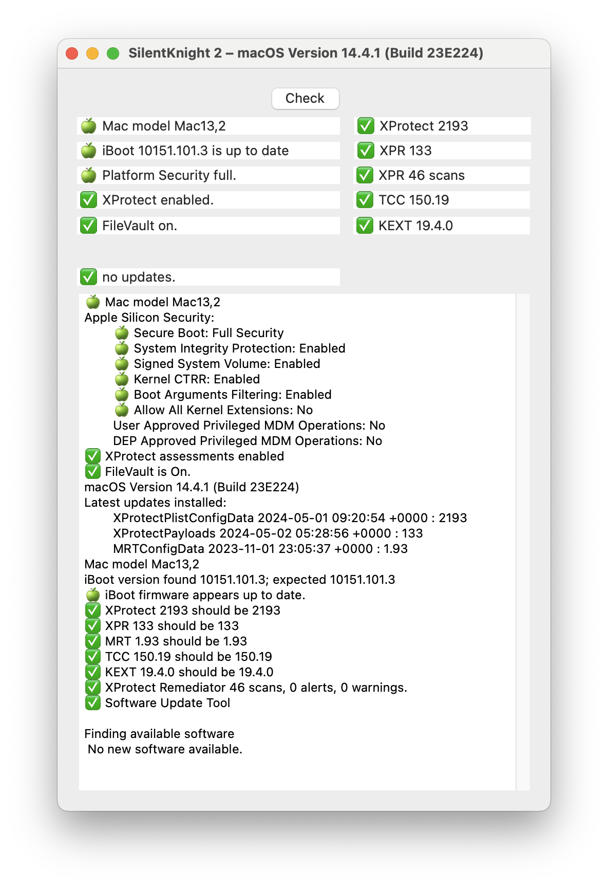

SilentKnight is a good tool that will tell you about the latest software updates and also tell you if your firmware isn't running the latest version.
SilentKnight, Skint, SystHist, silnite, LockRattler & Scrub
SilentKnight 3 – fully automatic checks of security systems in Apple silicon Macs Successor to SilentKnight 2 for Apple silicon Macs. Simpler and easier to use, with even more detail, and rep…eclecticlight.co

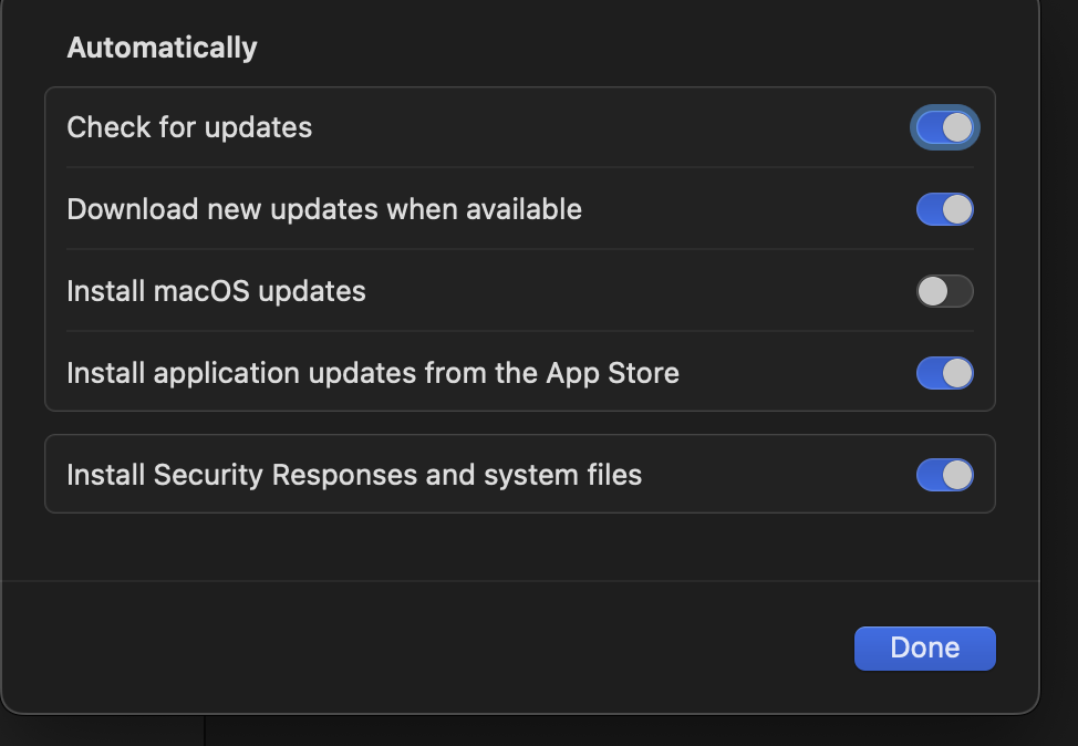

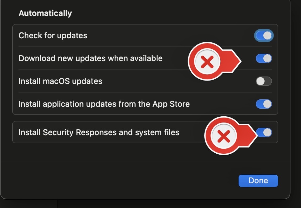

Safest to leave the last option turned off as well and manually install those updates.I've had about 7 responses to my original question and (unless I've missed the point somehow) none have so much as mentioned the issue let alone any answer; there seems to be three types of updates; System/Firmware and Security with some overlap, you seem to have clearly confirmed what I already understood i.e. that an OCLP OS cannot get firmware updates so checking it seems to be of no value. I just went into Settings/updates and discovered that settings had altered; I certainly had them all on off except for the first one; my original query was about the last one but now it seems that these options are only for finger exercising - unless I had them set in safe mode and they somehow revert; anyway this is now bigger question than my original one and raises another question: should I just pay for Win11 and abandon this bizarre "Alice in Wonderland" Apple/OCLP combo? View attachment 2375000
Toggle this off – or you will get problems earlier or later!I've had about 7 responses to my original question and (unless I've missed the point somehow) none have so much as mentioned the issue let alone any answer; there seems to be three types of updates; System/Firmware and Security with some overlap, you seem to have clearly confirmed what I already understood i.e. that an OCLP OS cannot get firmware updates so checking it seems to be of no value. I just went into Settings/updates and discovered that settings had altered; I certainly had them all on off except for the first one; my original query was about the last one but now it seems that these options are only for finger exercising - unless I had them set in safe mode and they somehow revert; anyway this is now bigger question than my original one and raises another question: should I just pay for Win11 and abandon this bizarre "Alice in Wonderland" Apple/OCLP combo? View attachment 2375000
I had it off but it seemed to get turned on by some unknown entity/programme; it's remained off for one day. Don't updates requiring patches automatically produce a notification from OCLP? (I left a device for hours after an update and there was none but this may be time related). I had the bottom setting on for months and never got any prompt; so what you are implying is that they will or may lead to instability and best to wait for them to be included in the "normal" updates?Toggle this off – or you will get problems earlier or later!
That's what I've concluded but it's basically only guessing; it's more prudent regarding OCLP and less so for security but I suppose security is around 99% user carefulness - but then I don't know what protection has been used with these apparently near daily "updates".Safest to leave the last option turned off as well and manually install those updates.

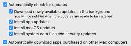

About the "Install system data files and security updates" checkbox in App Store prefs
Check your settings in the App Store System Preference Pane. By default Install macOS updates is not checked. If you checked it and now do not want the updates to install automatically, uncheck it. Do not uncheck “Install system data files and security updates”, this should always be enabled.talk.tidbits.com
