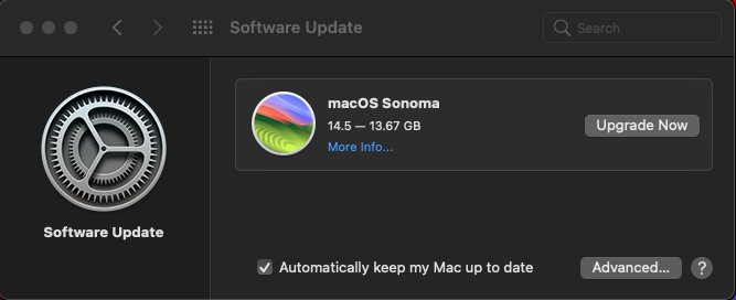

Hi,
My Mac (MBP 15'retina late 2013 with Kepler 11,3 , macOS 14.4.1, OCLP 1.4.3) had updated 14.4.1(23E224) -> 14.5(23F79) via OTA.
And I did reboot and post-root-patch in safe mode (show boot selector by reboot+CTRL -> Select boot volume with Shift+Return).
After that MBP reboot, it could get back WiFi and logged in normally.
Thanks to OCLP Developers !!

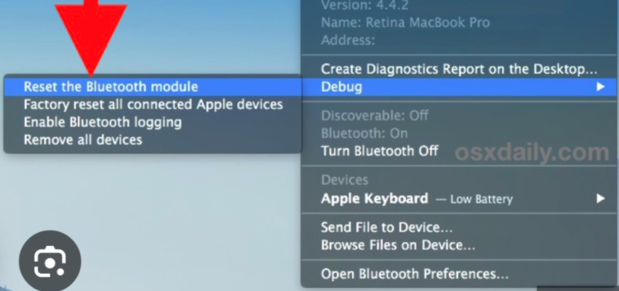

Now only bluetooth connection to magic mouse is the problem :/
I click on Connect, but after that when it says connected, there is no device on My Devices and it is not connected.
I have had the same problem.
Fix: Factory reset the MM itself. Removing batteries won't do. Launch HighSierra (or any OS where that option has not been removed). Pair the mouse there. Use "Factory reset all connected Apple devices".
To do that shift option click the Bluetooth icon in the menu bar there, find the debug menu, reset the device and pair it then in Sonoma.
Apple did remove the option in some of the MacOS's thereafter. Don't bother looking in BigSur for instance.

I don't have another mac with installed High Sierra. Also where to find that debug option for bluetooth in Sonoma?
