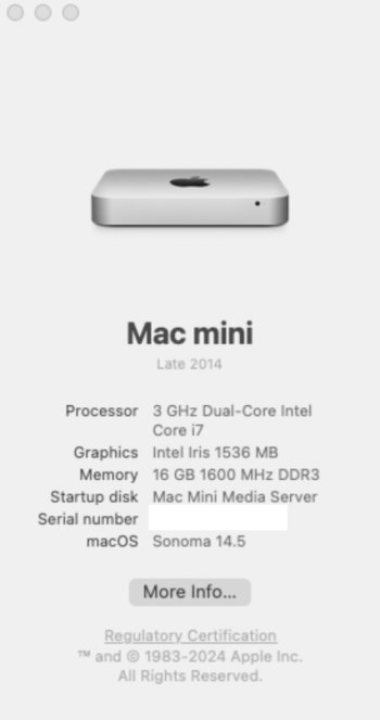

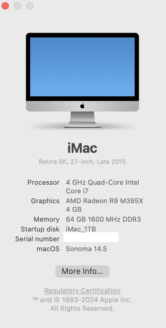

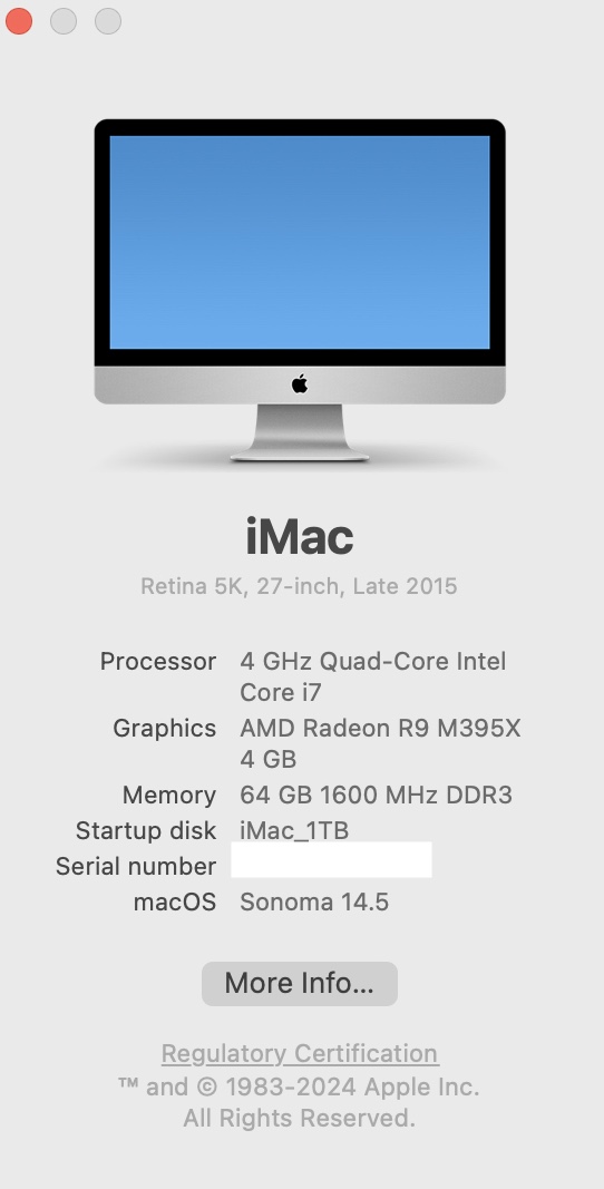

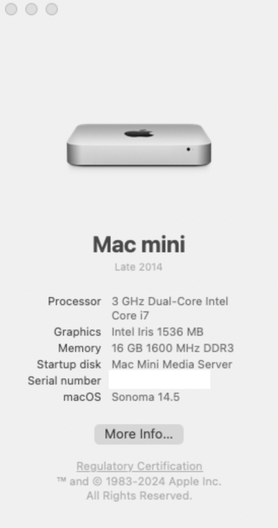

I have successfully updated my 2 Unsupported Macs to 14.5 with OCLP 1.4.3.
2014 MacMini 7,1 i7 16GB/500Gb
Late 2015 iMac 17,1 i7 64/1TB
My trusty update method is:
Backup with CCC
Download "InstallAssistant.pkg" (Thanks to Mr.Macintosh for the links)
Installing into each machine's Application folder. This saves me doing 2 OTA downloads.
Run Onyx/Maintenance
Re-Start
Install macOS Sonoma
Install root-patches
Re-Start
re-run Onyx/Maintenance
Re-Start.
So far OK on both Macs with Sonoma 14.5.
BIG Thanks to the OCLP Developers!
~And all the helpful people here on MacRumors!!

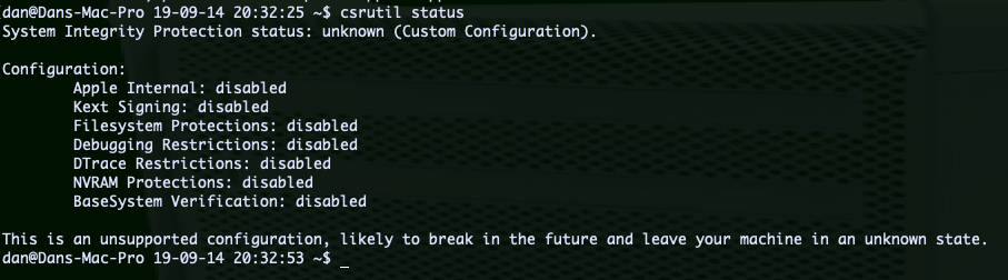

What does the csrutil command (in terminal not in recovery) report for your SIP setting with dosdude?

In this post, he explains exactly how his SIP.patch interferes with the system. Its patch permanently patches the system file and SIP is always disabled. Even if the OC writes the values we manually added to the NVRAM, it does not actually activate it because dosdude's patch prevents this.
By the way, even if you intervene from recovery, it does not help. His patch makes SIP always disable.
This post it's also showing how dosdude SIP settings looks like

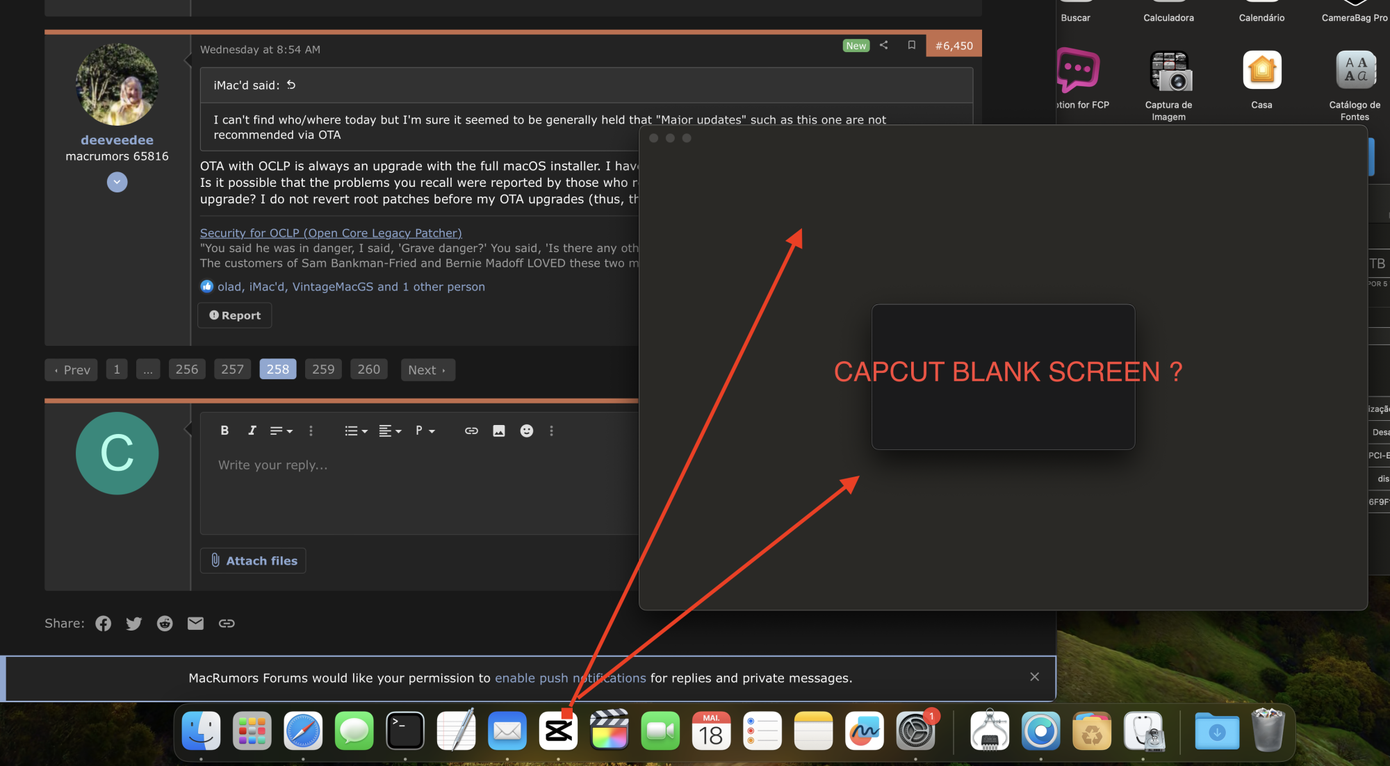

Why do I get this black screen on CapCut? - Sonoma 14.5
Parralels Desktop also receives this same black screen.
OLCP 1.4.3 iMac 5k 2014 AMD Radeon R9 M295X 4GB
I've already tested Sonoma 14.5 and the same thing happens, I've tested all the color profiles, it doesn't work
Edit: cause of blank screen is driver wireless install after install OLCP 1.4.3
Got it. As I never used dosdude's Catalina patcher I didn't realize that's what he did. It makes sense - similar to what OCLP does because it's patching system files and requires SIP to be lowered. OLCP just does it through NVRAM.

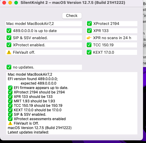

Yeah, I swapped from my third party storage in my 2015 MBA to a $18 OEM one so I could update the firmware (by OS Recovery of the latest macOS).
Strange - silentknight doesnˋt find a new firmware update with native Monterey on my MBA7,2.
