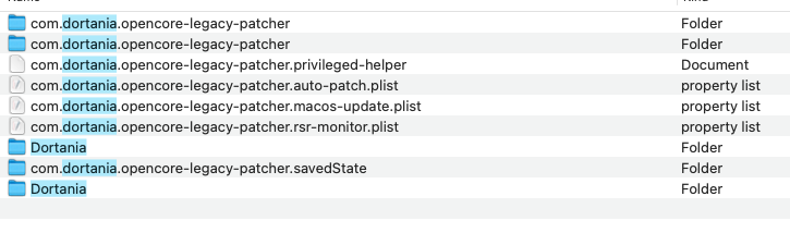

Need some advice on uninstalling OCLP. I switched from an unsupported headless MBP 2016 running OCLP 1.50n and Sonoma 14.5 to a supported M1 MBA 2020 running Sonoma 14.5 by using a Time Machine backup and Migration Assistant from the 2016 MBP. At first boot after the account migration I got a message that there is a new OCLP 1.6 version and would I like to upgrade. I assume this came from a copied Dortania folder in /Library/ApplicationSupport, which I have now deleted. Is there anywhere else I should look in the file system to check that no other remnant of OCLP was migrated across?

When attempting to D/L the current KDK for macOS 14.6 you will get this - KDK for macOS 15 (24A5279h)
Library/Extensions and Library/Launch Agents
Here,too. Was interrupted by a Cloudflare issue like others have reported.
Get Find Any File from the App Store, a great search tool.:cool:
Reactions: nekton1
