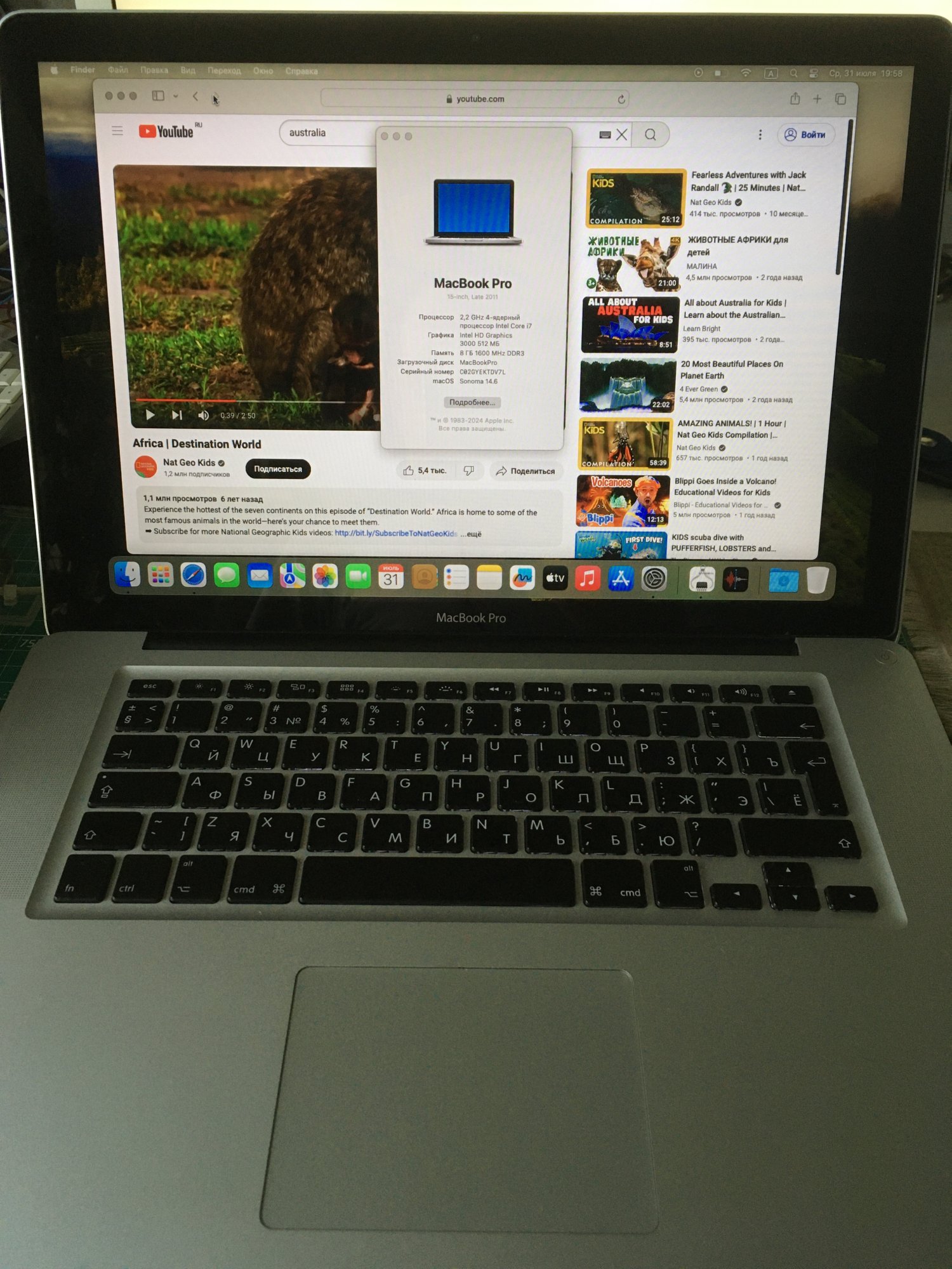

Sonoma successfully installed and running on MBP 8.2 (late 2011) with 8 Gb RAM 240 Gb SSD.
Camera, BT, WiFi - all seem to be okay.
Laptop didnt want to boot up (black screen) until I applied NVRam "gpu-power-prefs=%01%00%00%00" trick.

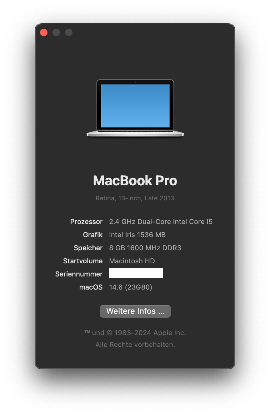

Just sharing the experience: Ran 14.6 as OTA. When state was in "preparing 35min left" i had to leave, did close the lid and left the 9,2 overnight like that. This morning the system presents itself as 23G80. This was unexpected. Ran the 1.6.0n patches. Everything feels solid. No hickups whatsoever. Anyone else had seen this before?
Why unexpected? Power Nap.

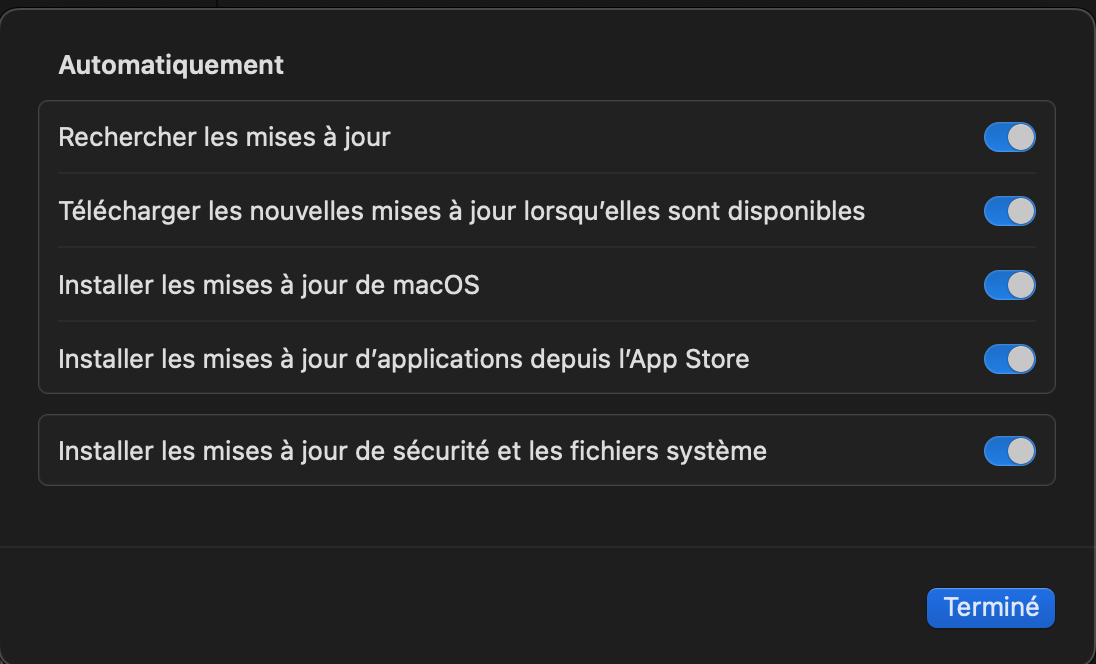

Now, what about automatic update : enable or disable ? what is your feeling ?
it is also in this thread if you do a search ;)
People have different strategies with this. Mine is to have all automatic downloads switched off and do it manually as especially the Rapid Security Responses (whatever that is in French) appear to have caused issues for some users here. Good luck.

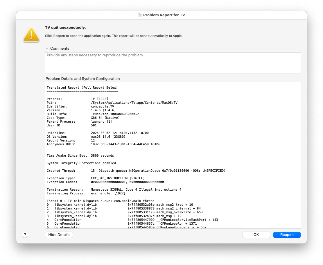

I'm coming up against a completely reproducible bug on Sonoma 14.6, OCLP 1.5. This is a Mac mini late 2012 that I use as a media server, although it's really a redundant backup to a Mac mini M1 I bought to replace it.
Sonoma 14.5 on OCLP 1.4.3 was actually very unstable for me: frequent kernel panics. 14.6 on OCLP 1.5 seems a lot better, in every respect but one: the TV app. I'm getting a crash when I click on any of the options in the Library. As I say, this is connected to my TV, so in many ways it is what the Mac is for… The beginning of the error is also screenshot. I've deleted the preferences and started again with a new library. With new preferences, the Apple TV and TV+ options are fine. It's the Library options that cause a near-immediate crash. I thought maybe one file might be corrupted, so removed all the contents, with the idea to add them back one time. It doesn't matter: it still crashes, even with an empty library. Interestingly, even going to home sharing to the Mac mini M1 (with the idea to reimport) also causes an immediate crash. I try to keep the Mac mini M1 file for-file-identical, including not running beta software on it so I could restore from its backup to the Mac mini late 2012. Its TV.app is working perfectly, with the same files. (incidentally, almost all are old or very old BBC shows or other video I've edited or clipped up: it's not some wrong-side-of-the-tracks .mkv! No judgment: I'm just saying I don't think this is virus or malware related, for troubleshooting purposes.)
Anyone run into this? All Google detailed specific searches are bad now as I'm sure we all know, but the most relevant thread seems to be this one on Reddit, though it's about Monterey. The problem is exactly mine though. If I read it right, the OP had Apple replace his hardware! Not exactly an option with a 2012 Frankenmac… The only other point of difference that I can see is I am running OCLP, which is why I'm posting here in case one of you guys thinks I've overlooked something.
Thanks!

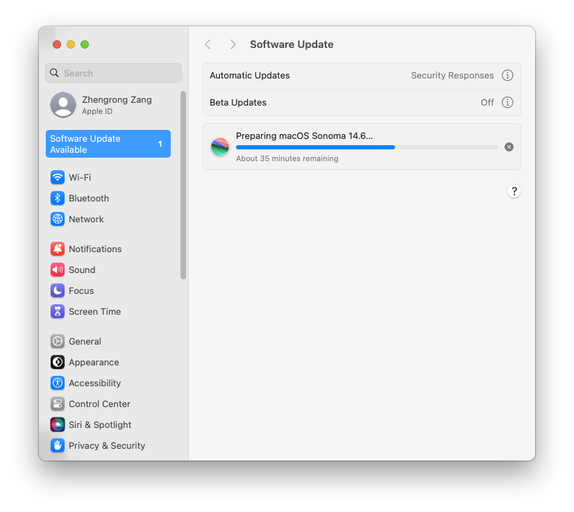

I use OTA to update mac mini 2009 Late from 14.4.1 to 14.6, the "About 35 minites remaining..." showing after downloaded KDK 23G80, how long do I have to wait?
Wait, it will work if everything else is ok ;-) in my longest case it was nearly 65min! Never aborted it, but it shoult also be safe to abort, and start over again... Good luck.

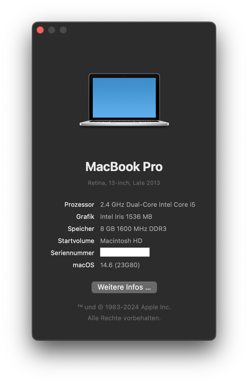

MBP11,1: 14.6 installed from full installer to internal SSD over 14.5. Using OCLP 1.5.0 for EFI and root patching. Smooth process, good result.
As usual when installing this way, need to remove AppleIntelHD5000Graphics and AppleIntelFramebufferAzul kexts from /Library/Extensions before installation (or afterwards booted in safe mode). OTA installing removes them automatically. Root patching installs them again.
This MBP is still doing very well as my daily working machine. Many thanks to the developers!
