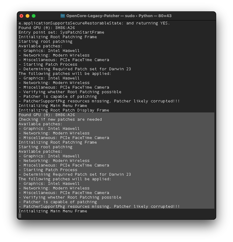

Hey everybody, I have Sonoma booted up and running on my MacBook Air 6,2, but I can't get it to post install root patch. I'm running OCLP 0.6.9 from the sonoma-development branch, but when I try to root patch I get stopped at: - PatcherSupportPkg resources missing, Patcher likely corrupted!!!
The whole terminal output is:

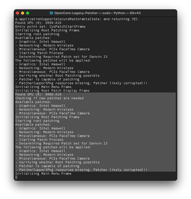

Solved my own problem. I tried to build the binary, it failed, but it downloaded some payloads.dmg file. After that was there I was able to root patch by running the app from python. I'm up and seemingly working fine on this old MacBook 6,2.
Can't help you, but I wanted to let you know how disappointed I am that you grabbed that user name before I did.
Ok, seriously. Have you tried using a prebuilt version of OCLP 0.6.9 sonoma-development instead of building yourself?
I fixed it, but I honestly didn't realize there was a pre-built for the sonoma branch. That would've definitely fixed it since it would've undoubtedly had that dmg file included. Are the pre-builts in some glaringly obvious location that my ADHD brain overlooked?

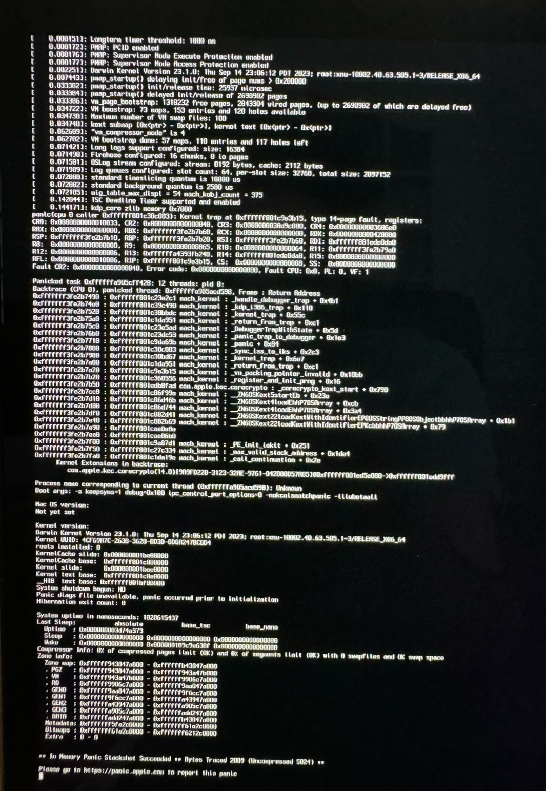

I updated to the new public beta, it booted normally, applied OpenCore patch (that I downloaded yesterday I think) and after restart it freezes after entering password on login display.
Any idea on how to boot into safe mode to apply the new version of the patch?
P.S: MacBookPro14,3 (2017 15” touchbar)
P.P.S: I tried booting from the USB from which I initially installed Sonoma to update it and revert the problematic files, as a solution I found for this same problem in a post about Ventura, but when I select the destination hard drive is says that the "volume cannot be downgraded". I don't have another Mac to create a new updated installation USB. I think it would be easy to just login somehow to try the last Open Core patcher... but how? I think safe mode doesn't work on open core (just hold shift and enter at the boot menu?) ?

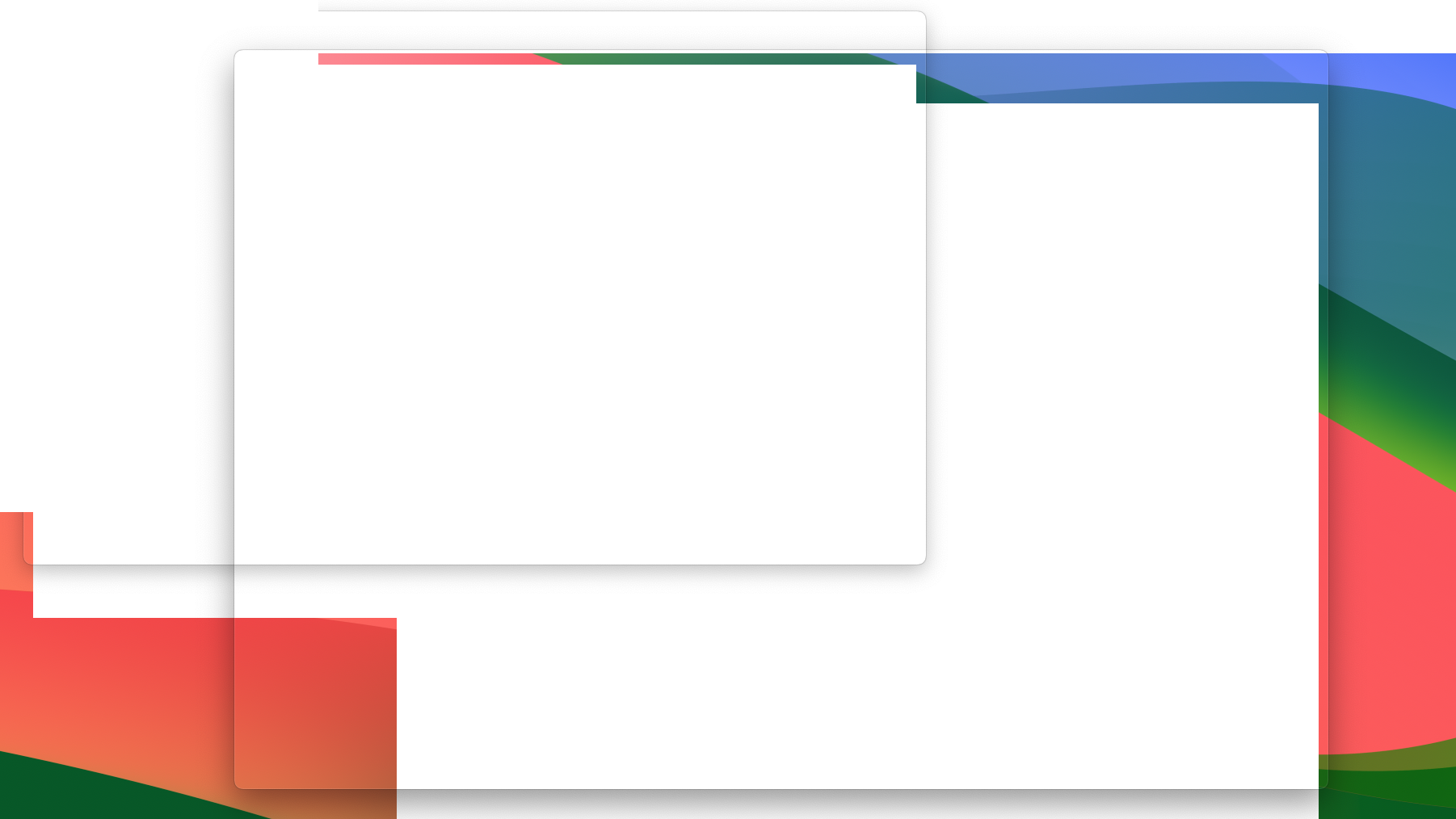

Hello, to inform
I've been testing Sonoma with 6,9 beta for 2 days. the speed is very good but I found 2 problems:
2 crashes of my screen (NVIDIA GeForce GT 640M 512 MB)
- impossible to use my IDE. the compiler/debugger don't work. ( correct on my M1).
Holding cmd s i got this screen after entering password (on login screen)
Reactions: jsl2000
