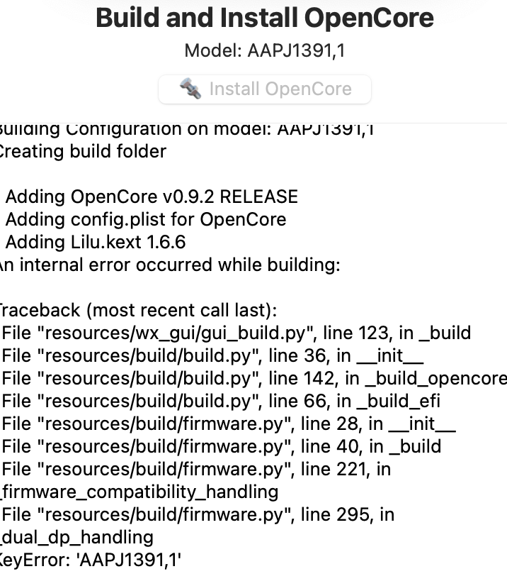

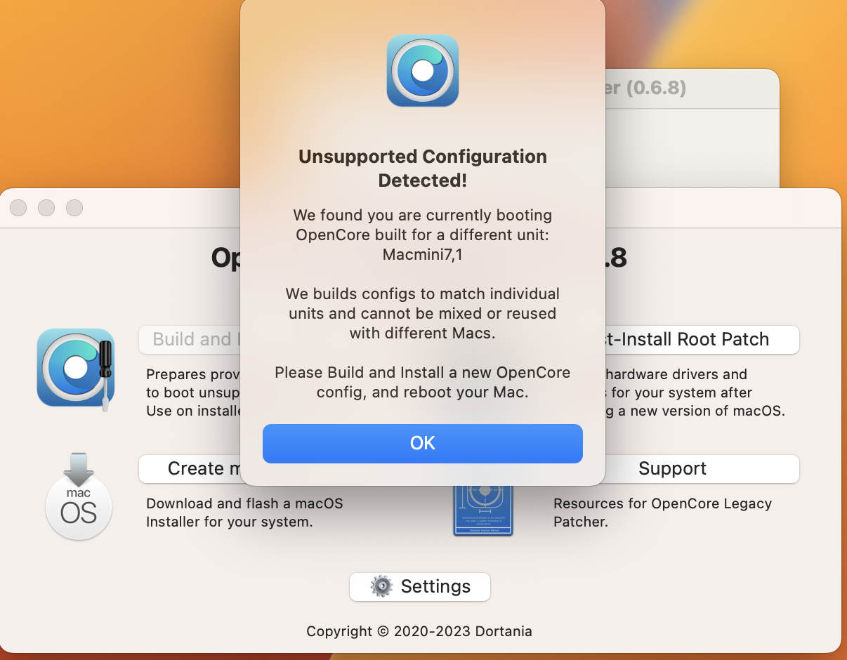

Hello,
Does anyone know if there is a way to change the model before doing the OpenCore build and install?
Thank you so much

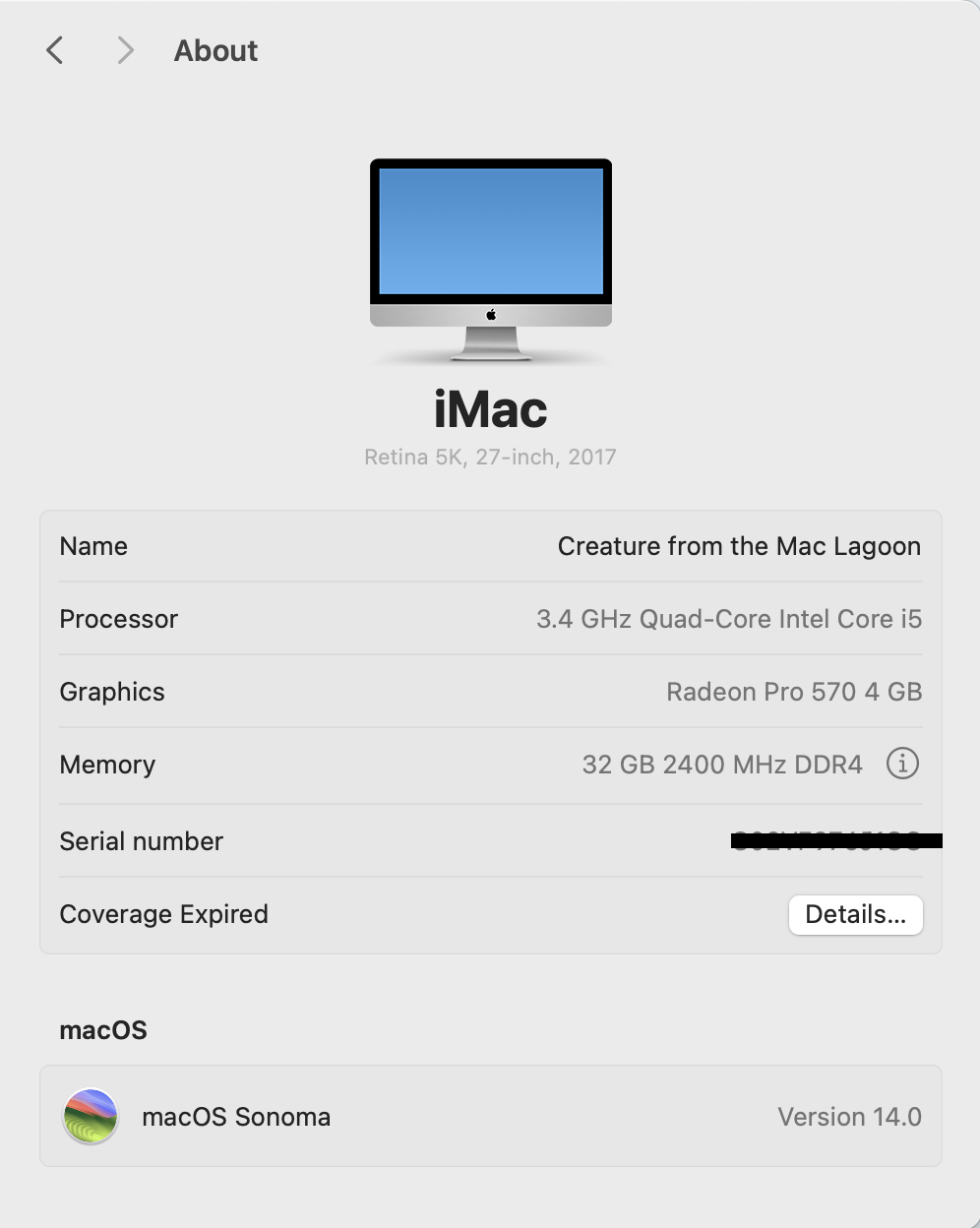

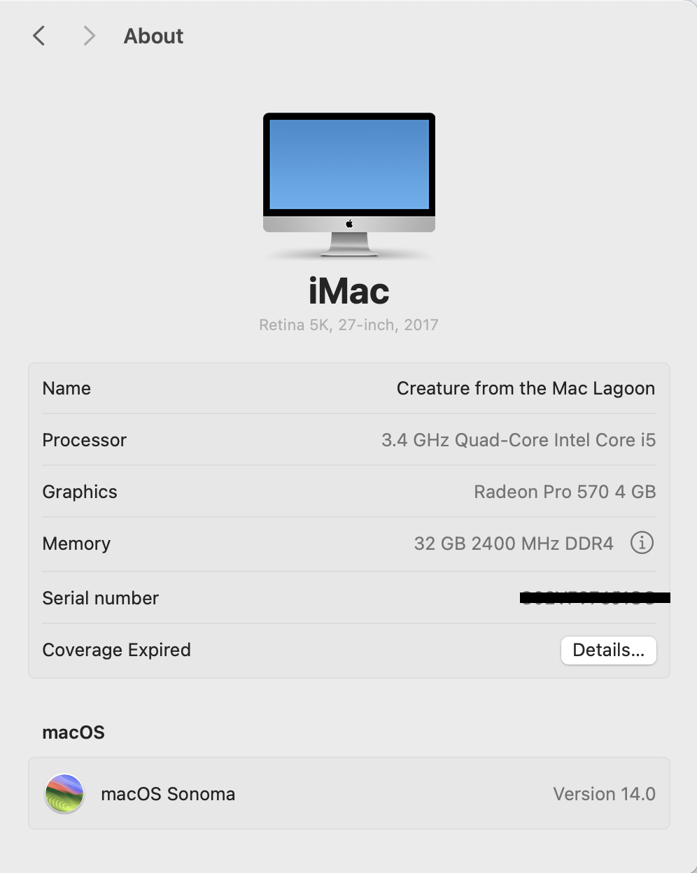

Hi all ! I've tried to install Sonoma 14.0 on my iMac 12,1 21,5". All is fine except bluetooth, can't find solution for that. Anyone have the problem?
reset PRAM and SMC and above all you have to use the latest OCLP 0.6.9n dated 28 sept and rebuild and install opencore if you haven't done so, with this latest version... it worked for me too with the same iMac just installed Sonoma (upgrade from 13.6) then it stopped working and now it works with latest OCLP

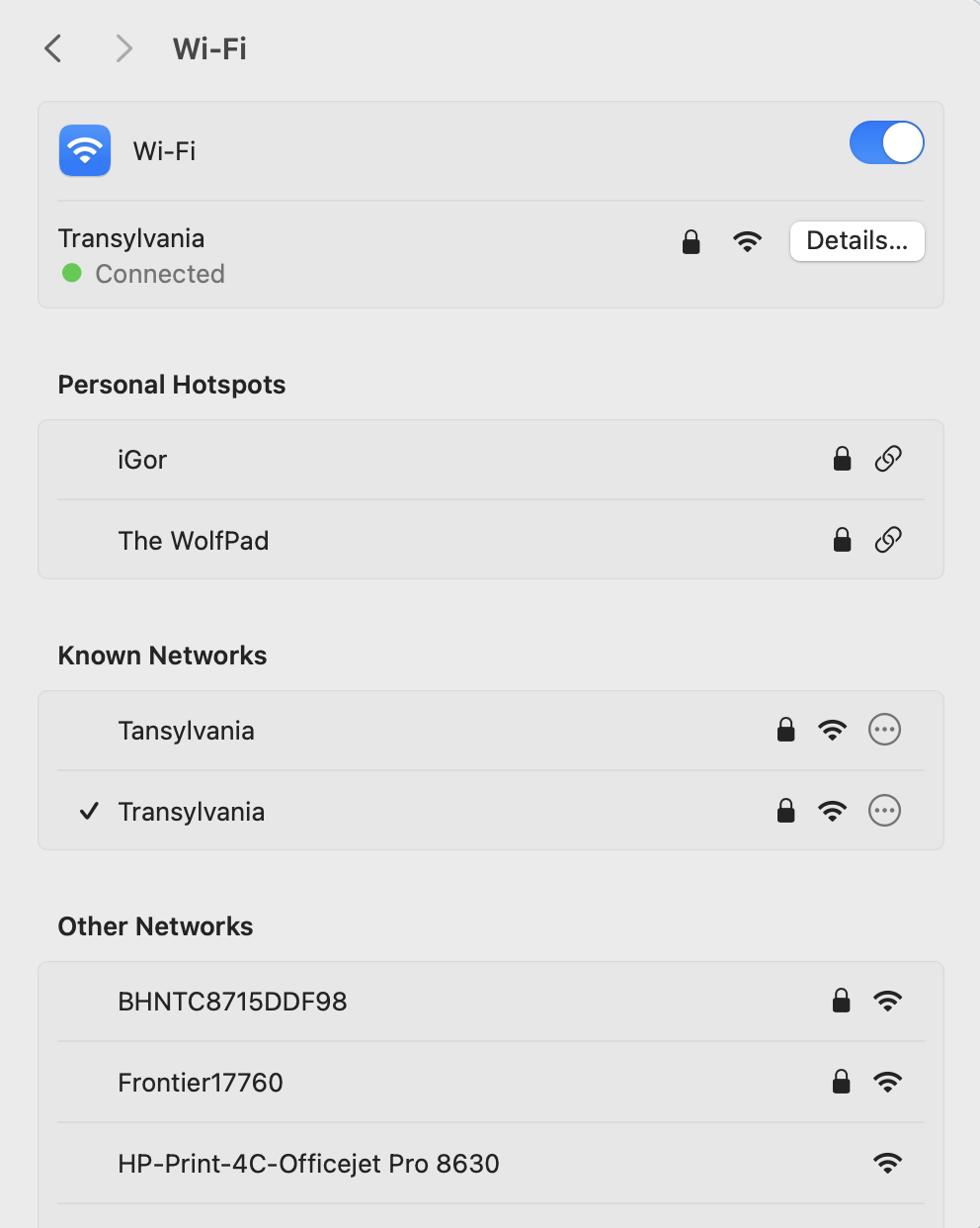

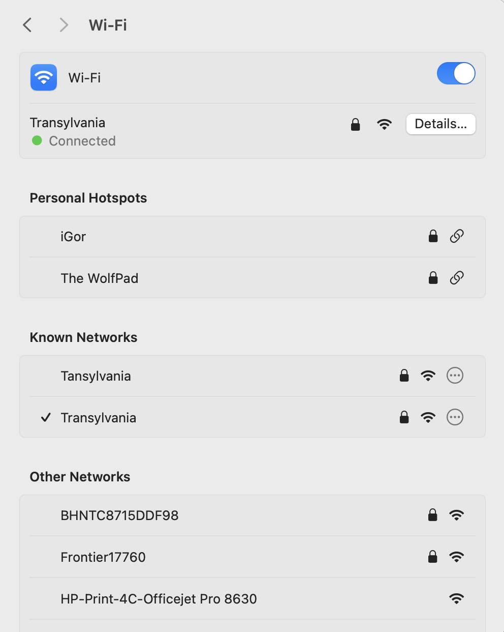

GOTEM! I had some sussy 3rd party kexts in /Library/Extensions/ that were interfering with the kernel cache rebuild. Looks like some ancient ZFS stuff I must've been trying to do years ago (specifically spl.kext and zfs.kext). Moved those out of that directory, re-ran the root patches, and blamo I have wifi.
Another weirdo issue I have now is that this machine refuses to show my desktop background no matter what I pick. I just get a solid gray background. Otherwise this appears to be working! Now to see if I can get my audio interface to be recognized since this iMac is my DAW...
Fixed my wallpaper issue by smoking the 2 desktop.* files in ~/Library/Application Support/Dock/ then logging out and back in. This system seems to be 100% good to go now! Thanks everybody for your help in debugging.

It's an option in the settings. Click settings and there's a drop down right at the top.
Thank you very much for the reply,
The problem is that I can't get to the settings button... when I start it, a window appears that tells me that I don't have the correct settings, then it goes to the build one, which fails because the model doesn't recognize it and back to home menu....
I don't know what to do... I can reinstall everything but I'd like to leave it as a last resort.
Thank you again.
