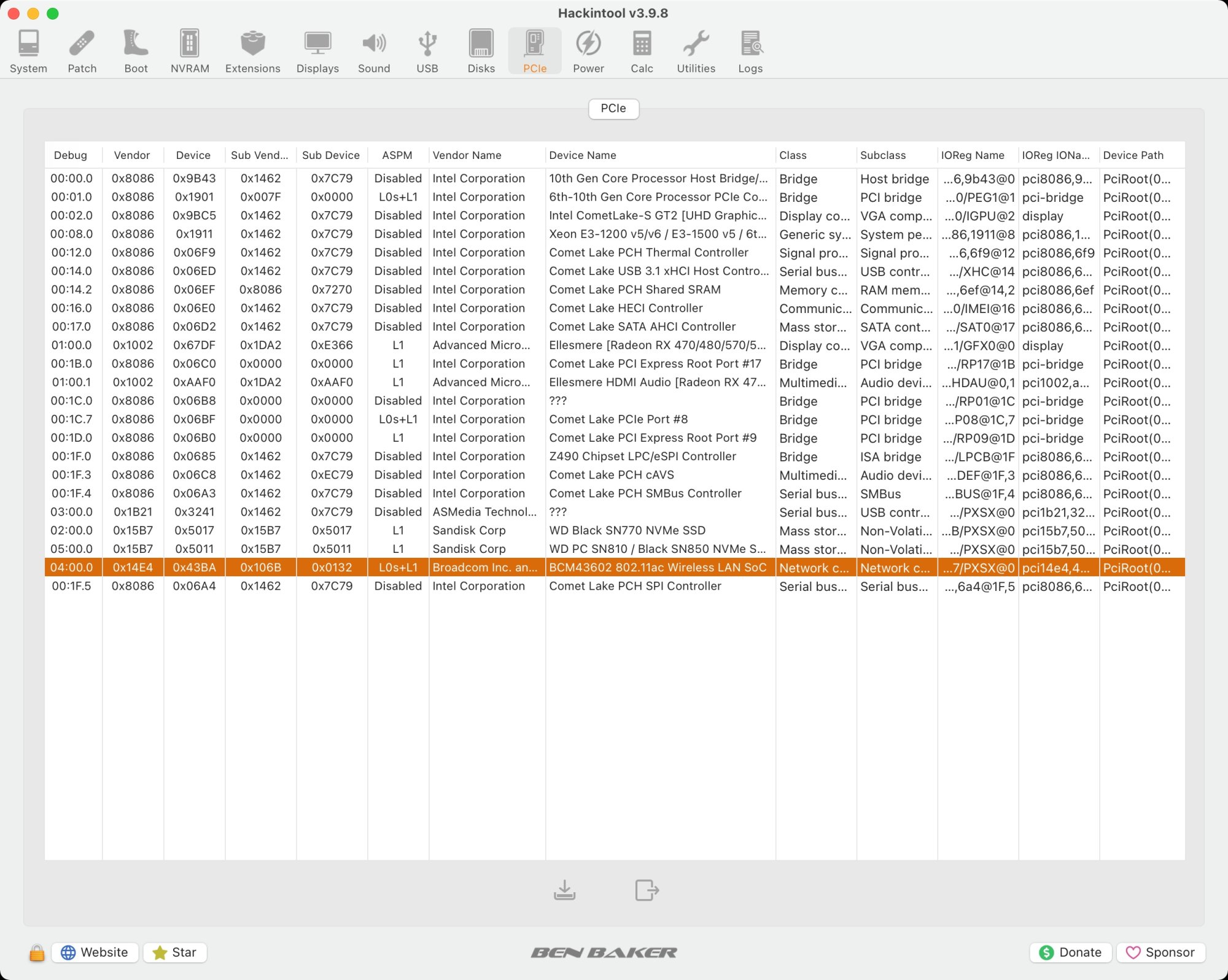

Running the latest version of Hackintool on macOS Sonoma, I can see that the OpenCore Legacy Patcher installer has installed version 0.9.3, and we already have version 0.9.5.
Checking the OpenCore loaded kernel extensions we get four: AirportBrcmFixup being responsible for patching the IO80211FamilyLegacy.kext extension, and we also have LiLu, FeatureUnlock and RestrictEvents.
All hardware is perfectly recognized, and in particular both the Wi-Fi and Bluetooth adapters are recognized and working in macOS Sonoma, as you can see in System Settings > Network
And this is the table with all the PCI devices for a 2017 iMac 4K

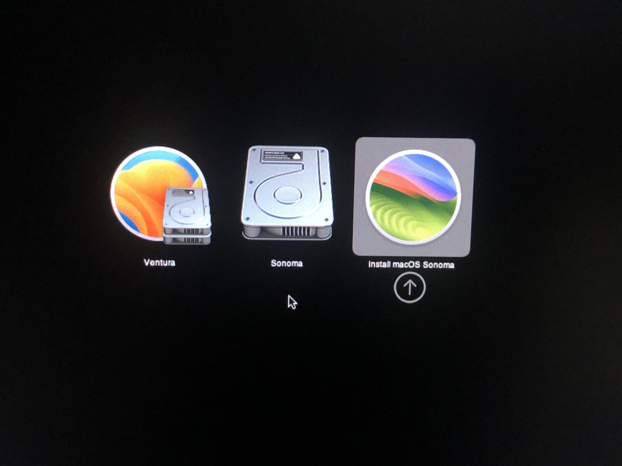

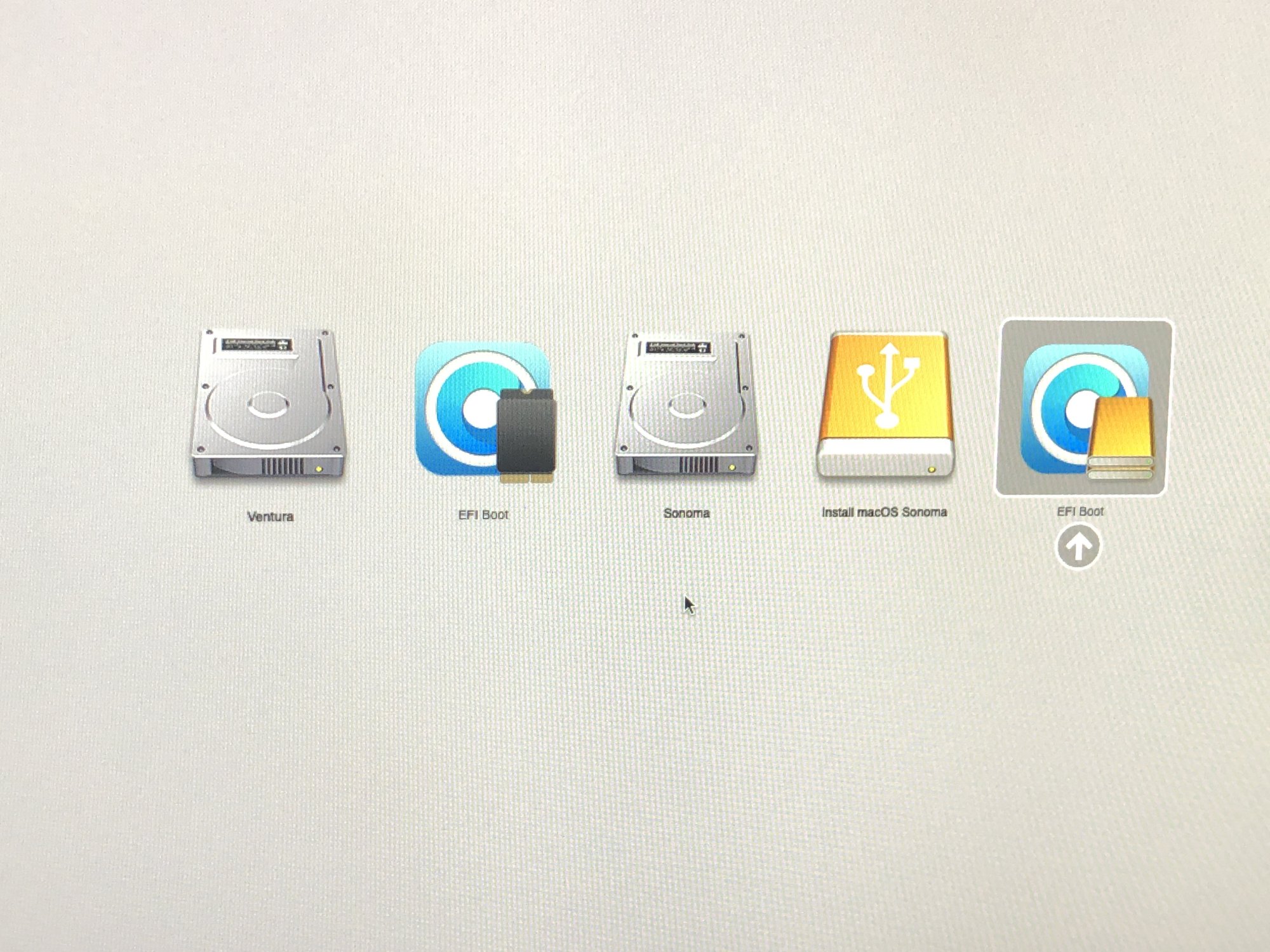

You must press the Option key to get the Apple boot manager to select the boot drive and select the EFI Boot that will open the OpenCore bootloader.
And there you go, now installing macOS Sonoma is not banned anymore.

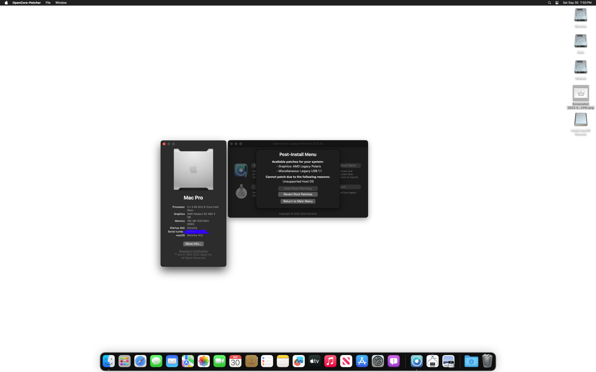

The installation itself was successful without any problems, so nice, but it seems that the root patch is not supported now.
so close!
