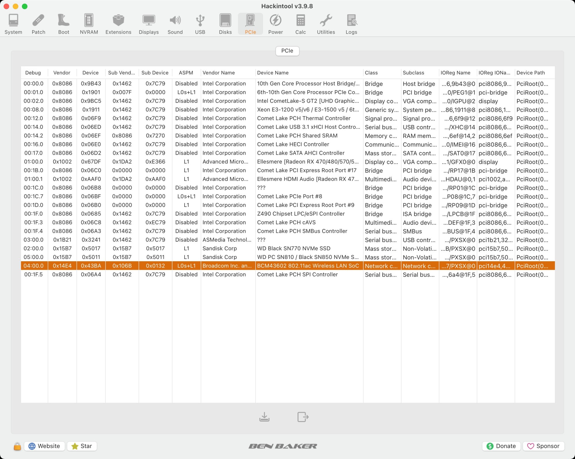

My Wifi card reports 3602 with 4.2 BT, which seems to be the same as in the 4k 2017.

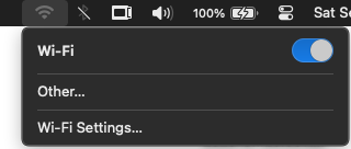

Thanks! I will test my hack's BCM94352HMB again (without root patches) and report back.
EDIT: That was a quick test without surprises. I have a test volume on my MBP6,2 with 14.1 installed (no root patches). In the test volume, I initially installed 14.0 Release (directly from Apple), applied 0.6.9 root patches, and then upgraded to 14.1 Beta (which required the full installer via OTA for my non-metal Mac). After booting the upgraded 14.1, I did NOT re-apply post-install patches.

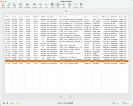

No surprises, no Wi-Fi. Wi-Fi appears to turn on, but it will never find available networks. That's the behavior when the Brcm Wi-Fi framework is missing from Sonoma.
try -brcmfxbeta
I also have the BCM94352HMB but not in a realmac ...;-) have first still patched with OPLC then I used in boot arg still additionally the -brcmfxbeta. As Kext I have the 2.1.8 AirportBrcmFixup.kext and AirportBrcmFixup.kext/Contents/PlugIns/AirPortBrcmNIC_Injector.kext additionally activated. My wifi works. I also had WiFi before without this boot arg but it did not detect any networks. Bluetooth I got by additional Kexte to run.
Reactions: deeveedee
try -brcmfxbeta
I also have the BCM94352HMB however not in a realmac ...;-) I have in boot arg additionally used the -brcmfxbeta. As Kext I have the 2.1.8 AirportBrcmFixup.kext and AirportBrcmFixup.kext/Contents/PlugIns/AirPortBrcmNIC_Injector.kext additionally activated. My wifi is running. I also had WiFi before without this boot arg but it did not detect any networks. Bluetooth I got by additional Kexte to run.
Yup - it's in there. We were just confirming that BCM94352HMB needs OCLP 0.6.9 post-install patches to operate in Sonoma. Works great!
