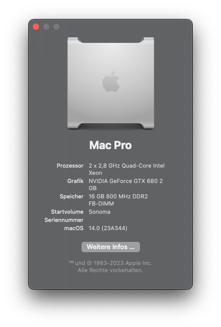

Just a small SSD test drive in one of the drive bays of the Mac Pro. Works great so far! 👍
