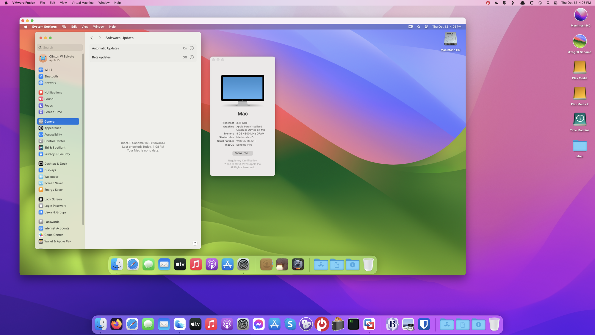

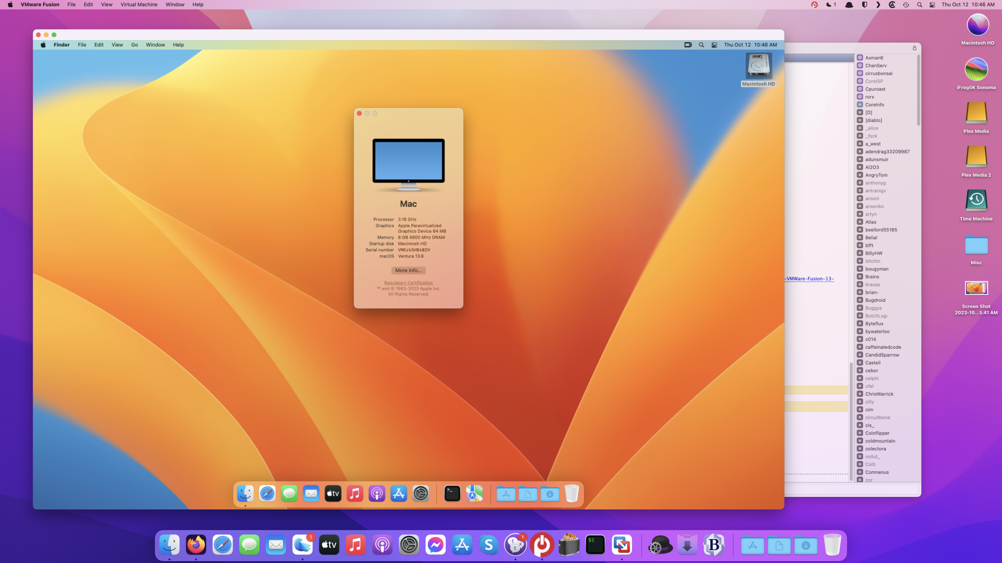

I just wanted to add, that if speed is a concern, to anyone who tries this, save the VM to an SSD and run it that way. That should get rid of most disk i / o lag. Also on quad core machines the VM will be limited to 2 cores. If you have more than that, you will be limited to half your physical cores so 8 core will give you 4 cores for the VM, and so on. So as I said, judge speed by that. As I mentioned above, the main lag seems to come in the for of no 3D acceleration by default for macOS guests. Older versions such as Mojave and below, aren't too bad, maybe even catalina . But Big Sur and above, you do want the AppleGPU if you have a supported host.

Don't try to play Disney+ content from Safari in a VM either. While it has 3D acceleration enabled it hard crashed the VM, so DRM might work, but not from Disney, so some things may be hit or miss like they are with OCLP. The only difference is, the VM method is Apple supported.
@deeveedee : Just so I can answer your question from above, I'm doing an OTA upgrade to Sonoma in the Ventura VM as I would on a supported Mac, just to see what happens, and so I can give you at least a partial answer about running it in a VM apposed to OCLP. If it goes bad, no harm done I'll just create a fresh VM with Ventrua.

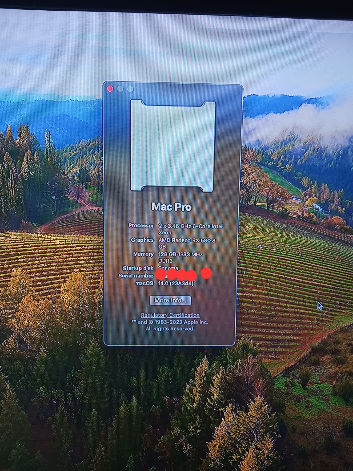

I'd like to report that macos sonoma on a mac pro 5,1 runs well with the exception (so far) that the calculator gives me "not a number"..needs further testing but that it so far.
Also im shocked and surprised that protools 2023.6 works along with my uad2 pcie, fabfilter, waves, plugin alliance, ssl native, oek soothe 2, native instruments and softtube plugins(this was a shocker) but none of the websites for those 3rd party apps state they work. today im a 😁 camper. no more upgrades for a year for me...View attachment 2288883
