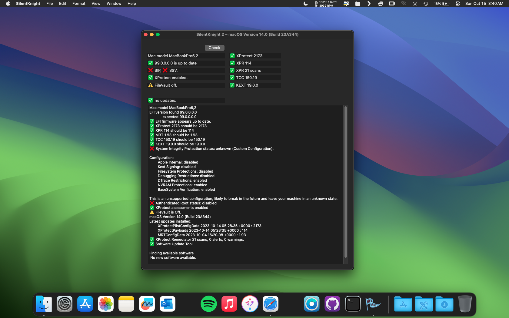

This is a fresh install, and what I use works. For the most part it runs pretty flawless on my machine.
Idle standby / screensaver and or sleep causes black screen when resuming. Entering password brings me home like normal. It does cause WindowServer to error and throw a report in the DiagnosticReports folder.
The occasional login window error adds to that DiagnosticReports folder as well.
Thank you devs, keep up the outstanding work 👍
